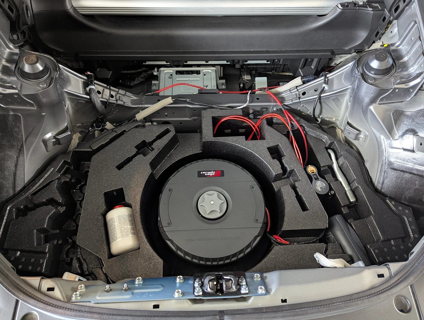

I don’t have a recommendation on an amp replacement (just went with powered Cerwin Vega), but I did use an adapter from OWC to just tap the factory harness and not cut any wires. Made install a breeze.

The Cerwin Vega drops right in. The adapter makes the audio signal plug and play. You’ll still need to run power from your battery.

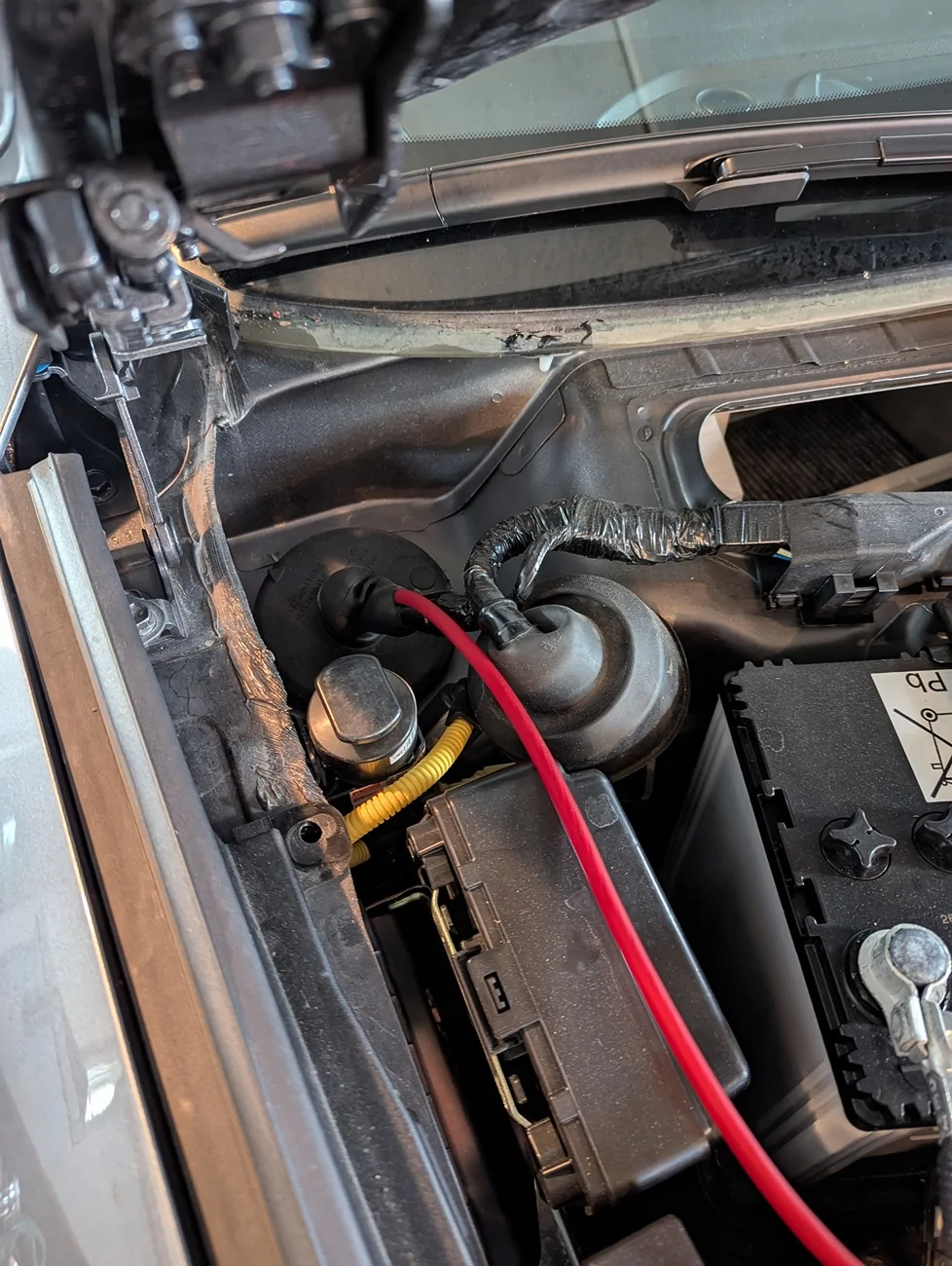

I have an OWC harness on the way. Im going to add a JBL powered sub. Can someone who has ran power up front advise me the best way and location to get the power thru the firewall? I have a 24 Nismo, do I have the fake sound as well. I was really surprised when I heard about this...seems a bit lame to me.

I am yet to buy an amp for the passive Cerwin Vega spare tire sub, but today I swapped it for the BOSE anyway. I cut the OEM harness to the BOSE and soldered it to the CV harness to see if the OEM amp could power the 11" CV spare tire sub. Probably, to nobody's surprise, I can report that you will want an aftermarket amp. However, the factory system definitely sounds better and with the volume maxed (40) you definitely get more bass as compared to the BOSE. I was worried about clipping but there weren't any issues. Just swapping the BOSE for a passive spare tire subwoofer has been an improvement but I will be buying an amp next week.

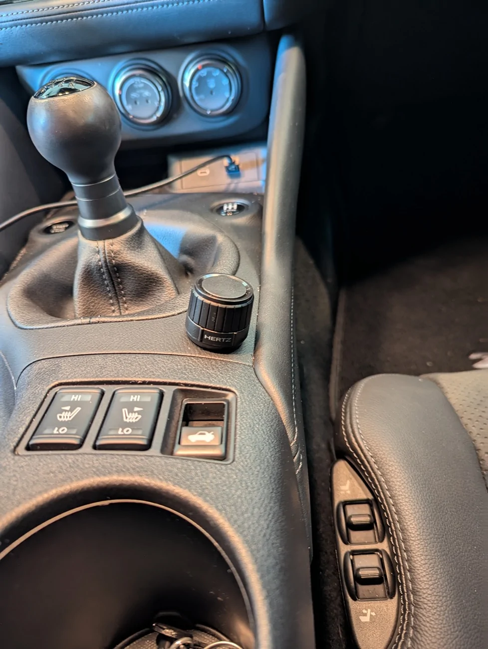

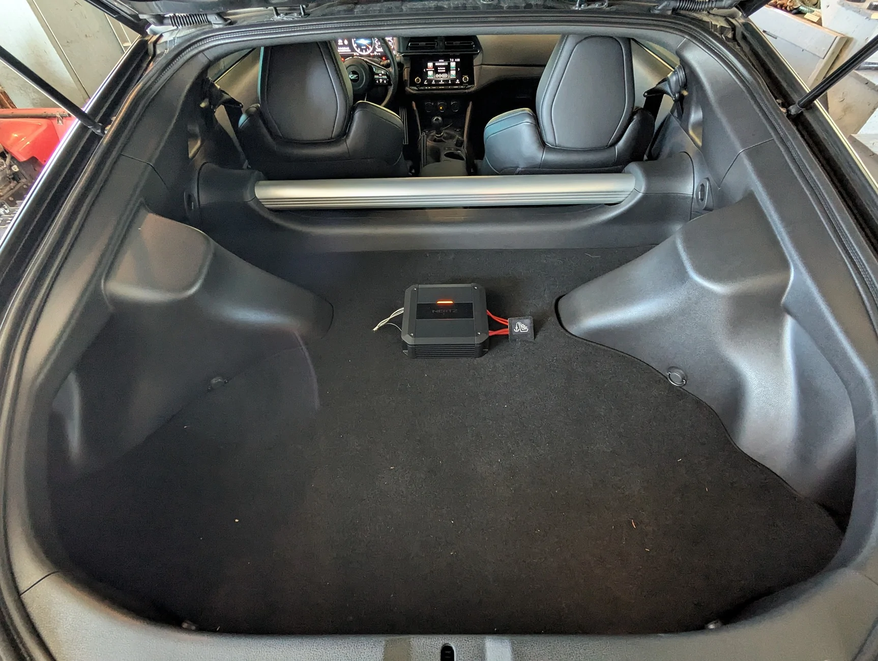

After another two weeks I'm back with an update to bring this to a conclusion. I purchased the Hertz DP 1.500 amp as well as the optional bass control knob and did a quick install today. I'm pretty happy with the bass from an 11" spare tire subwoofer and would definitely recommend this setup. It's a far cry from some of the systems I had over a decade ago (dual ported 15s) but it's lightyears ahead of the OEM Bose.
Running the power is pretty easy but does involve removing a lot of the interior trim on the passenger side. Once I'm happy with the tune, I'll eventually relocate the amp so it's completely hidden. The location I chose for the bass knob (behind the shifter) admittedly looks a bit funny but it's super convenient to have it under hand while driving.

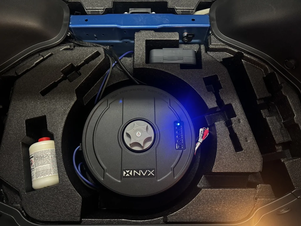

I purchased my 24 Performance 2 weeks ago and couldn't stand the anemic Bose system any longer. Added this yesterday and ended up keeping the other Bose speakers in place. I had ordered NVX 6X9 door speakers, 2.75" MB Quart and NVX 3.5" speakers for rear, but after A/B, I think the Bose amp and system should stay together. The 2.75" dash speakers lacked mids compared to the Bose. The rears are absolutely worthless to replace regardless. Decided to leave the doors alone since they seem to be paired with the dash speakers and are lower impedance. I also used the NVX amp kit and ran the amp wire back to the sub down the passenger side. Cut the Bose speaker plug off and crimped the high level input harness for the NVX. Red +/Green- is one side, White+/Black-. The Bose is passive which is likely why it's so bad. 1000% improvement in sound. I adjusted the Treble to 2 clicks below max and I'm happy with it now. The NVX has level, sub and band cross over with a remote that I tucked up next to the driver seat for on the fly adjustment until it's set. I added to some of the sound deadening from the factory. The lower floor at the rear could use some. It's very resonant when tapping it. I did snap off one of the clips for the middle rear trim piece. It did not want to come up and ended up putting a crack (frustrating), but can't really see it. It lifts straight up, but pull the rear trunk like housing out first.

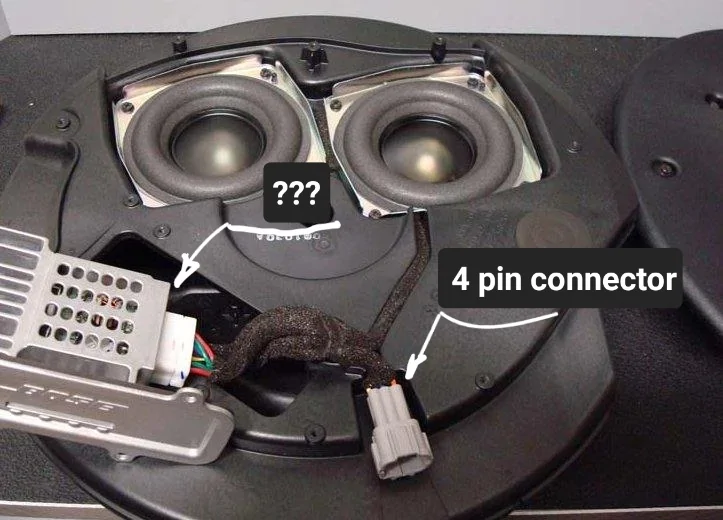

I stand corrected from my previous misinformed post. The original Bose subwoofer is passive, connected only to four (4) signal wires. Therefore, there is a need to bring battery power to any replacement active sub woofer.
From that attached picture, borrowed from another post, what is the item pointed by the arrow?

The Bose spare tire sub as supplied in the 370Z was not passive. What you point to with the ??? is the Bose sub Amp Model 297172-003P It’s 70W @ 1 ohm. The 2 speakers are 2 ohm, and I suspect in parallel to get 1 ohm.
There are discussions about the Bose sub on 370z, Infinity G37 owners sites and also on Reddit car AV forums. 370Z and Infinity owners have been dealing with these crappy Bose spare tire subwoofers for at least 15yrs. I replaced mine in a 2010 370Z.
Here is the site for the pic you asked about:
https://www.whatsinside.info/bose-nissan-370z-subwoofer/
I think these are the correct harness functions for the 370Z Bose Sub - the wire colors have changed for the passive sub on the RZ34:
OR 12v+
BLACK Power Gnd
BLUE Accessory
Yellow SP+
Purple Sp-
I have checked mine & It appears Nissan has run the 4” speakers in the Subwoofer passively. (My mistake if anyone reding this post thought I said otherwise).
Obviously run a 10A fused 12v power directly from the battery (or suitable tap) and find a decent chassis ground for installing ANY aftermarket Sub or Amp.
