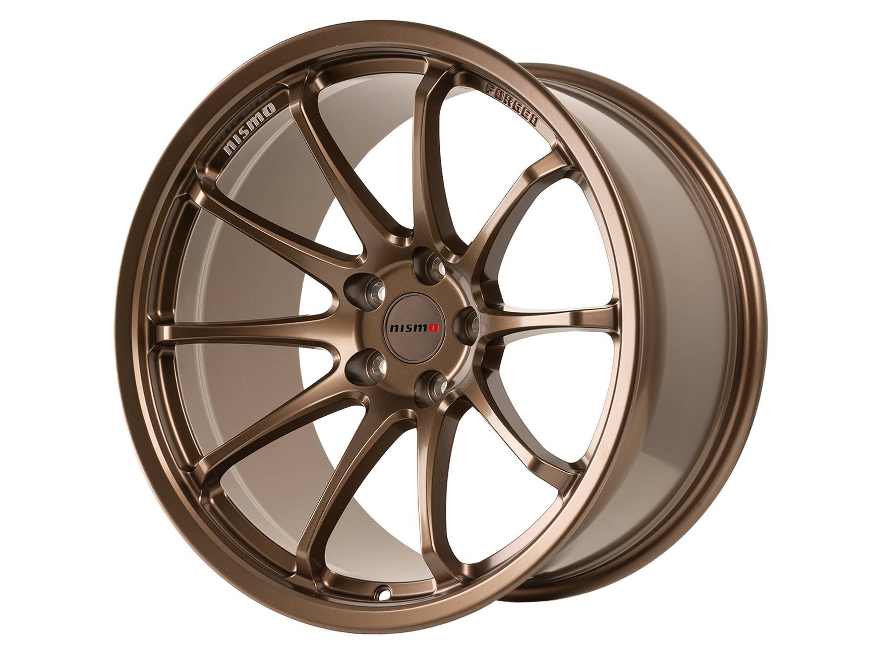

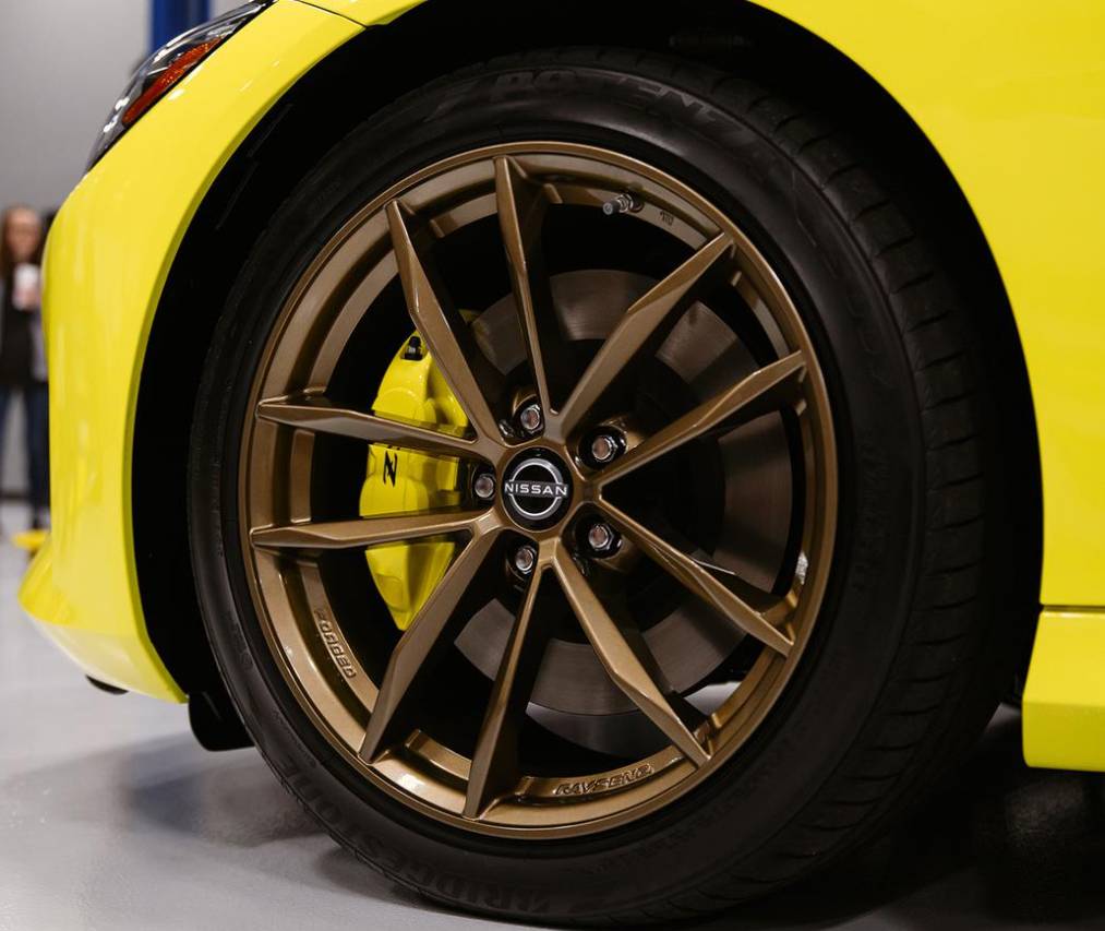

I like the Nissan Nismo bronze rims a lot. If it’s the Proto rims you’re fixated on… I think they would look better on a White Z than they did on Yellow. But kinda too expensive.
I like Enki TSR-X which look similar in Bronze. A set of 4 is way cheaper than what the Rays would cost: Enki TSR-X
I linked to a 20” square setup with 9.5” width and +40 offset.
But if I ran these, I’d probably try to spec a staggered setup, like on the Z Nismo:
Front - 19x10 +33
Tires 255/40 R19 (Also be 255/35 R19)
Rear - 19x10.5 +23
Tires 285/35 R19 (Maybe up to 305/35 R19)
Downside is you can’t rotate tires like on a square setup. So there is that.
Fitment Industries are worth checking out for any wheel. They work with you to get exactly the wheel & fit you want.
