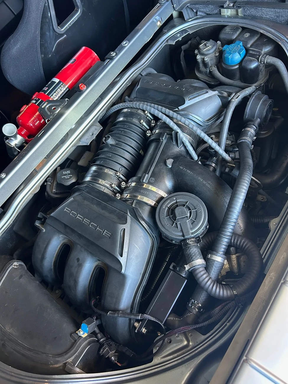

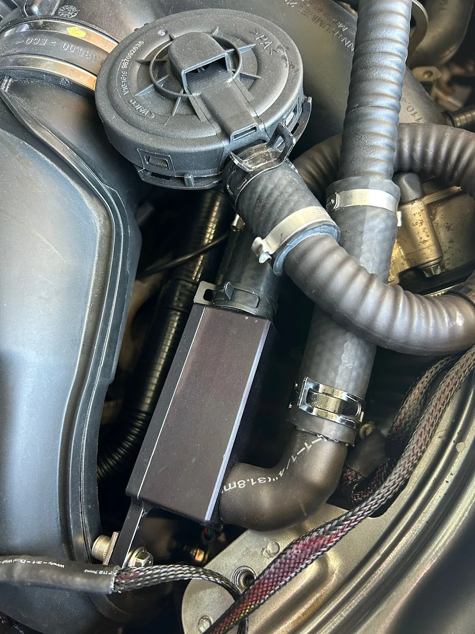

They sure are technically Air Oil Separators. I installed the high capacity aftermarket UAOS which I drain after each track day from my Cayman S, 3-4 oz typical collected.
