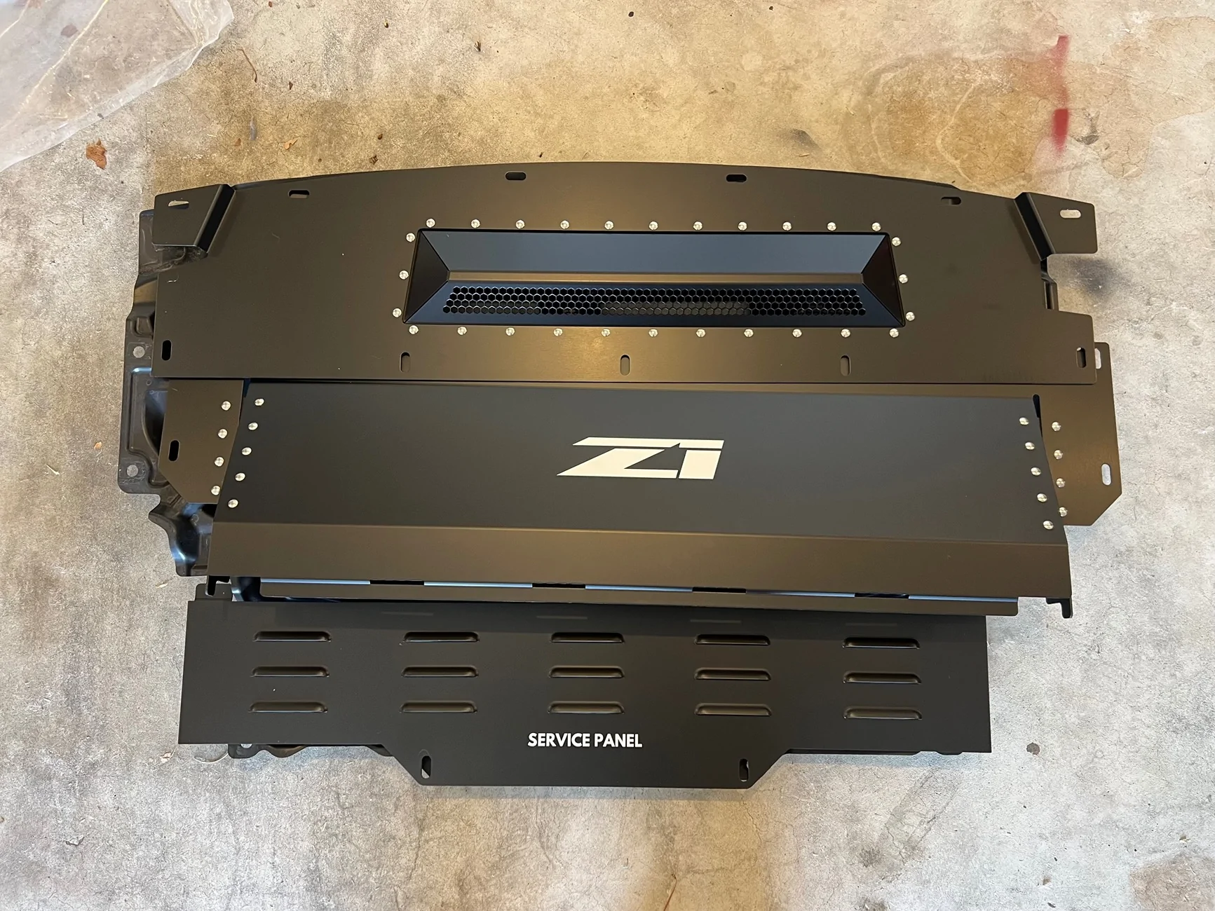

I have the Z1, it's 3 pieces, front, middle and service panel. Service panel is accessed with just two bolts for oil changes, it so easy and I'm very pleased with it. You do have to drill out 3 holes and use a rivet tool for one of the pieces which is not difficult but some don't want to drill on their new vehicle.
That being said....
If I was to do it again I would get the Mishi, because it's one piece with a two bolt service panel and it uses the factory undercover bolt pattern to attach, no fitting no drilling. That makes it a winner in my book. I'm new to Z's and did not know Mishimoto existed when I got my Z.

I'm happy with the Z1. Not to nit-pick but just wanted to clarify for people who don't know, you are not drilling new holes, you are making 3 existing holes a tad bigger with a drill bit. The rivet tool that comes with it is easy to use though.
My biggest complaint with the Z1 shroud is the honeycomb pattern vent underneath. Leaves come in the front grill and get stuck in there, it's annoying.
I agree if I had to do it again I would have got the Mishimoto one but I don't dislike the Z1 one enough to replace it.

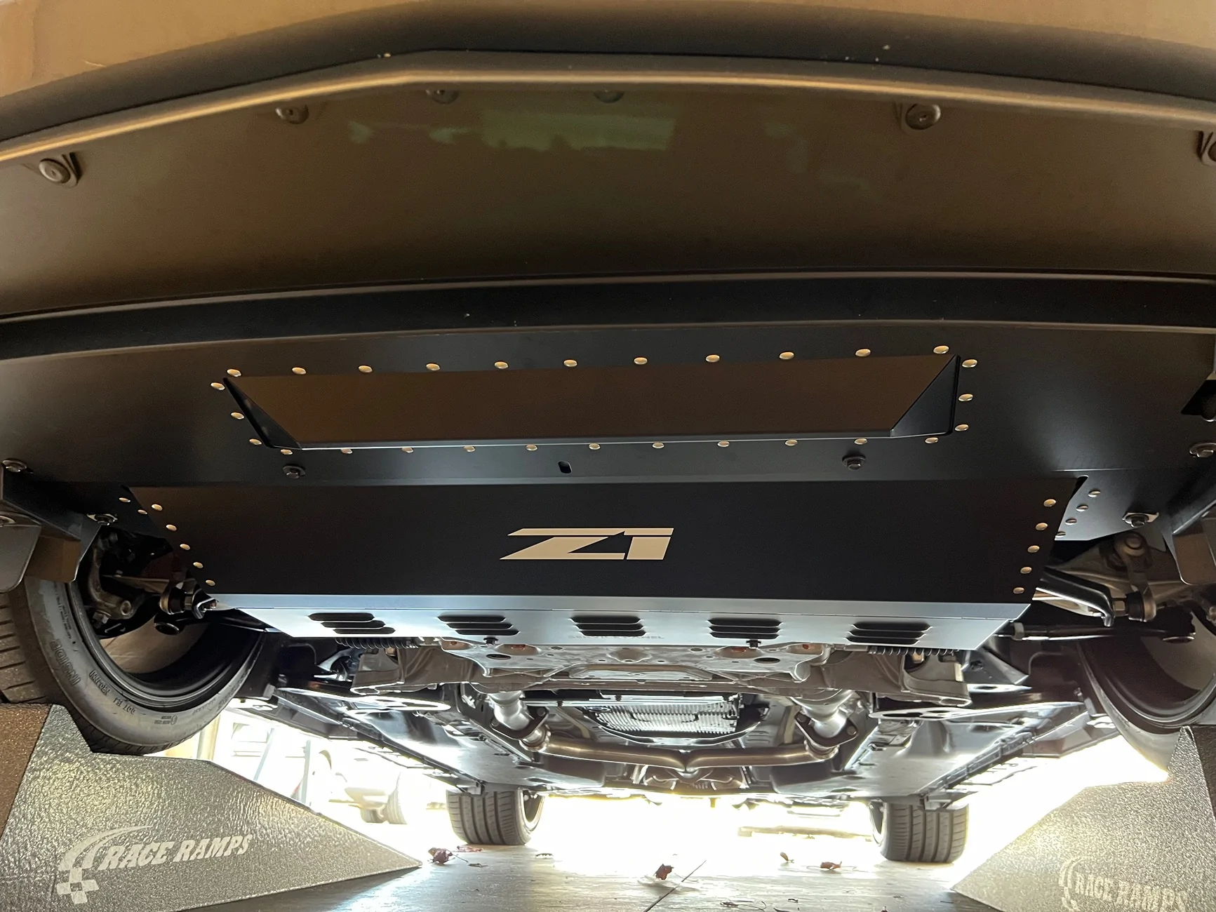

I use race ramps and a floor jack to raise the driver side slightly higher for better drain.
My other thought is to place the ramps on front and rear tires to raise the driver side only or just use a couple of floor jacks.
Now i‘m thinking i may buy another set of race ramps that are a couple of inches taller and use the shorter ones on the passenger side. Or maybe just go shade tree style and find a slope in the driveway. Or go old school and find a ditch. lol.
anyone known where i can find low profile jack stands to use with the low profile race ramps?

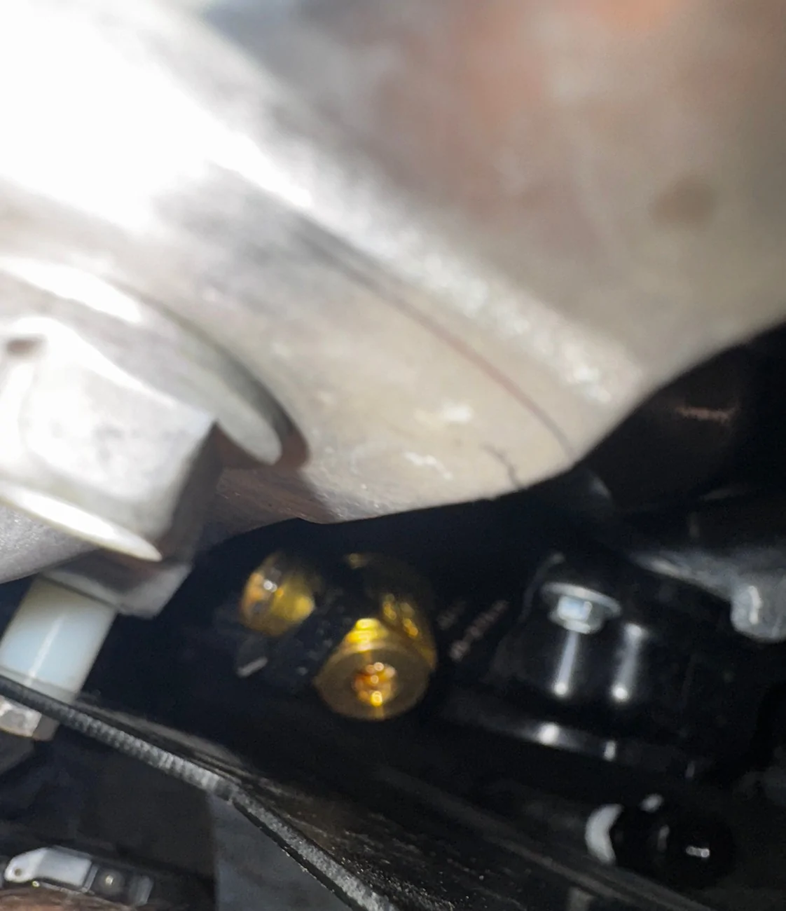

This is cool, I haven’t seen these before. I haven’t been under the car yet to see the angle of the drain. Do you regret not getting one of the options with the nipple for even easier draining? Any concerns with clearance with those options?
Here's a pic of mine installed with the Z1 under shroud.
