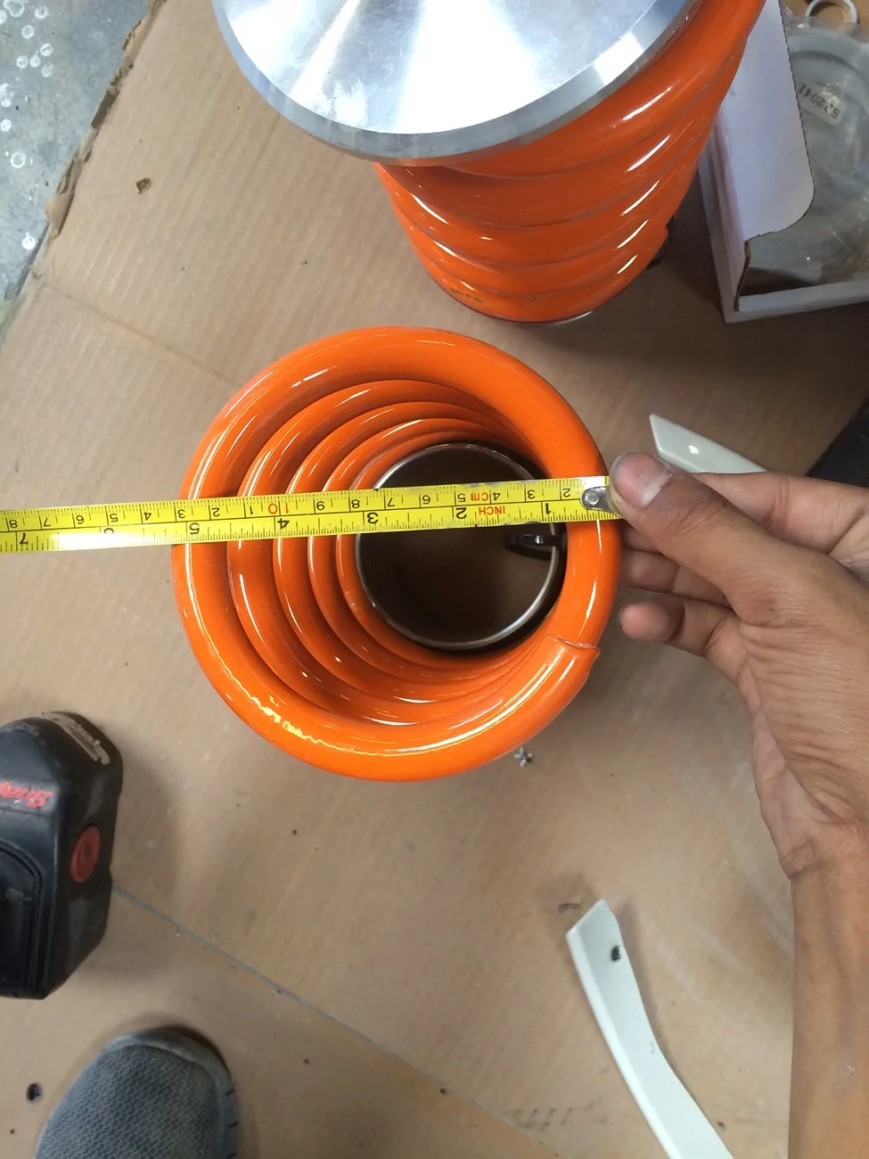

Get all the arms, they affect each other, mostly under load. The only drawback is cost and changing the diameter of a divorced spring. 60MM OD is a common size, you can get the same rate you otherwise would have. SakeBomb can get it for you from Swift, Hyperco, or Eibach.

My kit will have Swifts. Will that be 60mm, or would that be a special request?

Only your retailer will be able to tell you what size spring they've decided to use for your kit. Ohlins Japan uses OE size springs so I will be keeping my spring bucket.

if they’re divorced and being assembled for a custom app it should be easy to provide the requested diameter

I agree; these details should have been apparent at the point of purchase. If they're truly a bespoke application, then I have a feeling they would select a more readily available industry standard spring size versus having something wound up to OE specifications.

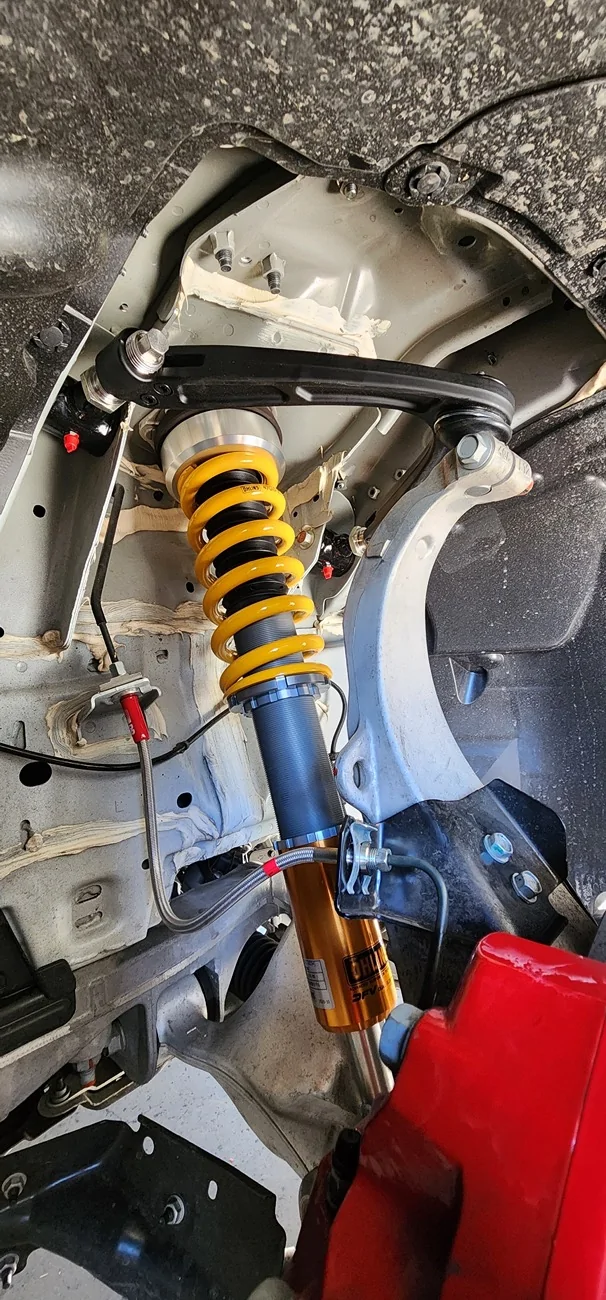

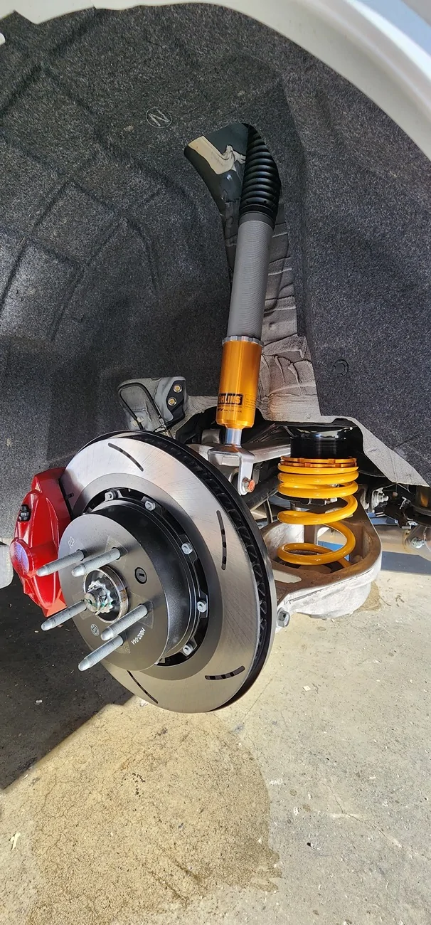

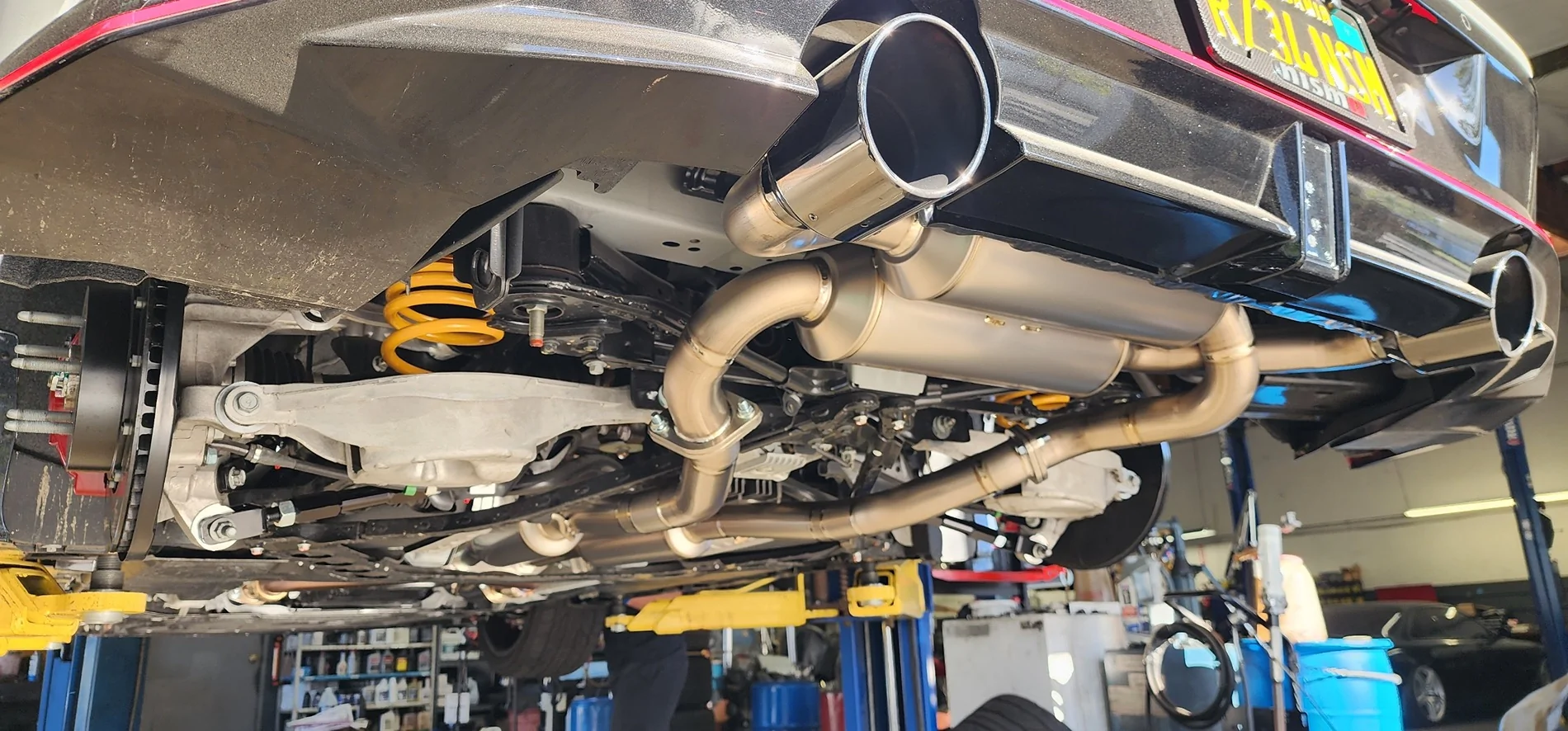

With these coilovers I feel like I just bought a car with an MT and dont know how to drive a stick (although that I DO know). Coils should arrive soon. Nick, I think, at Sakebomb said they were ready this weekend. Have an abdominal surgery coming up and I’m not going to be able to get them installed before that, and probably a couple of months before I can wrench on my car, so I’ve got some time to plan and buy crap I need. Also planning to get some thrust bearings if they don’t have them already. Looking at QA1 bearings from Summit. Look like the exact same ones you can get from McMaster. 2.5” ID and about 1/8” thick with the bearing and a washer/race on each side, but a little cheaper from Summit. assume the best placement for the fronts is on top of the main spring and below the helper.

how do you adjust the rear? Remote extenders?
