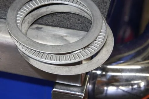

- this is a a bigger point maybe - does their setup have thrust BEARINGS or thrust washers
Here's a small detour:
Across multiple platforms (S-chassis, SXE chassis, z-chassis), i inevitably read about peoples coilovers making a "popping" or "creaking" sound
This is from the spring rotating under compression and grinding against the metal perch it sits on. Cheap coilovers do not account for this metal on metal friction which creates noise.
The solutions are relatively simple. You can use a thrust WASHER (just a coupla appropriately sized washers in metal or plastic) that reduce friction and make for a smoother rotation) or a thrust BEARING (lots of little rollers to help rotation), or a built in rotating bearing in the coilover itself
Sakebomb and Ohlins knows what they are. Just make sure you're getting them in that setup so you dont getting any wierd noises. It doesn't really affect performance. Its a livability thing.

Do not know the thrust washer/bearing situation. These would sit between the spring and top lock collar, so the base of the spring can spin under compression and rebound?

washers on bottom or bearing on top from my experience but I don’t think it matters

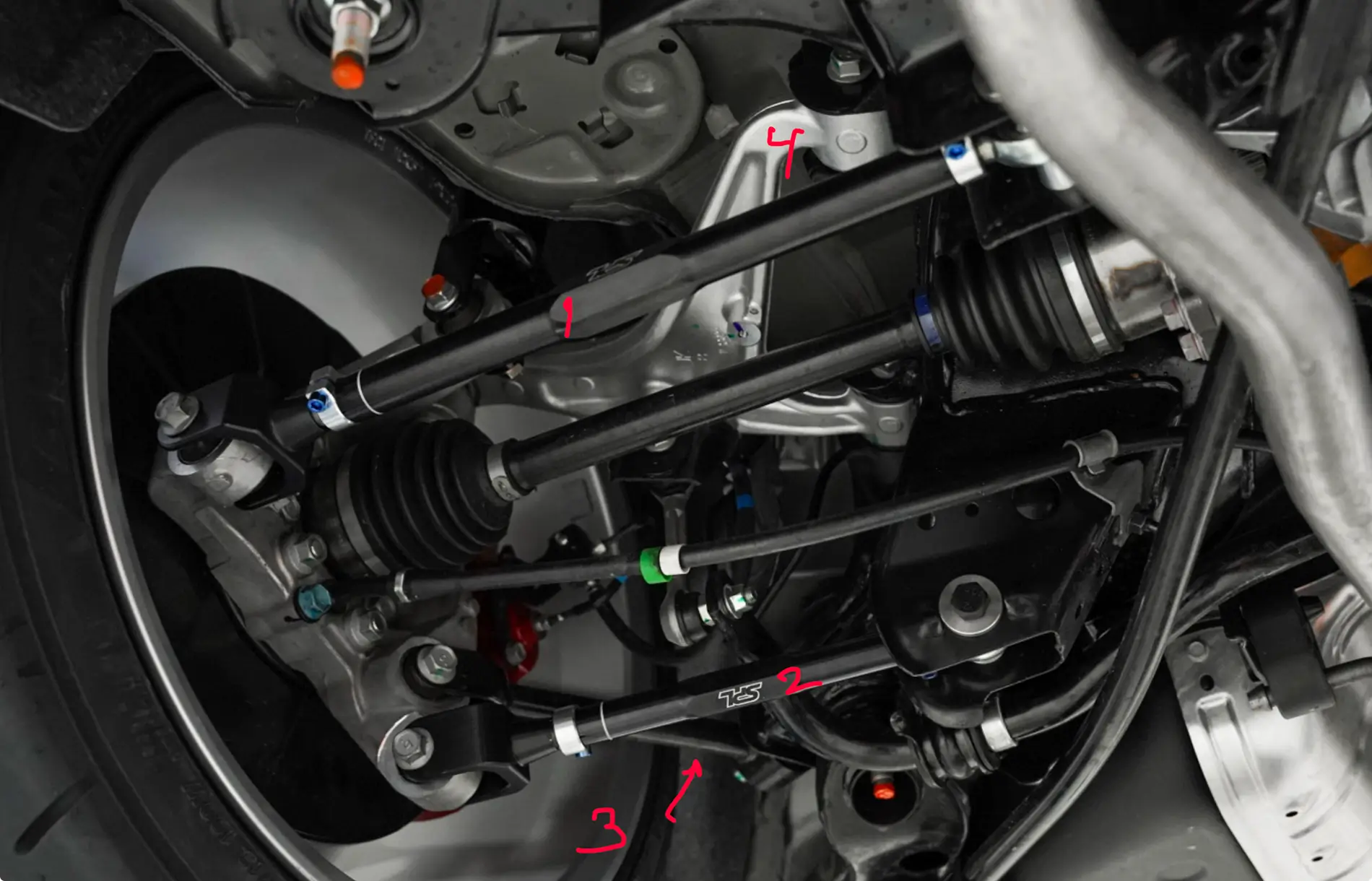

Need some guidance.
Decided not to leave the rear completely stock with the Ohlins install. Mine are being built divorced.
Please correct/expand/explain where necessary.
#1 - Toe link (?)
- Used only with a true rear setup.
- For divorced need toe arm, rear bucket, some call mid-link, that holds the bottom of the spring.
- For rear buckets (etc…) the diameter of the spring seat is something to consider.
- Best to install the toe eccentric lockout when changing to adjustable arms/links.
#2 - Camber link (?)
- Same function as a camber arm, but arms are typically billet or forged where links are typically dog bone style. Is there a noticeable (“worthwhile”) reason to get arms over links?
- I believe there is some OEM rear camber adjustment. Is there an eccentric bolt/hardware that needs to be added with this arm/link?
Not sure about #3 and #4. Suspect #3 is the traction link/arm. Also unsure of the criticality of changing either or both of these out.

You'll only need #2 (camber arm) & #3 (traction arm) for a divorced setup.
Using the term "link" is generally only used to describe the whole system as a "multi-link suspension". Individual "links" are referred to as arms. There is no correlation with the individual part's method of construction.
The purpose of adding an eccentric bolt elimination kit when swapping to an adjustable arm is simply to remove what will be a redundant area of adjustment and lock it out to prevent slippage.

Assuming I leave the mid-link (spring bucket) stock, toe is adjusted with the bucket eccentric?...and/or the traction arm? Not sure how the traction arm plays in...something about bump steer, which I think is toe-related.
Alignment pro's know what's needed, but I'd like to know for my own benefit. Searching isn't answering my questions. Or it does, then the next thing I read contradicts some of it.
