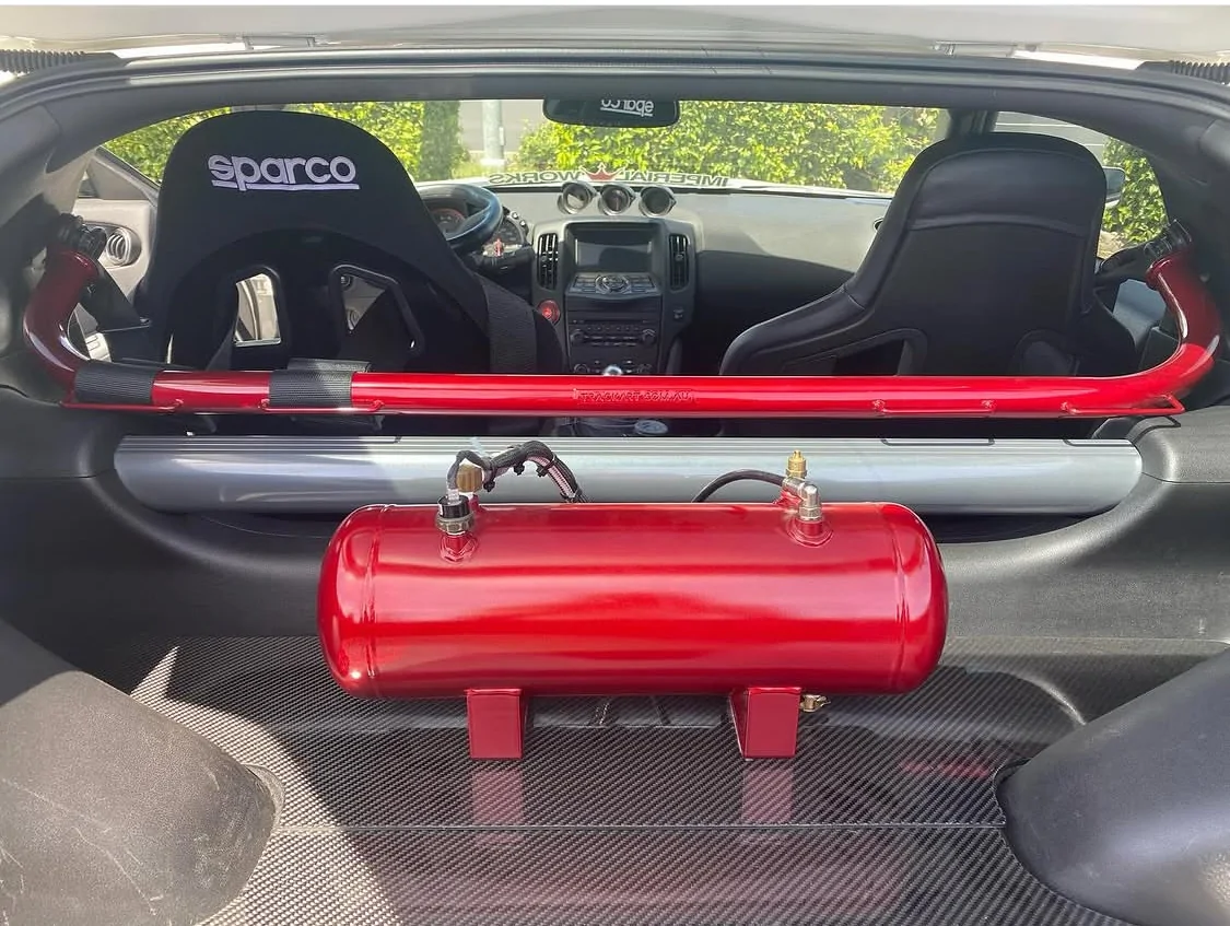

In retrospect, I would have picked my own tank, as the one supplied by them is pretty ugly. You can see it here:

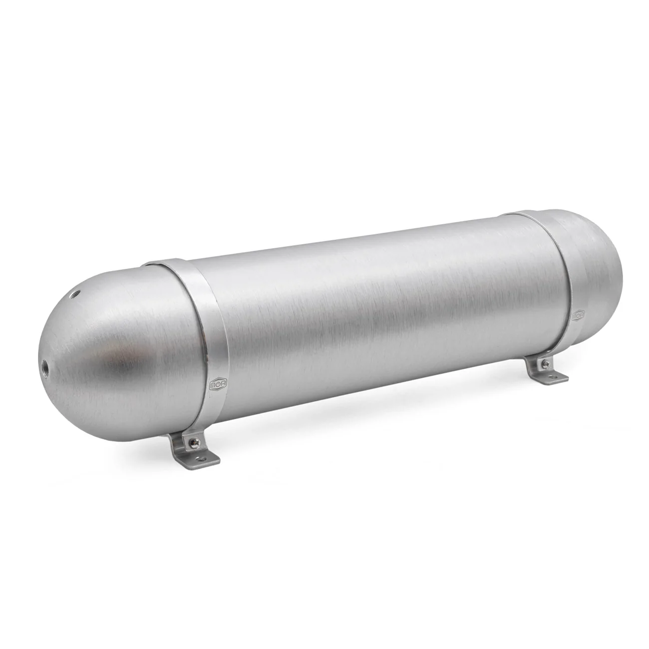

All the wiring and lines goes on top. This is probably fine if you mount your tank hidden, underneath the trunk "floor" (that requires removing the spare tire for room). Above the floor, it looks like an eyesore. There are now "seamless" tanks that hide the fittings on the end and have no ugly welds.

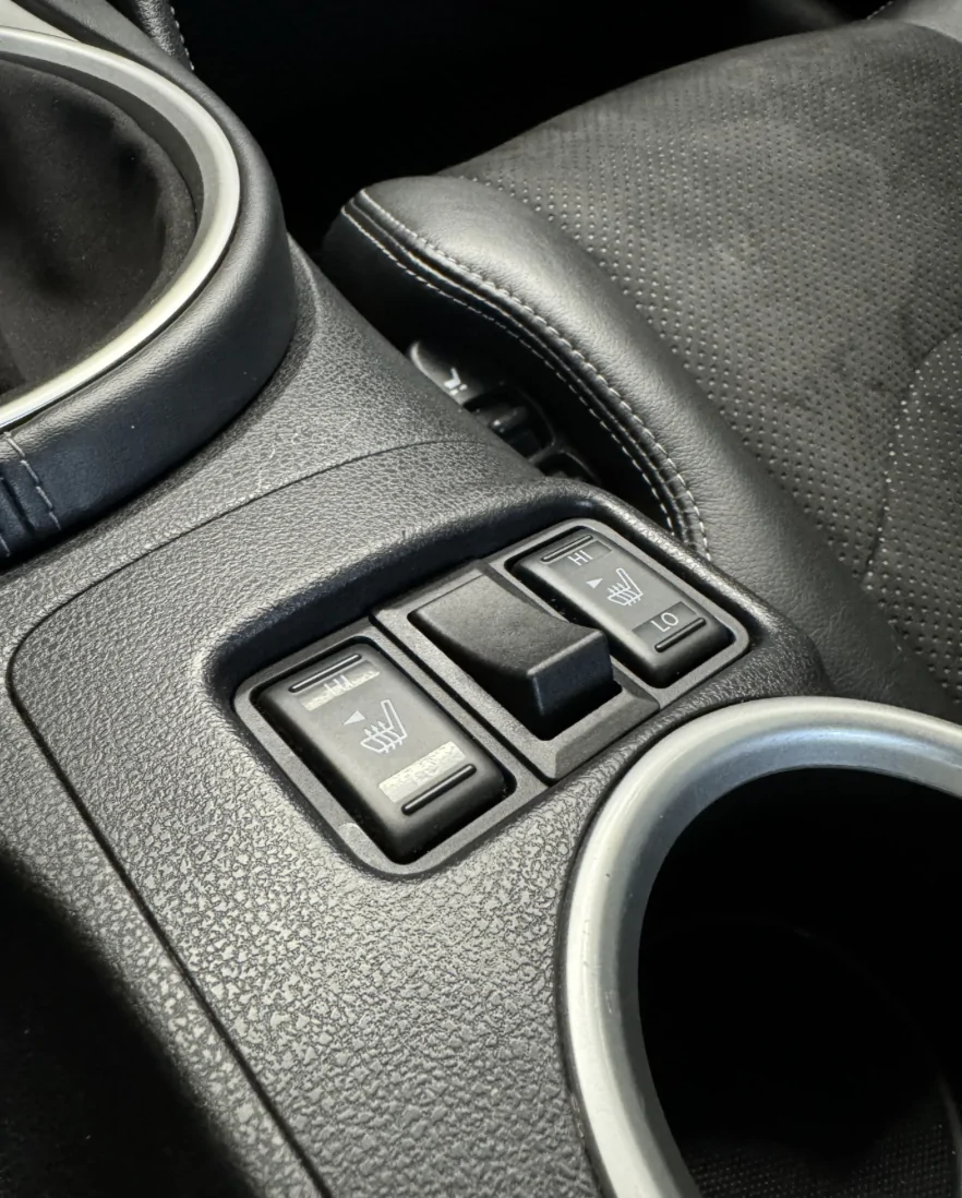

The Z center console has space for switches just below the shifter. On my Z34, there were 3 blank spots (i think one is used as a trunk release for later models) I'll take a pic later

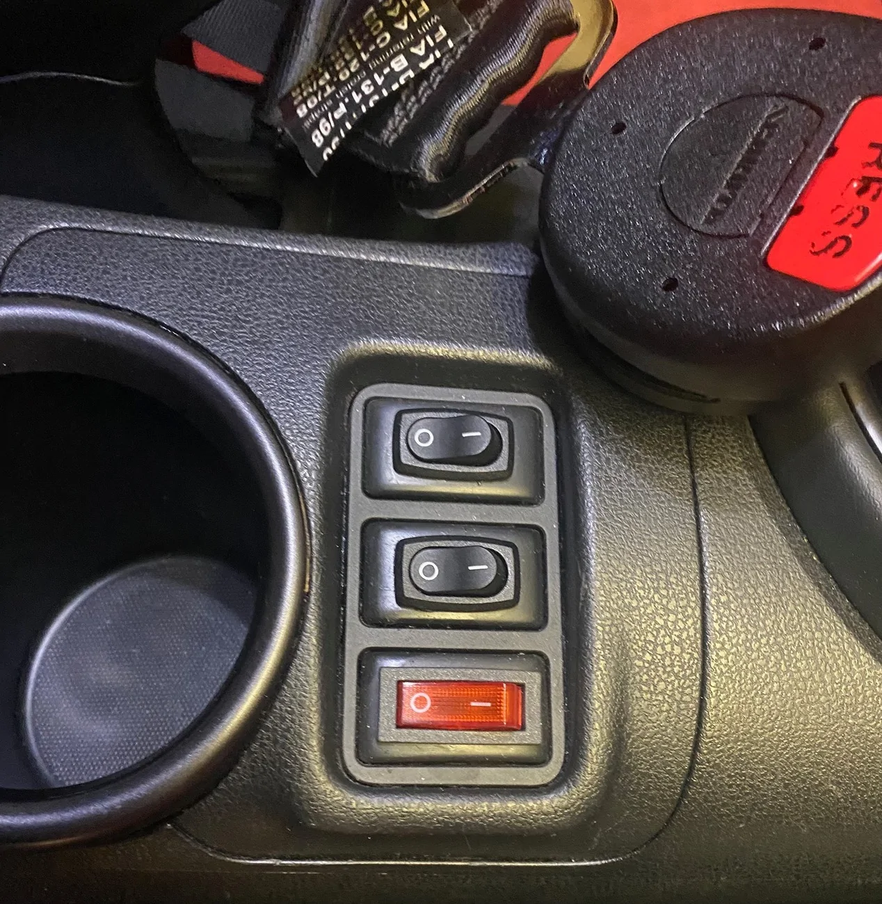

for Z-specific install, you can get OEM switches for the center console:
I think this is the part
https://parts.nissanusa.com/parts/nissan-switch-255001ea0a
or use universal switches like mine
