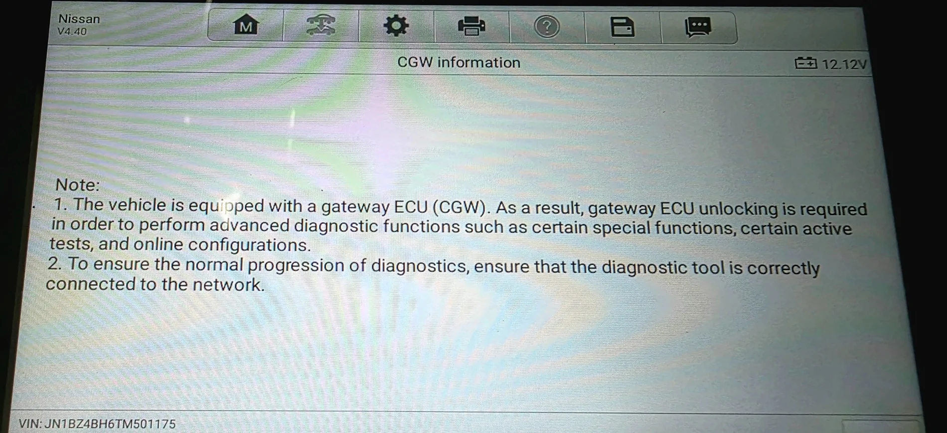

Just be aware my 2026 require another subscription on my autel to AutoOath for some gateway thing, worked fine after that
Yeah, that's a "downside" to a diagnostic tablet vs. a code scanner, but $125/yr is far cheaper than the cost for a new scanner to get to everything that's "new."

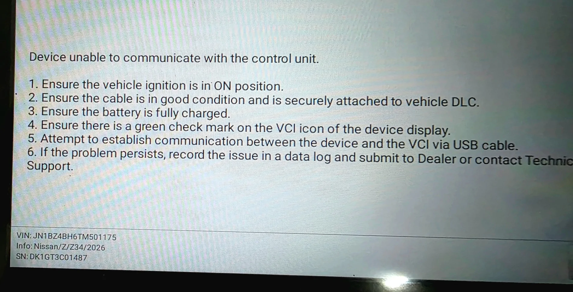

didn't work for me, said screens and done o_O

can you elaborate? What model of scanner? What year is your Z? What happened that didn’t work?
I updated App, firmware, downloaded Nissan updates which added 2026 year Z (was 2023-2025). 2026 Z, Autel MK808s. I'll try again this morning & will post error screen i get when trying to turn ANC/ASC off..

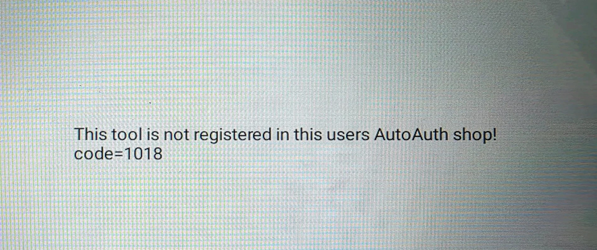

Ah I think it does have to do with Auto Auth subscription, or registering the device. I didn't not opt for a year subscription, thought a year was included with the device. And while I thought I registered the serial successfully with Auto Auth, I seem to be in a loop of inability to unlock the gateway, tried again this morning. I'm old and not the sharpest crayon in the box, but working with this device has been extremely frustrating, an hour to register, more to update, and now a yearly subscription is required for functionality it appears. Thank you though, maybe useful for smarter folks or those who will use it enough to justify $ 125 annual.

No worries! I think we found the culprit! Very annoying to have to pay another $125, but probably worthwhile to not pay the dealer and experiment with your own settings.

I think it is because the 2026 and 2027 models are not available by default and only accessible after performing an update that requires a subscription. I could be wrong (don't have the device yet), but that is how it seems.
