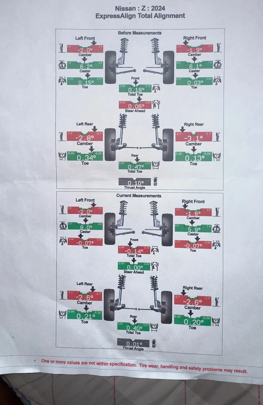

The car looks awesome! I actually like the looks of slotted over drilled. Did you have to get any other hardware to get your car in spec with regards to the alignment? If I remember, I think you have lowering springs.
I needed nothing for my alignment and yes I’m on Eibach springs. This is the alignment after springs.
