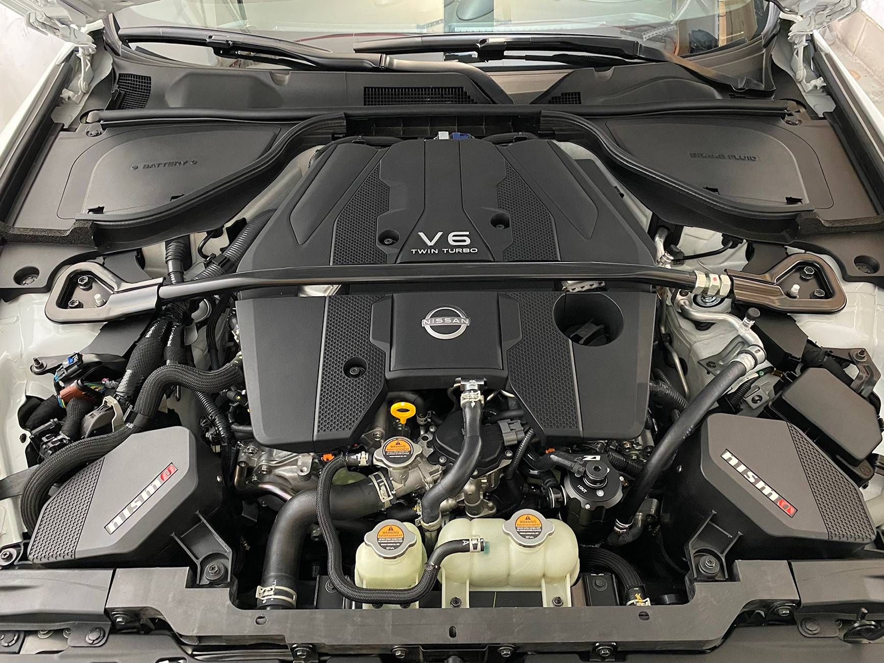

This is 100% why I went with the Nismo design. It was between that and the Boosted 6 setup. I LOVE the sound of it but I couldn't get past the heatsoak.
Time has proven time and time again that sealed designs work better. Dyno tests with an open hood and 4 industrial fans pointed at the engine bay don't mirror real world results.
I'm running the Nismo intakes myself. Yeah I wish they had more induction noise but its better than the factory airbox, and an open filter design was a no for me.
The secondary elephant in the room is the air to water system being pretty inefficient; thermal runaway is a question of when as opposed to if. Greddy's air to air kit is on my list eventually if I decide to address it.

Literally just price and the NISMO brand. $499 w/ free shipping was a solid deal for the NISMO. I ordered it direct from a Nissan dealer and it shipped within 12 hours.
With that said, I do think the style of the AMS setup is awesome.

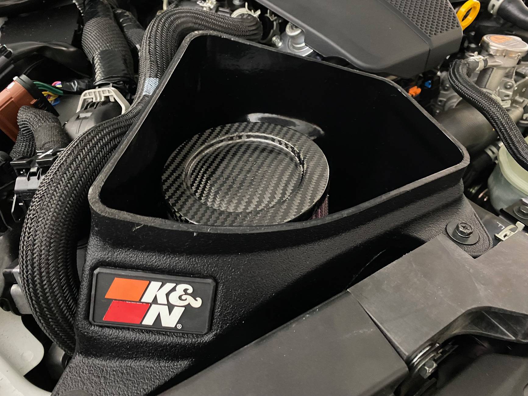

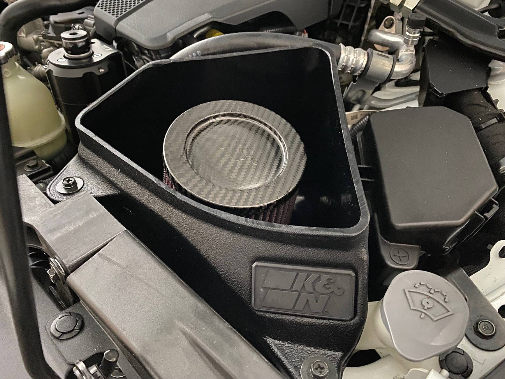

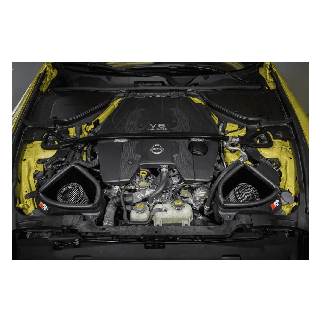

The hood sits on top of the k and n which makes it sealed. Nice design and can hear the sounds a lot. Only flaw is the installation with the clamps for the filters
Good point, I forgot the K&N had that setup. If it was still on sale at $399, I would consider it but not at full price. Most places are out of stock anyway. I dislike that they continue to use wet filters too.

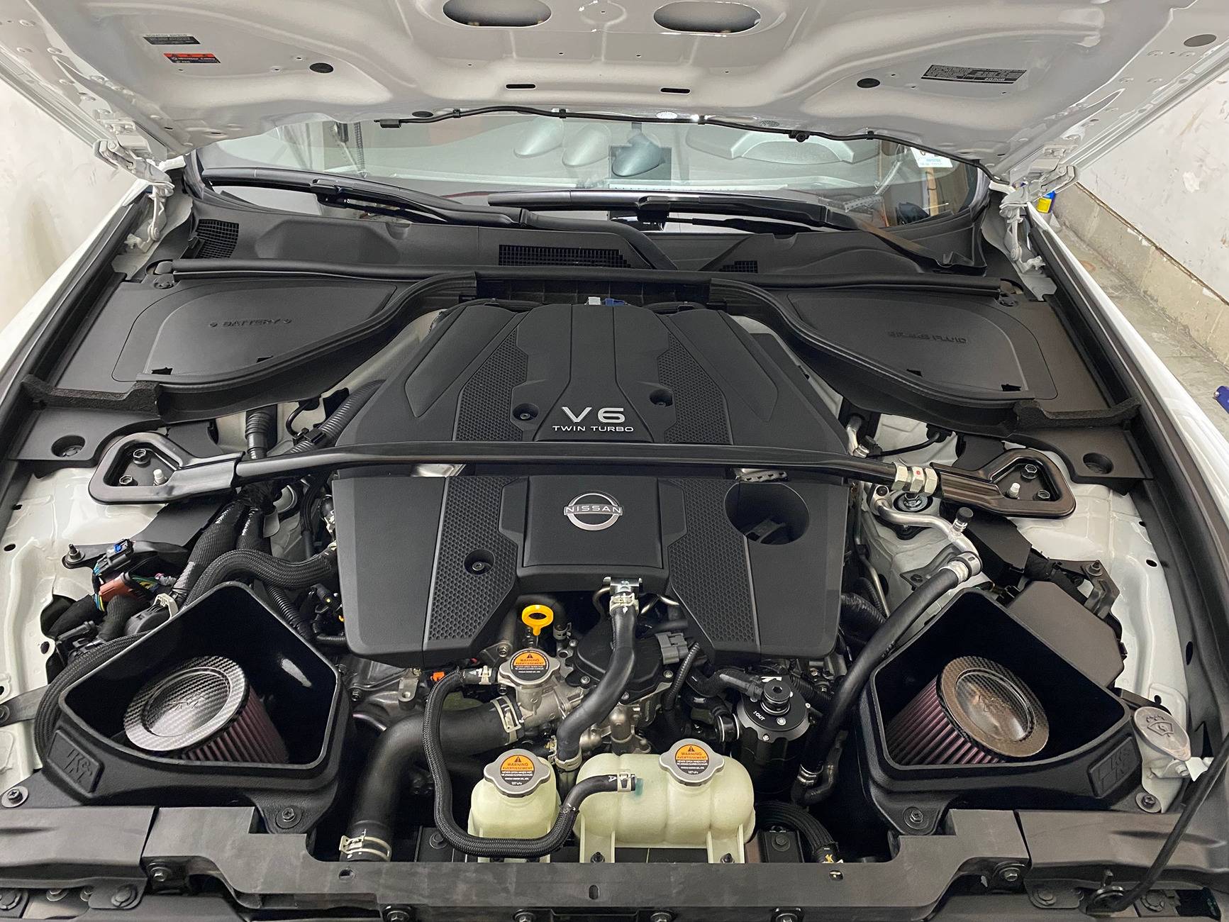

Don't mean to be a dick - but again you are all over thinking heat soak with a turbo the exhaust that's spinning compresor is how hot - running open intakes doesn't changes your charge temps. If you want to argue when tracking the car and in your 20th lap your charge temps went up and you're blamming that on open intakes - head explode. Go A2A or upgrade your intercoolers. If you put anything less than a 3" intake on these cars you get ZERO performance benefit and then run them close and you're not even getting the cool noise benefit. if you DO NOT use yor car primarily for road course run them open.

Wish I would've listened to you when you bought yours instead of the K&N. Yeah, the K&N looks nice, but I mainly wanted the turbo sound. I got a hell of a deal on the K&N though.
