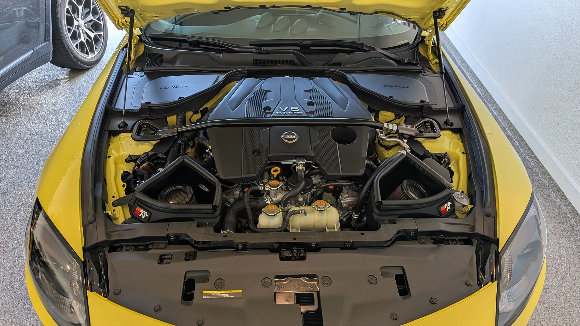

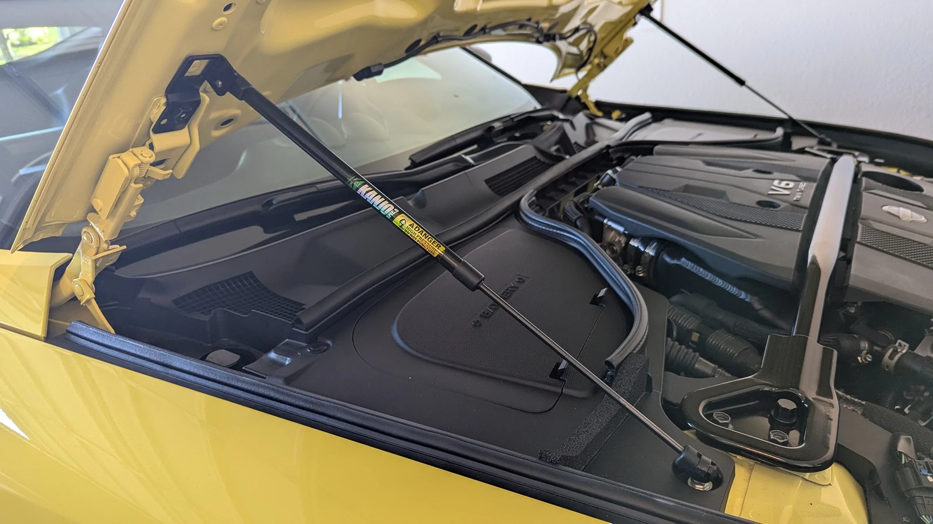

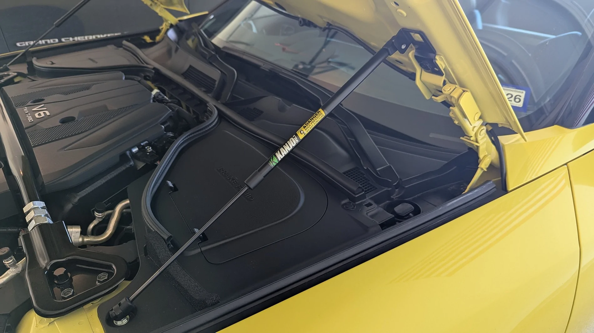

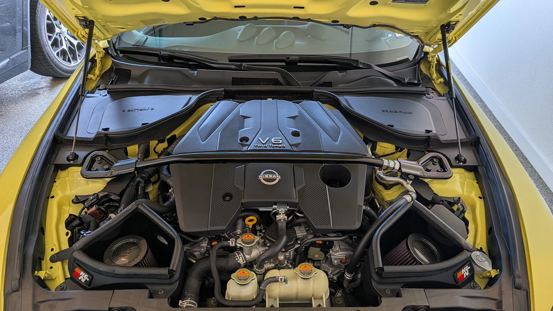

Hello friends. I installed a set of Kanjo Spec D hood struts on the Z last week. Gotta say, I really like them. It took about an hour to install (with filming.) Would probably be a 30 min job otherwise. I also confirmed that you do not need to lift the front of the car to install these struts. Turning the wheel to full lock give enough space to weasel a 13mm socet and extension above the upper wishbone to tighten the lower strut mounts.
They are very smooth. Much better than the stock prop-rod. :)
