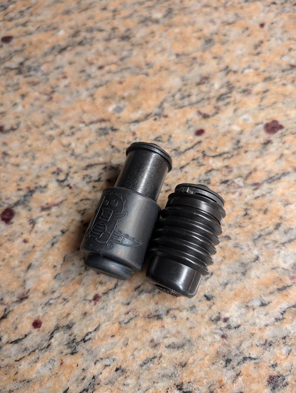

Old post, but here's an update in case others are still having problems. O wise and knowledgeable @Mud gave sage advice.
I tried step a) which seemed to fix it...for awhile. Nissan replaced the OEM springs with new OEM springs, and I had a good experience for several months, but now it's back to not working.
In fact, the hatch failed to open when I went to the car to implement step b). Yes, I ordered the aftermarket poppers from Z1. Now the hatch pops like "How high?" when I ask it to jump.
1,769
2,052

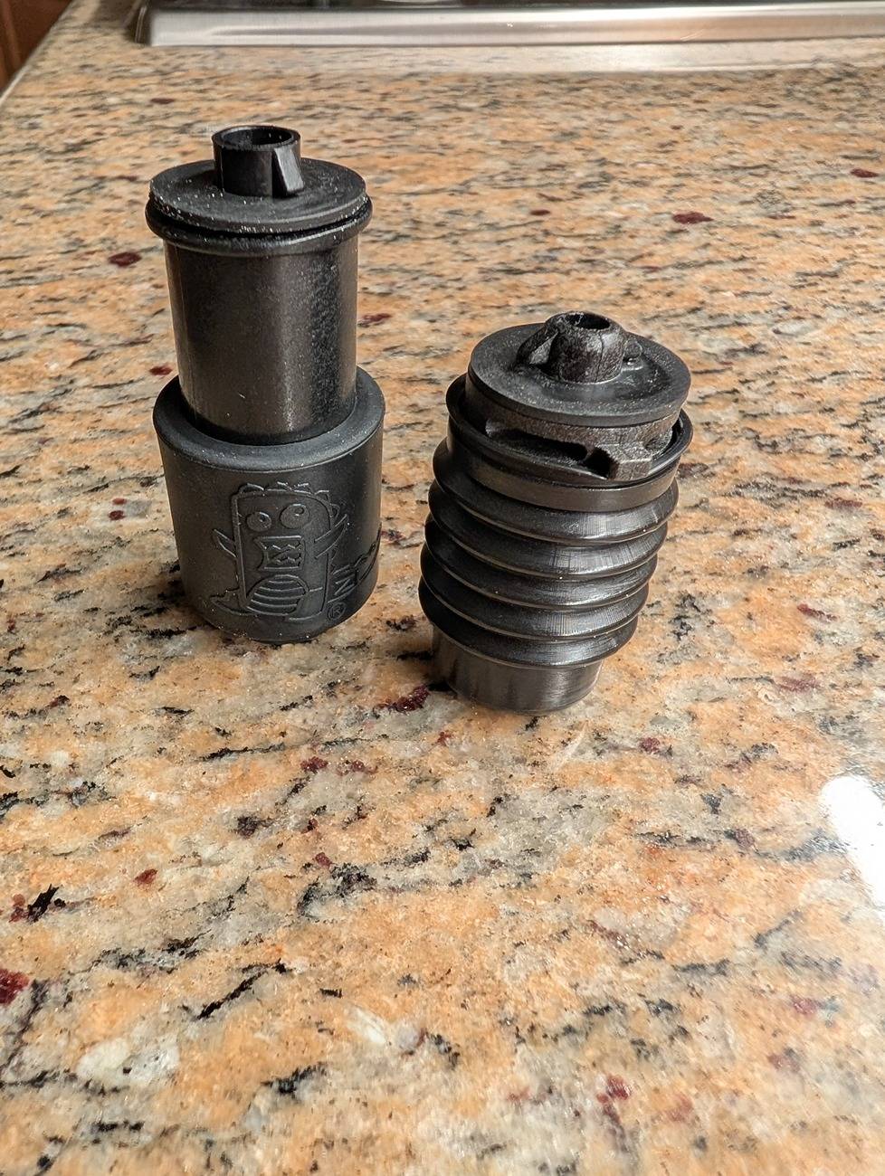

So, after using the Z1 hatch poppers for a little over a week, I decided to switch back to the OEM poppers.
With the Z1 poppers, I was hearing new creaks and rattles while driving. At first I thought my wife had left some junk in the passenger side door, but then I washed my car last weekend and I noticed that the hatch didn't seem fully sealed. It creaked when I pushed on it. I think the Z1 poppers may be too powerful, perhaps flexing the hatch.
I'm going to try the OEM poppers for a week or so to see the the creaks and rattles vanish.

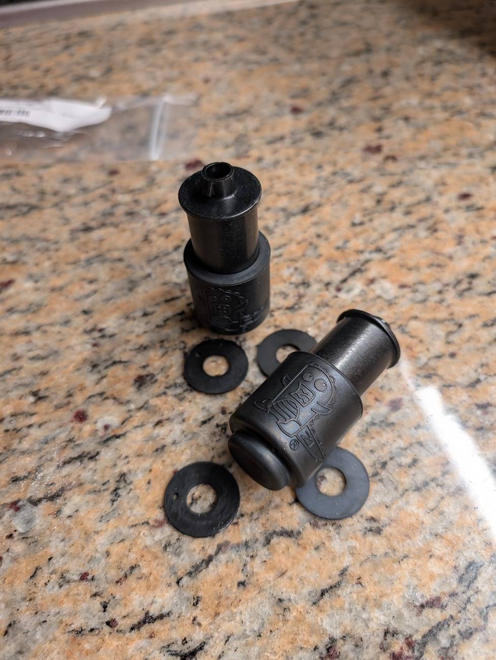

b) buy heavy duty hatch poppers from Z1 - link
I'm so glad I searched this, thank you!
2 play money plastic coins in each popper (even cheaper than the real thing) and BOOM my hatch pops straight up.

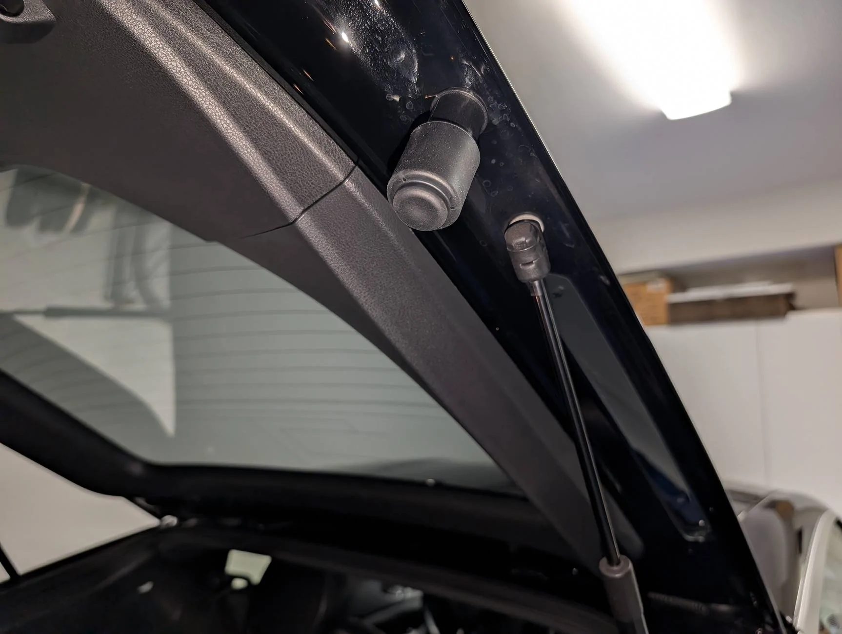

a) ask Nissan to fix it
c) insert some washers or coins for an easy 10 minute fix - how to
(I've done this on my 370Z, but my Z is ok so far)
d) remove trunk/hatch weight and see if this helps as in the 370z - how to
Updated list with option d
I stumbled across another option that I saw years ago and forgot about when I made this list.
It may help people with weak hatch release.
There is a weight in the rear hatch, under the plastic panels. Not sure for the reason. Maybe to give a more solid feel or help with closing?
Removing this will make the hatch lighter and help with opening.
Removing this will also assist if you've added the cargo cover or added a heavier spoiler.

I've also thought about disassembling the Z1 poppers to see if I can tone them down.
