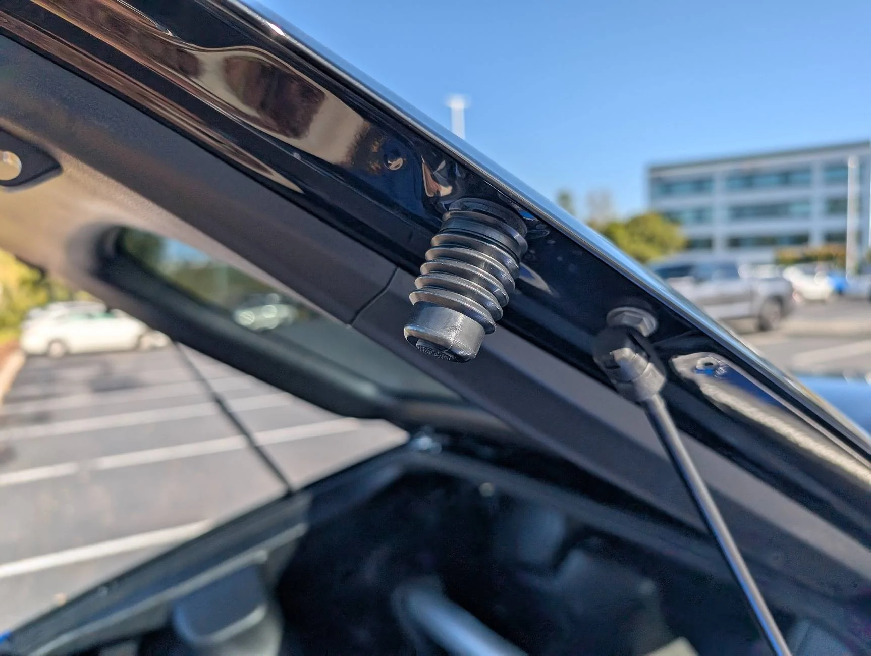

No worries. According to one video on this thread, on the 370Z, there's a weight concealed beneath the trim. But probably even if you remove that weight, the gas struts might not have enough pressure to lift the hatch. You'd probably need some powered mechanism to overcome the hatch weight and allow the gas struts to succeed. You can kind of feel that point as you lift it, and you probably don't want to fight with the hatch trying to close it. On the way down, there's definitely a point at which gravity takes over and finishes closing the hatch. I guess it's a balancing act.

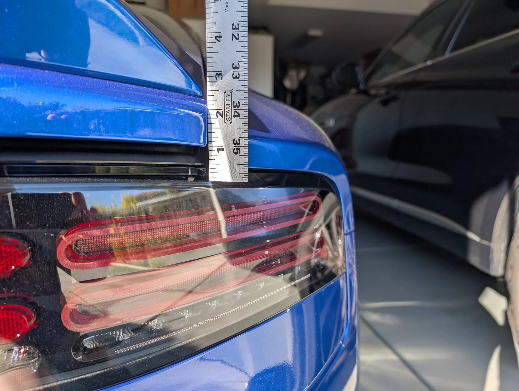

They installed the springs this week, and it's night and day. The thing actually works now. When you press the hatch button, the hatch pops up properly, and it doesn't stick anymore.
The hatch pops up a full inch. Previously it popped up only 3/8s or 1/2 an inch. It's visibly better and immediately noticable if your hatch is sticking.
