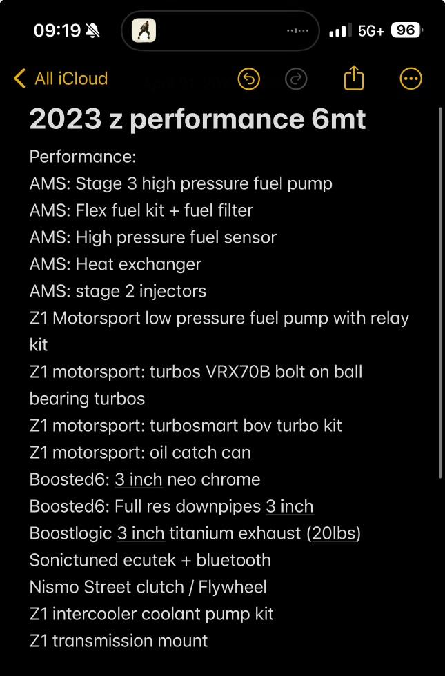

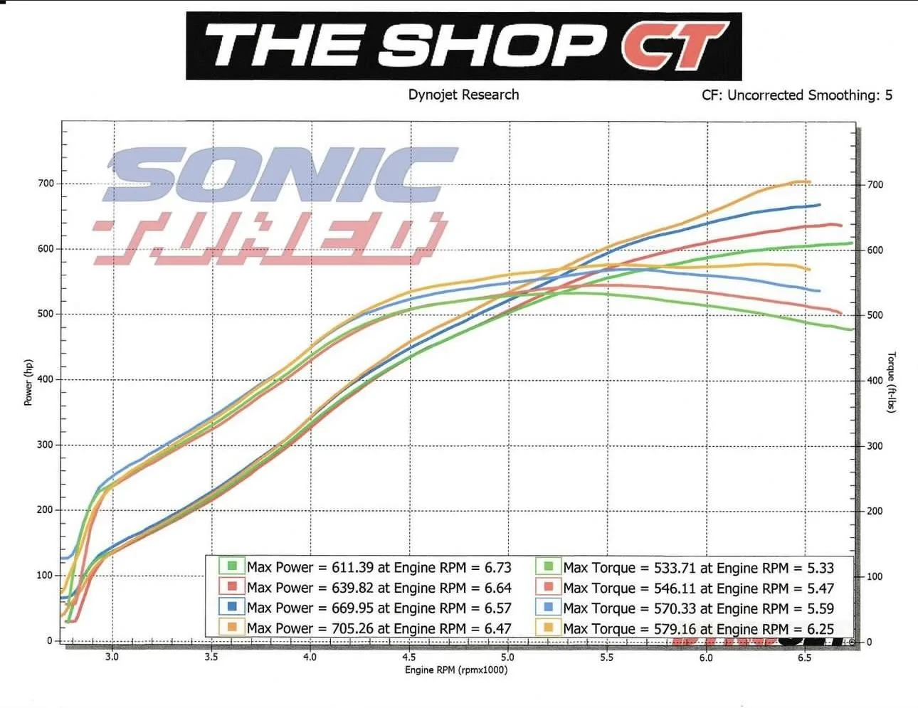

705 whp / 580 tq at 24 lbs boost only, spicy e60 mix. still got 6lbs of boost to spare.
stock motor, upgraded Nismo street twin disc clutch and flywheel good for 800hp / 750tq
untouched dyno, no custom calibration, I did street revisions with mark till it was go time on the dyno, no maps were changed, mark only upped the boost with a tad bit of timing, 30 min in and out with amazing power.
tuner: sonictuned ,
honestly the best vr30 tuner, guy is a guru, from street revisions to dyno, everything was spot on. So happy I went with mark, he helped me thru out the process, answered all my questions and we achieved the goal.
mark also holds the record for stock turbo z quarter mile 10.418

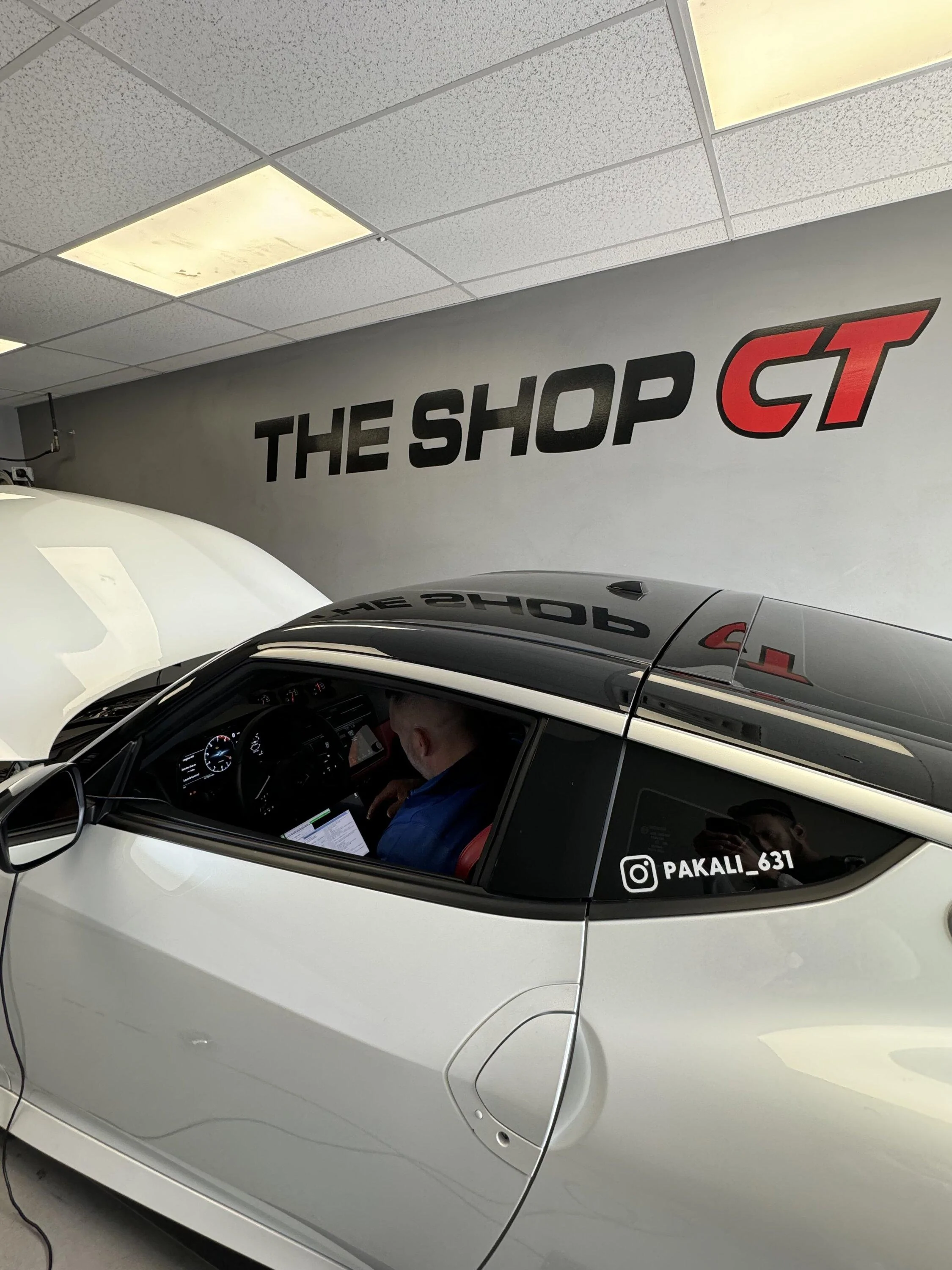

dyno shop: the shop CT in Connecticut.

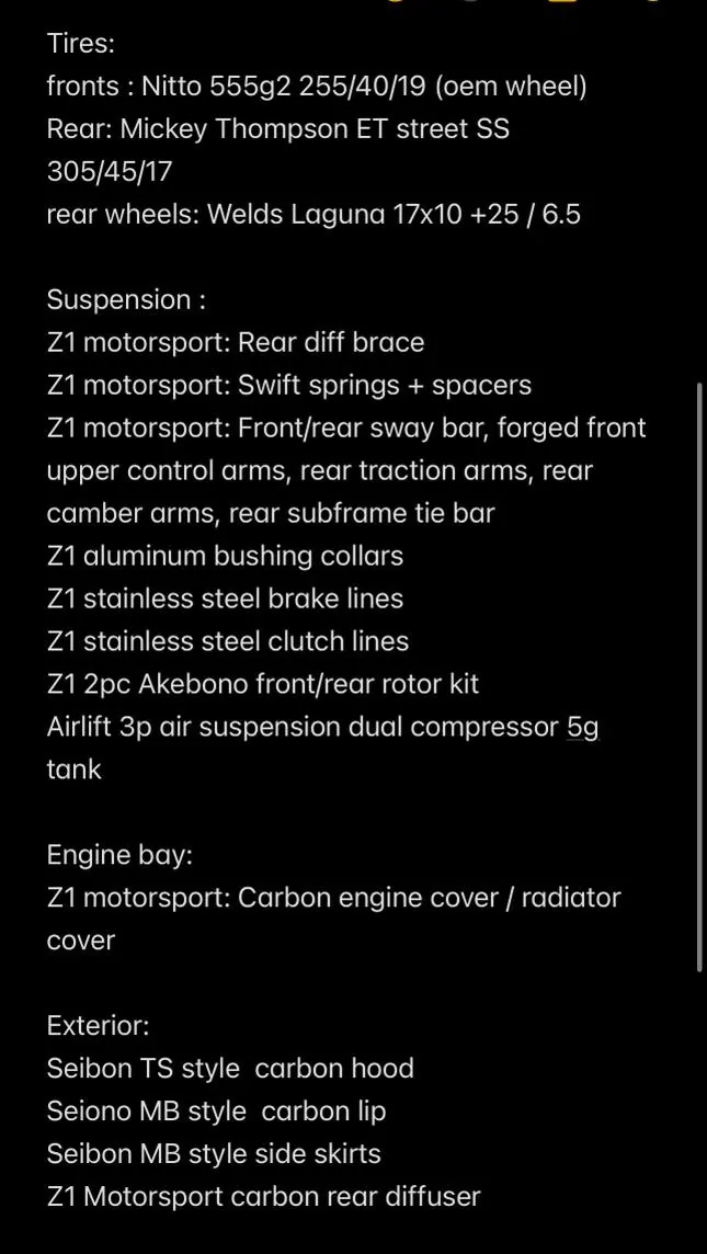

full build parts listed in the pics below with some parts that still needs to be put on.

3 inch full boosted6 resonated downpipes + 3 inch boostlogic titanium exhaust. Absolutely love this combo

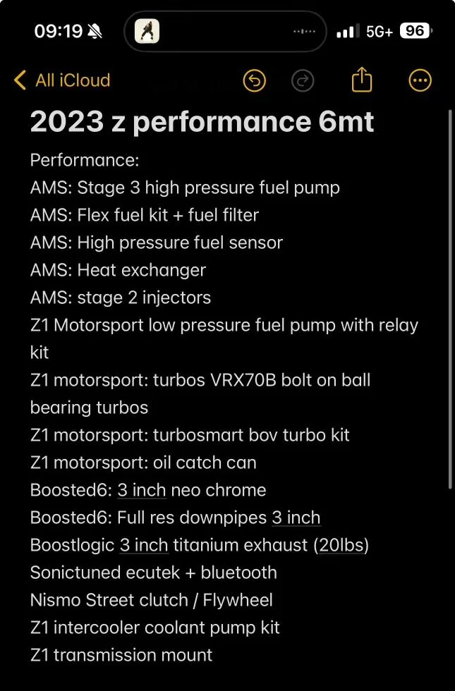

1. my performance mods only to achieve this was around 14k, give or take depending on what exhaust you go with, my 3 inch boostogic was 3.3k, but you need a 3 inch exhaust and some go for 1200 +
2. the labor part sucked, I had a professional shop do it, my transmission and engine had to get dropped, I also added more parts during the install besides the performance parts, mine was roughly around 3.5-4 labor and it took some time ..
3. if you have instagram, dm me, @ pakali_631 I can connect you to all the people that sell parts and they can give some discounts also
4. warranty only gets denied if the parts effect the problem. I have a nissan service guy around me that looks away, but if you get quality parts and the right tuner like I have sonictuned and a good shop, it's reliable. my z has 3500 miles now and its running so healthy.
5. I honestly would let a professional shop install it that works on nissan and Infiniti , like a speed shop. I don't mess with wiring, and flex fuel for ethanol, or any of that. I can't risk a mistake on my end.
if you want 480-500 whp on stock turbos and don't plan on upgrading turbos, you can do intakes, 3 inch exhaust, 3 inch full downpipes, ams stage 2 hpfp, z1 525 hellcat lpfp with relay kit, ams flex fuel with fuel filter, ams hpfs, ams heat exchanger, get it tuned with sonictuned and if you go with sonictuned, he will answer every single question you have and guide you on your journey. he helped me out so much.
