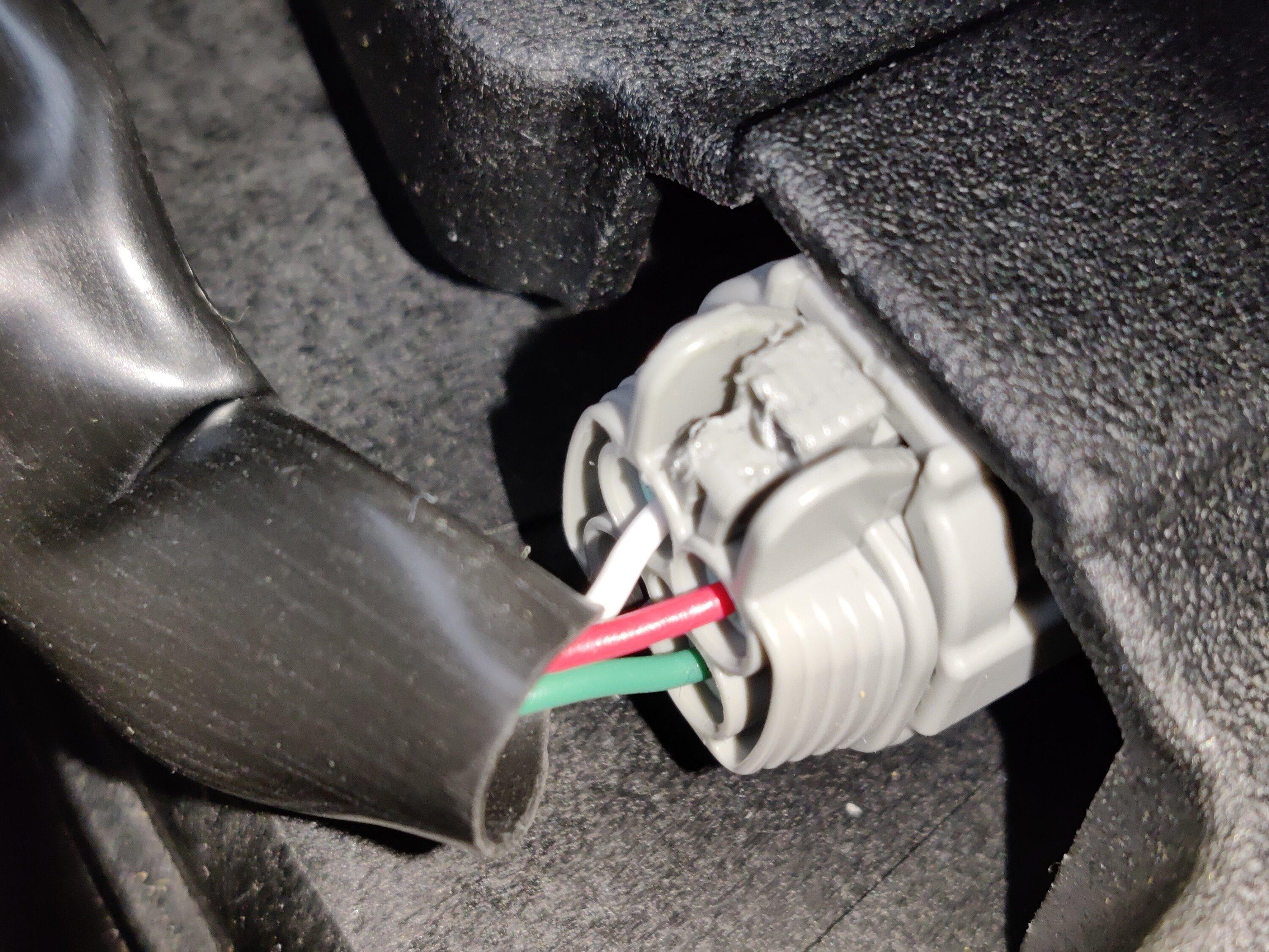

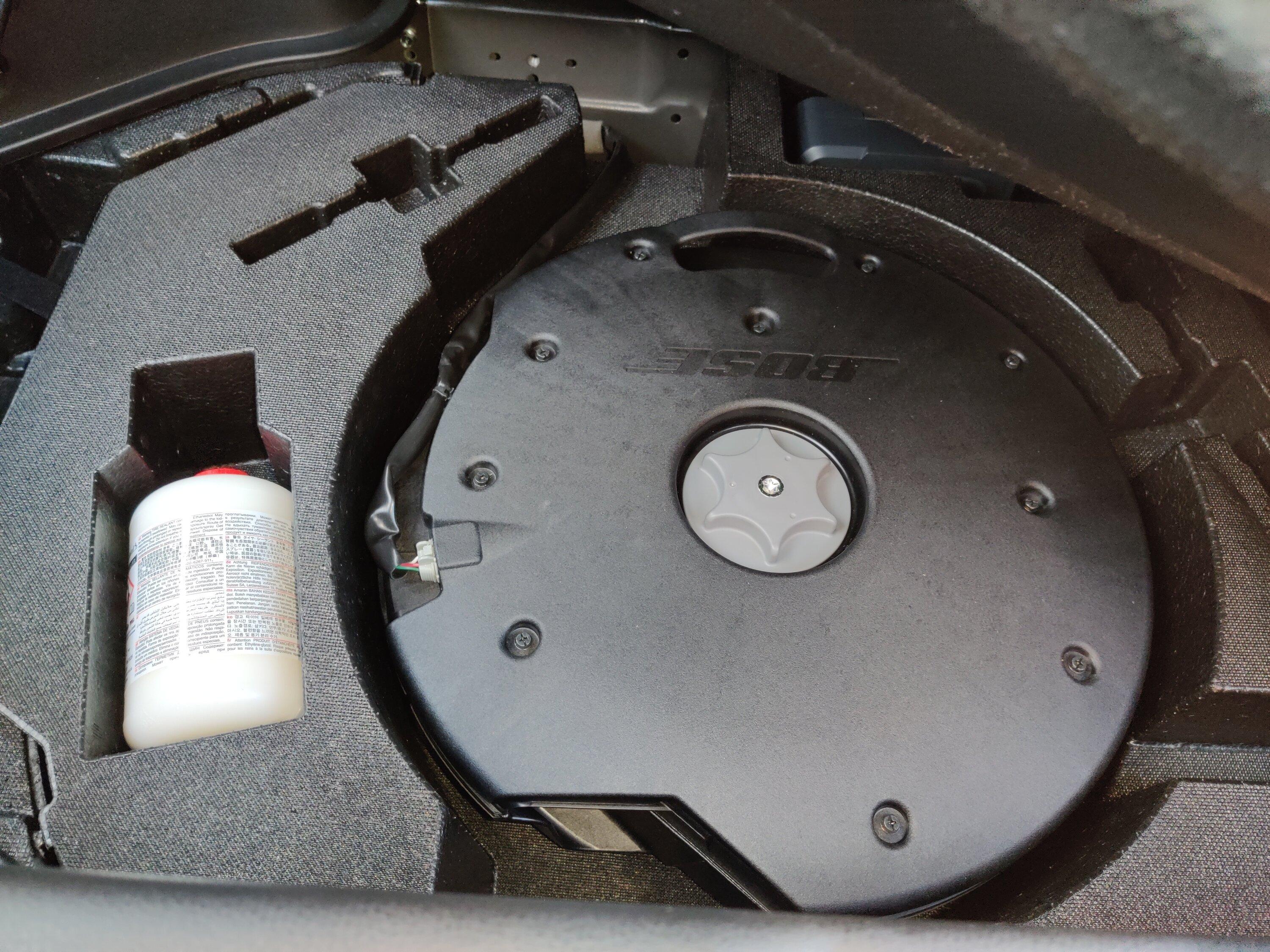

Does anybody know how to disconnect the subwoofer? This connector is difficult to detach...

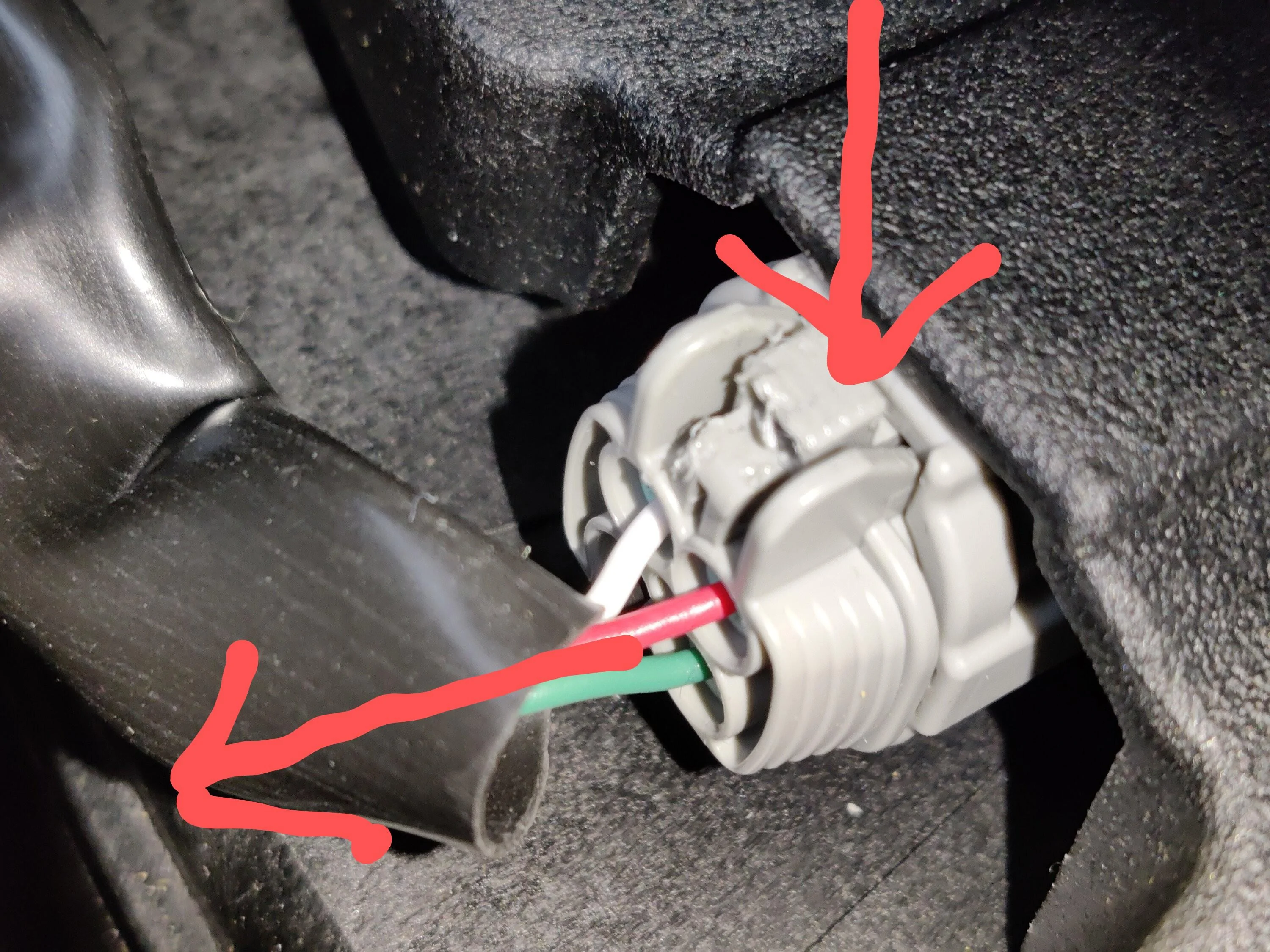

Push down on the tab (sometimes a small flathead screwdriver helps) and then pull back on the connector whilst keeping the tab pushed in....

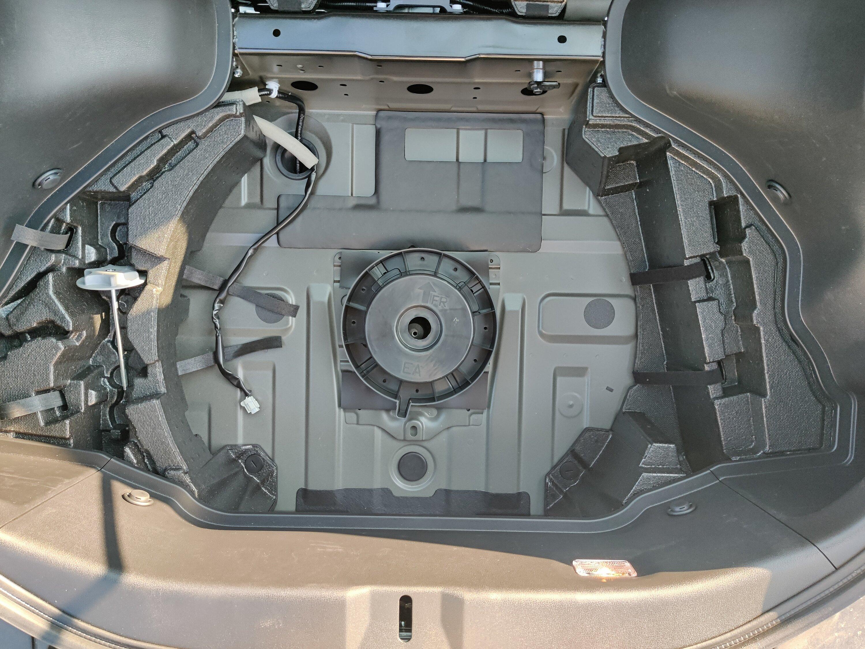

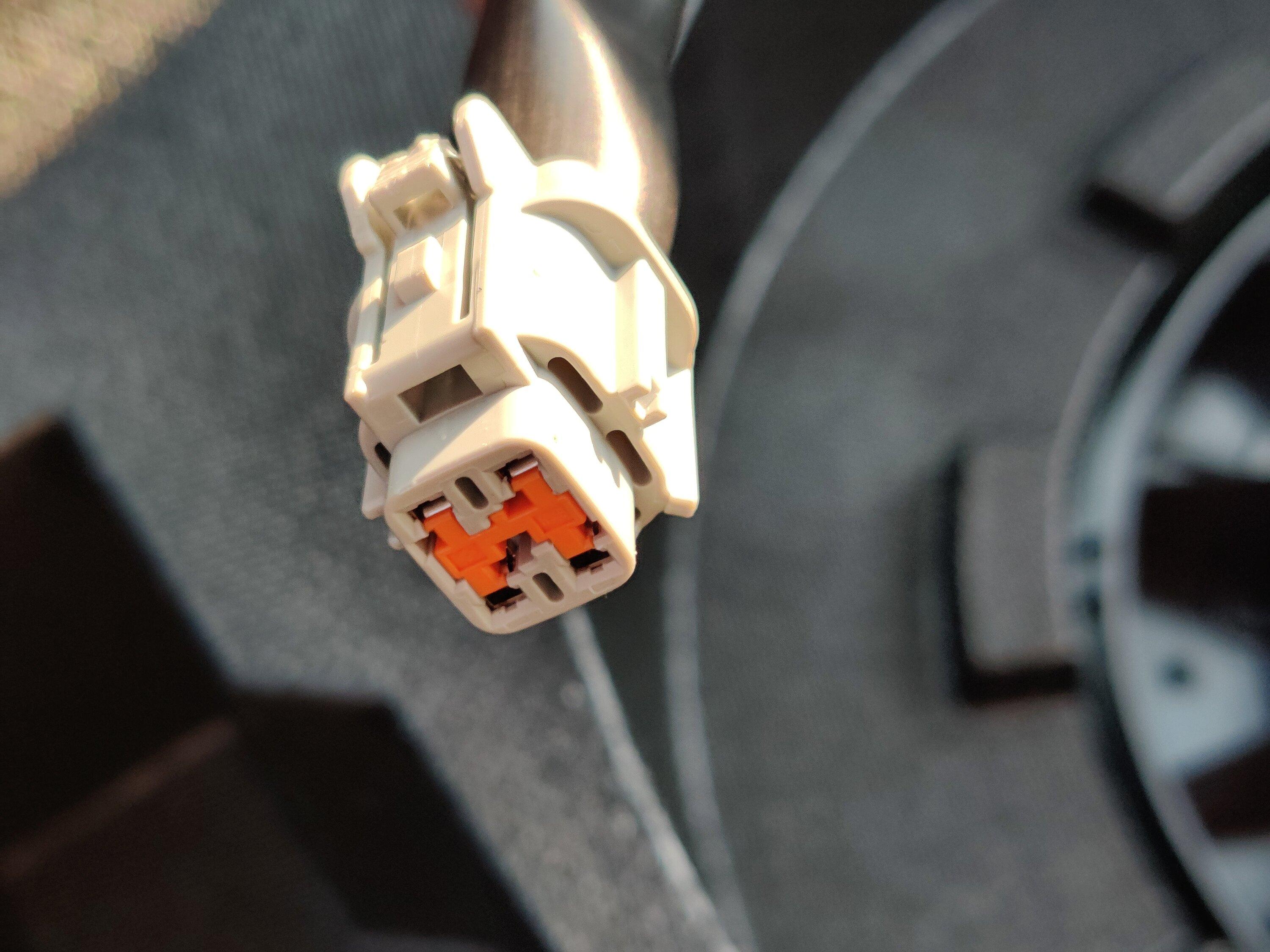

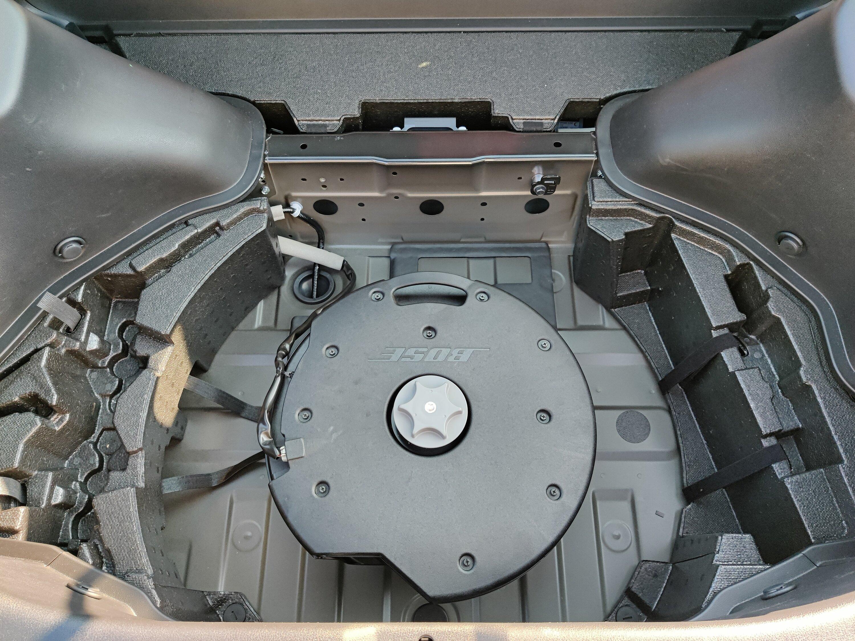

Ok, got it (can't just get it with a key lol, unless you have strong fingers). Assessing how to add a different sub setup in here. At least they didn't use a proprietary wiring to connect this.
The speakers can in fact play with full sound without the sub connected, unlike Chrysler UConnect.

I'll have to figure out what spare to fit in this bay. Once I figure out how I want to custom make my subwoofer box, I can have BASS and a spare, maybe even a fullsize spare. I hate fix-a-flat.

370z 18inch space saver spare fits and clears akebonos. Theres a post somewhere on here with the installation details.

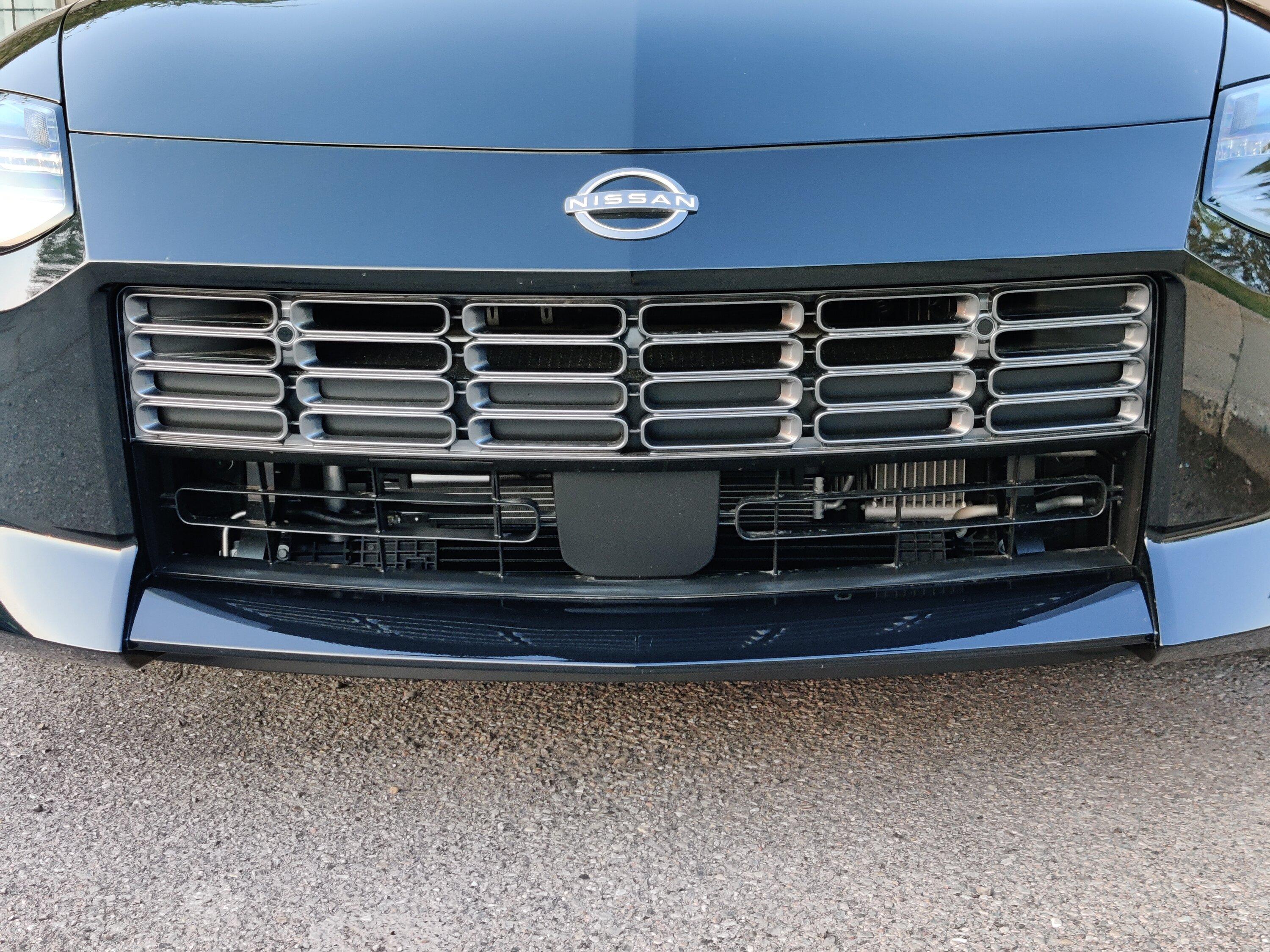

Does anyone know how to remove the front grill? A different look is NEEDED! lol.

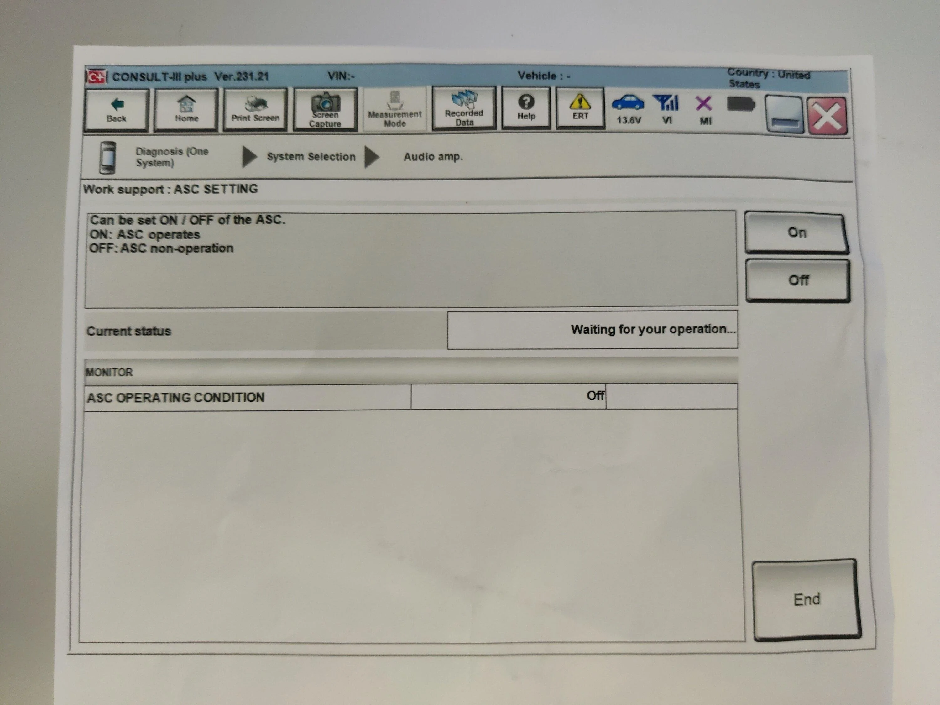

Had my dealer's Service Department disable the fake engine sound, at least I believe that's what it did lol. It's ASC in their system. Basically, if you don't mind the engine sound piped in, don't worry about. It sounds good to me. Disabling for me it sounds mostly the same. The mid-range is a little more audible, but it's not like night and day. It's not as smooth (which is a good thing). I can hear each cycle like an engine (hard to explain lol)
The sound engineers did a good job tuning the speaker system. I was thinking that disabling this feature would change the sound signature of the speakers. It added a little more bass, but like a little bit. I think that maybe the speakers just broke in more.
I disabled the engine sound so that I could change the subwoofer and not have the sound amplified. Hopefully this does the trick. I'm still testing it, but I think I like it this way. I might think about disabling the Active Noise Cancellation too.

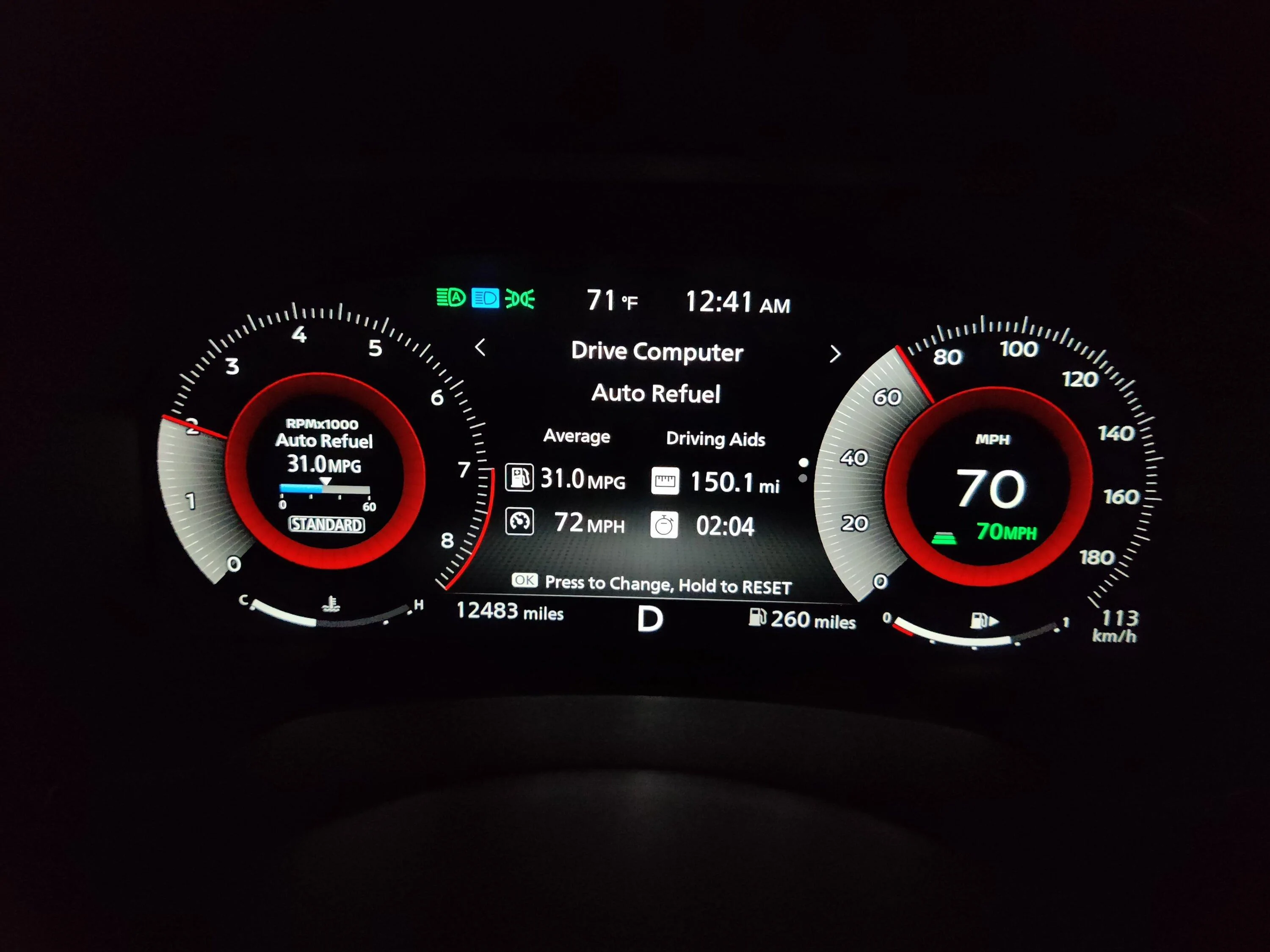

Finally took my first road trip in the Z4ME! I drove from Michigan to Ohio and back and got 31-32 MPG surprisingly. By my calculations (based on the manual saying that the tank is 16.4 gallons), that's 508-512 miles! Well maybe 450-475 miles if I want to make it to the gas station lol. Still, that's insane! I WANNA DO MORE! I can't wait to do another road trip, I love them.

Average speed is 72mph. Dude!

Auto refuel?
Yeah. The instrument screen has a fuel average computer that resets every time the fuel tank is filled with any amount (in personal screen settings). Handy if you like to keep an eye on how many miles you put on a tank or see how hard or green you're driving per tank. I haven't found a use for the Average Speed though.
It's only available in the screens other than Sport. (along with changing the Parking Sensor alert distance. Someone in a YouTube video was complaining about it beeping too far away from a parking block)
