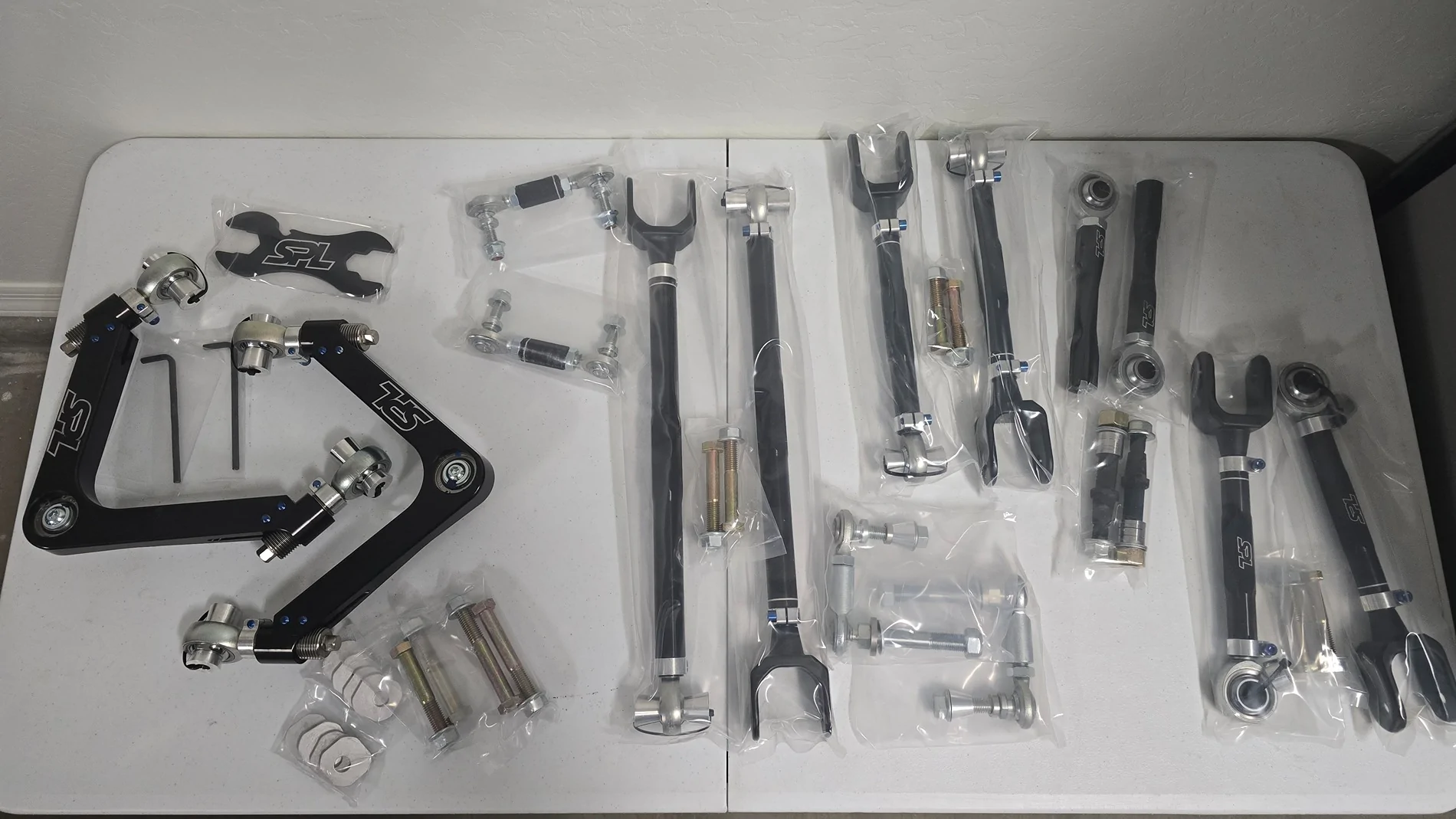

That is the lower price for all their components and is $3000. You can add the not need Billet parts to make it $200 more.
You can find packages.
There are lower price options out there, but I been talking to a few that have recommended them over others.

103
2,850
5,475
$3K for all that in the package shown is actually a great quality buy for the SPL's proven quality. Then again, those components are useful if you continue to 'tune' your suspension, mostly for track applications, different track configs etc. For street use it's overkill, get the more reasonably priced kits out there, just go for UCAs that are easily adjustable without removing the ball joint, that's a pain.
HWill
HW
Oct 25, 2025
79
41
Arizona
2025 Nissan Z Performance
Yeah, I wanted full adjustability and to have a very track capable car.
I usually over build my cars for what I end up doing with them, but this one might be different.
I will say that the quality and the ease of adjustability of the SPL is nice.
