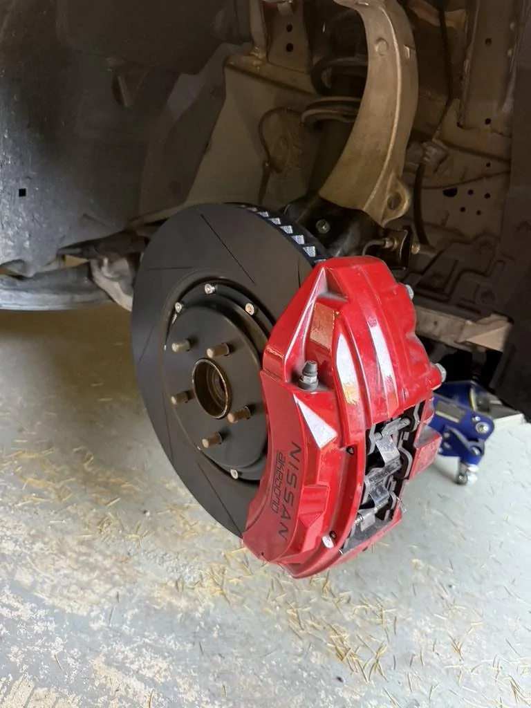

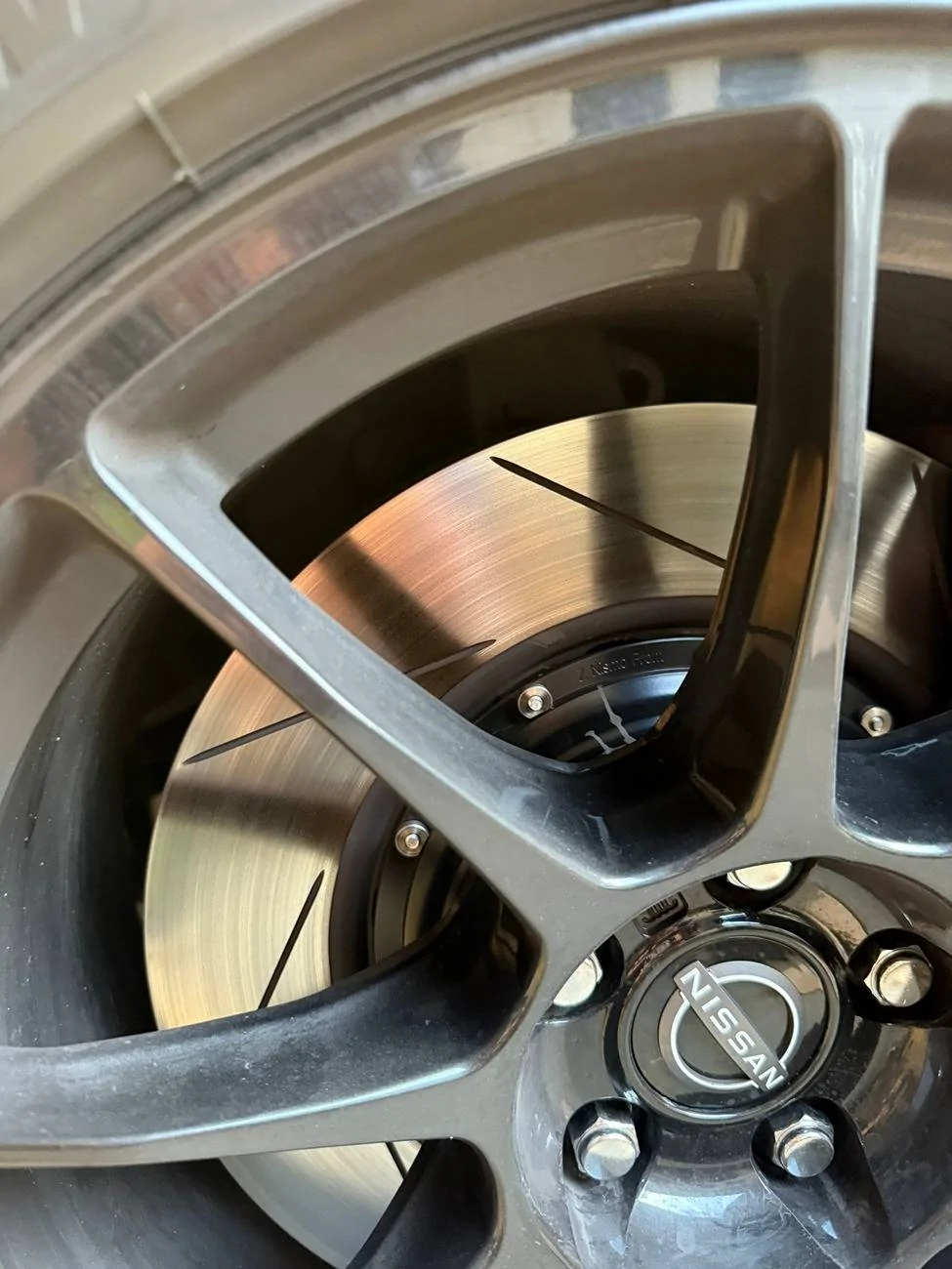

Been thinking a lot about brake cooling lately and was wondering if anyone had done anything with the newest generation Z. From my searches I've found one product that's for sale from Seibon that only attaches to their front lip and isn't very promising. I found a much more intriguing option in the works from Touge Factory but it still seems to be in the development phase. I did shoot them a message on instagram and they said they will get back to work on it soon but it's been sidelined for other stuff in the meantime.
There's tons of options for the 370Z so i've almost considered just buying something like this from Stillen and just finding a way to get it near the front bumper without looking janky but I'm not quite ready to try that one yet. I did pick up some 2 piece rotors from Paragon that I'm excited to try out on track in a couple weeks at Road Atlanta. They are almost 10 pounds lighter than the stock ones and I've been loving how that feels with the steering.

OP - I also called Touge Factory and they said it was still in development. Also, congrats on your CZP by Paragon rotors! I have the exact same ones and they are beautiful - haven't tracked them yet but did track the stock akebono rotors and they held up fine.

If you are new to tracking (HPDE) and not an actual racer then Carbotech pads, RBF/SRF brake fluids, are the most important. Keep a 10 or maybe 11mm wrench with you in case your caliper bleed screws need to be tightened due to higher than normal fluid temps. I needed to tighten my akebono caliper bleed screws after a few runs at Road Atlanta last summer.

Appreciate the help, this will be my 4th event now and I actually wound up sending pads in to carbotech to get some made back in November since there were no aftermarket options for the Nismo front brakes. I recently just learned to do brake bleeding and fluid change when I got these new rotors on and I was amazed at how good my brakes felt already just doing some mountain driving.
I'm going to try and do some data collection at road Atlanta with the new rotors and see how hot it's getting 👍 I appreciate all the links and help shared

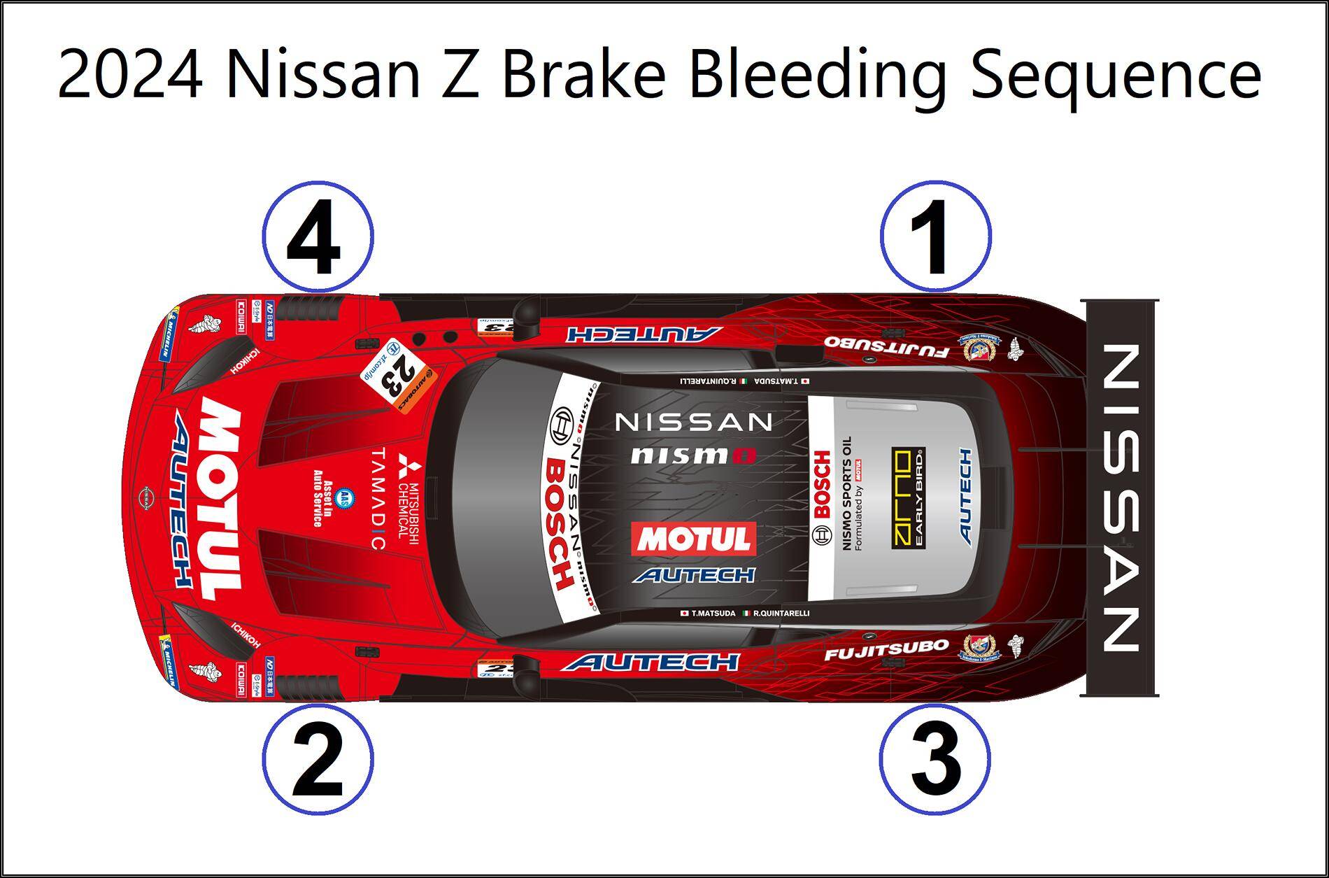

Sorry all, I don't really have time to search. Thanks in advance!!
What's the order of bleeding calipers in the new Z?
