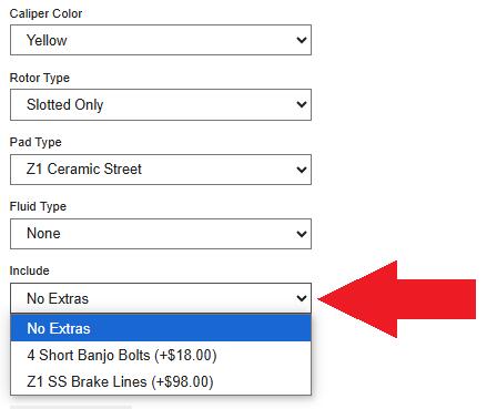

The drop-down selections on the right give you the option to select banjo bolts or new brake lines.
You'll only need one of those.
They also say:
Installation note: You must either, trim, remove, or replace the dust shields behind the brake rotor in order to get the proper clearance of the larger 14" brake rotors and calipers. OEM Dust Shields designed for factory sport brakes are also available in the product options and negate the need for any modifications to the OEM dust shields.
You can also add dust shields (hidden under the "Extras" drop-down in the pic below. They're $480. May be a hassle to trim the current shields, but shouldn't cause problems. $480 vs trimming; personally, I'd trim.
