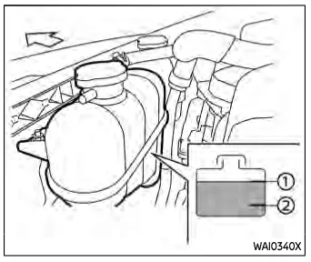

Fuck, I smelled coolant or a rubbery smell from
The engine on Saturday, I keep checking my temps while driving but I need to check my levels when it cools off in a bit
I've noticed this before on multiple vehicles & had the same fear, and it was unfounded almost every time (2 exceptions were both 20+ year old radiator cores failing). It is usually just the coolant reservoir venting pressure (and the sweet aroma of coolant) after it has been driven. See nozzle below the cap on diagram from Owner's Manual Page 8-5:
For now, keep calm & check the levels periodically is probably the right approach. Make an appointment with a dealer if you detect & document a consumption pattern, or coolant signs in the oil.
