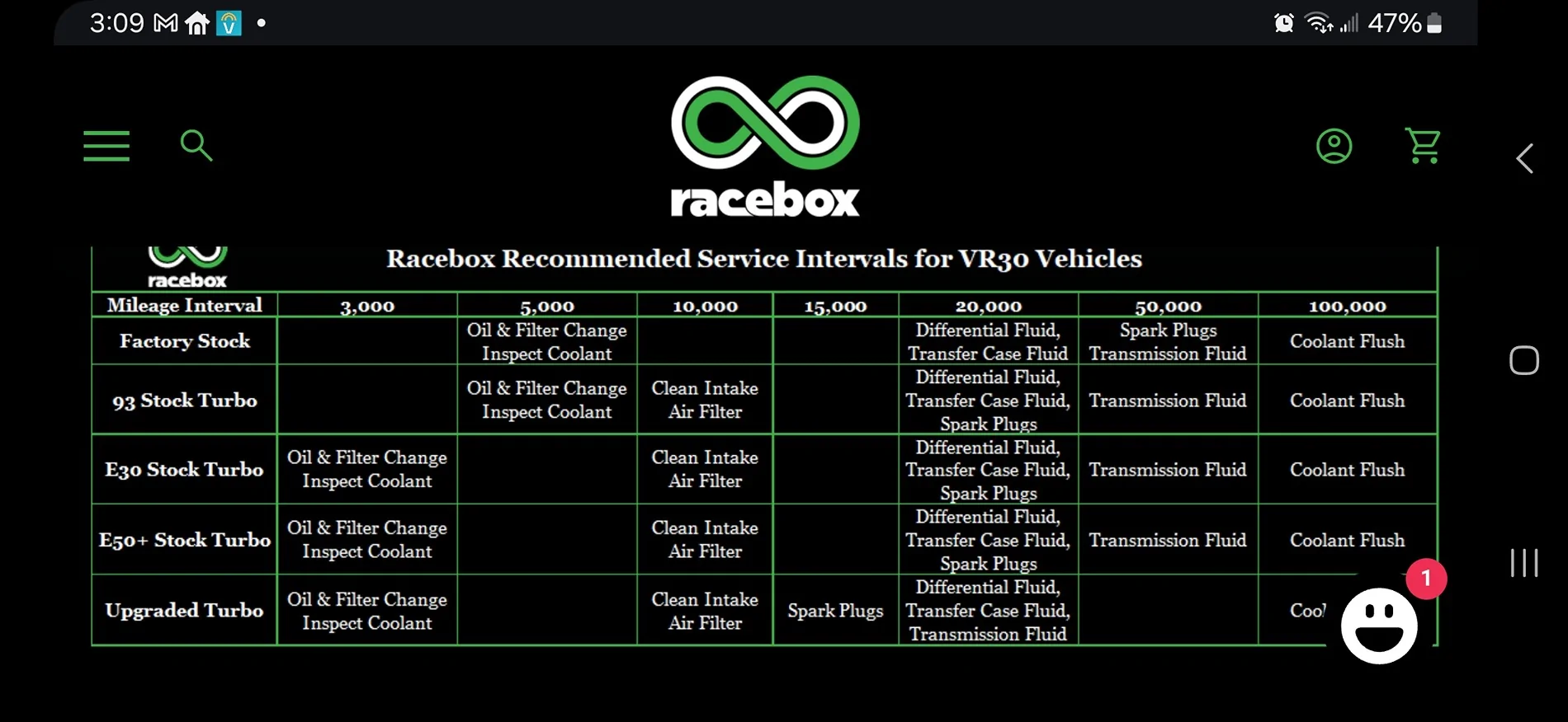

Last time I checked this engine is being used by several vehicles Infiniti/Nissan for the current and previous generation. Haven't been a major recall regarding blown engines of a 1000. Check and change oil frequently not 10,000 Miles and use full synthetic. Pay attention to oil pressure at idle . Should not be less than 23 PSI at idle. SONICTUNED and Racebox suggestion.
