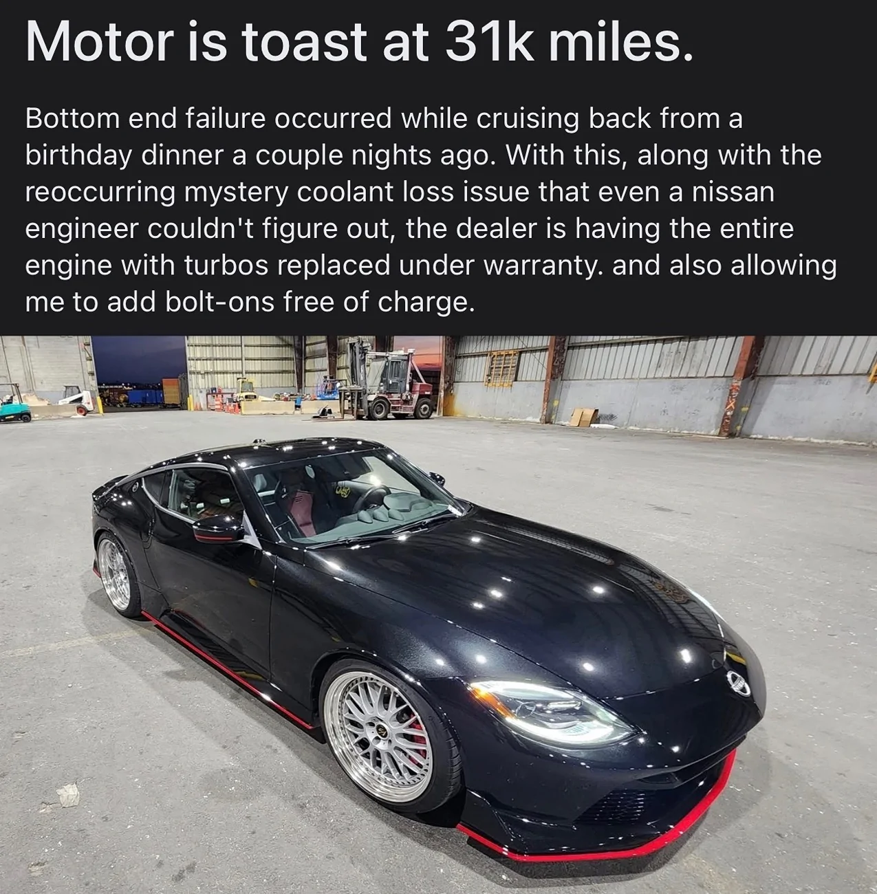

Didn’t want to be that guy but…
“Motor is toast at 31k miles.
Bottom end failure occurred while cruising back from a birthday dinner a couple nights ago. With this, along with the reoccurring mystery coolant loss issue that even a nissan engineer couldn't figure out, the dealer is having the entire engine with turbos replaced under warranty. and also allowing me to add bolt-ons free of charge.”
The dealer is installing mods for free and honoring the warranty? What dealership is this?
Appreciate you sharing. Lots to digest here.
If you don't mind me asking, are there any more details that you are aware of? Was he/she tuned?
