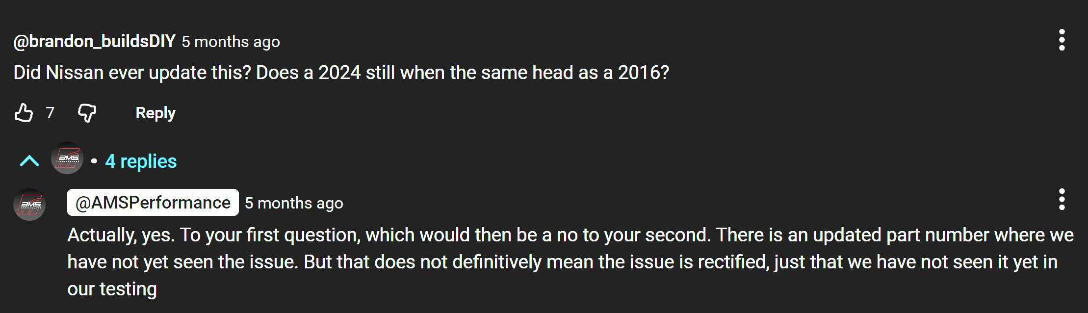

Isn't cracked heads what AMS determined was the actual issue? The block was never porous?
ChatGPT is going off the diagnosis of the time.
AMS determined it never was a porous block, but if I had to guess haohmaru had ChatGPT search for "porous block" because that's what it was referred to at the time by many; the AMS discovery was relatively recent, so if you wanted legacy data over the past few years that's the keywords you would have to go with I'm guessing.
I never believed for a second it was a porous block, but that's besides the point.
The terms in that chart ChatGPT referenced are very arbitrary and I've definitely read up on cases of post 2020 Q50/Q60's having the issue.
Keep in mind as much as ChatGPT can do things well, it can and does still hallucinate. In its message it says: "2019+ VR30DDTT engines (both Luxe and Red Sport trims) still experience typical issues — sensor failures, turbo oil leaks, thermostat faults — but not the coolant-in-oil “porous block” failures. " Leading us to assume zero known occurrences.
However, in the table below says its "near zero" for 2019+
I'm doing my part by getting a UOA done each time, but if I had to hypothesize, its an inherent design flaw in the heads and things like higher boost result in higher cylinder pressure which likely leads to the more likely event of these cracks happening.
I'd be curious as to if there is a reliable source that can confirm the manufacturing and head casting improvements.
Yep, that's what AMS reported exactly, not related to porous blocks. But what is the commonality, any more numbers to validate the cracked heads, and stock vs built (overboosted, wrong fuel, octane, AFR, etc?) Good topic to track numbers by, if a true design issue.

Yep, that's what AMS reported exactly, not related to porous blocks. But what is the commonality, any more numbers to validate the cracked heads, and stock vs built (overboosted, wrong fuel, octane, AFT, etc?) Good topic to track numbers by, if a true design issue.
This is key. You make a great point.
Lots of variables to this entire situation. Stock vs Modified? And, to what level of modification?
In most instances you aren’t sending a motor out to be fully built unless you’ve essentially exhausted what it’s capable of with bolt on’s and tunes. I presume someone sending the motor to AMS to be fully built is pushing the capabilities of a stock motor, hence why they are looking for more.
I genuinely find it hard to believe this is a legitimate and widespread concern, with an intake, exhaust, and a conservative tune. Much less a stock motor.
I’ll be interested to see actual data on this. In the meantime, I’m not losing sleep over this.

That's my take too. Heads cracking definitely seems to have been an issue when the motor came out but Nissan addressed it. Probably can still happen on highly tuned engines, but highly tuned motors failing is not a problem unique to the VR30.

This is good to know. Always helps to ask for more details for context. AMS should've said that in the first place when testing OEM stuff, years, versions, etc. Major car manufacturers normally update stuff when there are design issues, but not always.
