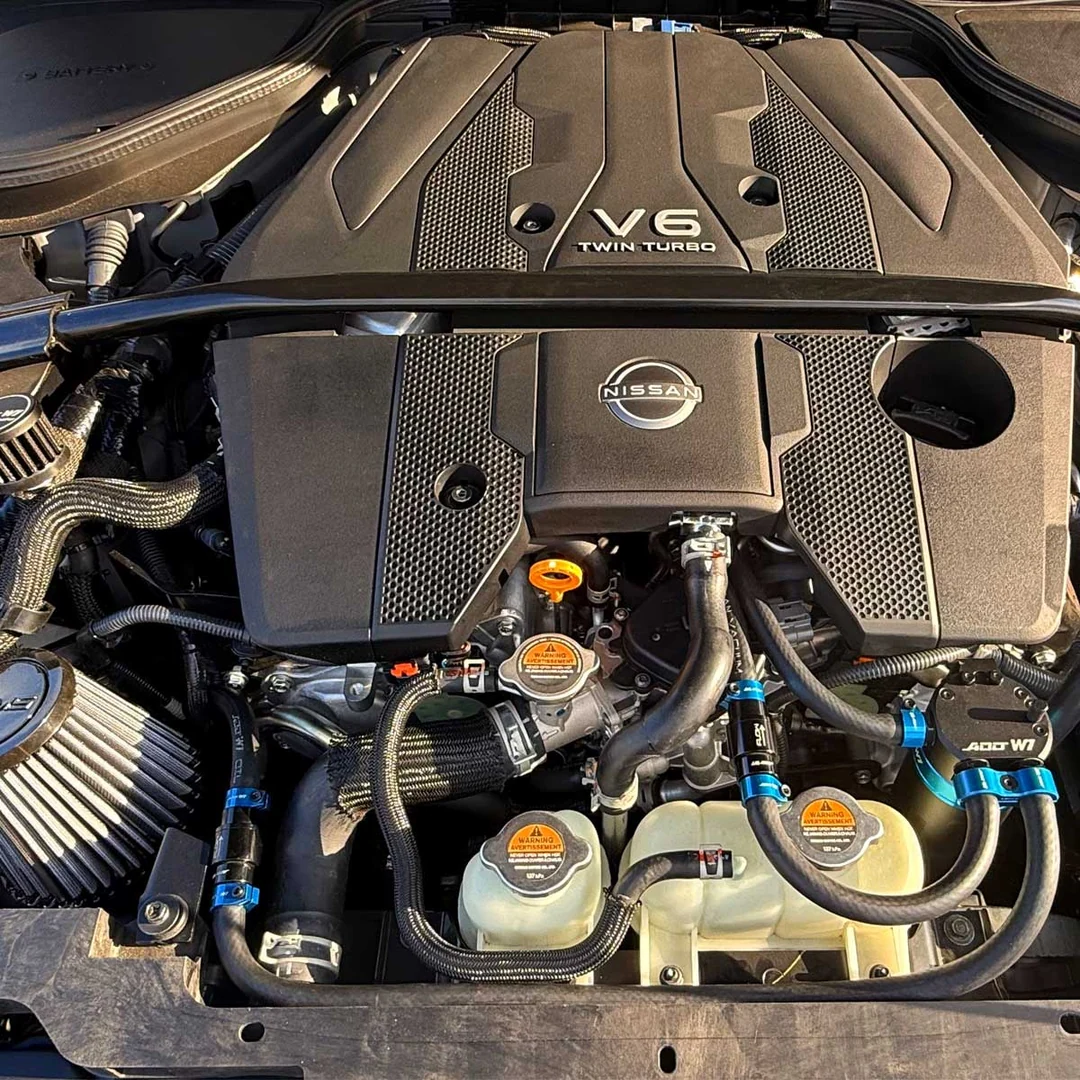

Hey guys I’m hopping someone can help me out here I just got the add w1 catch can for my z but the instructions aren’t actually instructions so I’m hopping that someone who has installed it can help me. I have the one that handles ccv and pcv in one can I think either way it has 3 hoses one goes to the drivers side and the other to the passenger side but that’s all I know as far as where they need to end up. I know how to do the drivers side for the most part but the 3rd hose is what’s causing me to be confused.

No one has done the 3.3 on the RZ34. Its either the driver side, or you buy a 2nd can for the passenger side. I seen 1 person so far do the passenger side with a ADD W1 can. He does not have a step by step instruction. He has the Z1 for the driver side.

The only thing I can say is that clearly someone has done it before hence the photo. So more or less I’m just trying to figure out where the line to the passenger side connects to.

Based on this three hose design, and having already installed and understand the driver side 2 hose setup, I may be able to shine some light
EDIT AFTER THINKING FOR A BIT
YOU MIGHT be able to run from PCV to pre separation, and passenger valve cover to pre separation and then the post separation line to the passenger side pre turbo and plug the intake manifold. This would be the only safe way to do it.
Do not connect the post separation line to the intake manifold because you would end up adding boost to the setup and your crank case.

Ok so I’ve done some brain storming and thanks to a set of instructions from a cold air intake I realized that the ccv dumps into the intake hose on the passenger side so I’ll have to find a T fitting and I’ll probably just hook the third line into that.

No. On the driver side valve cover is the PCV valve. It’s routed to the intake manifold. You will put a vacuum cap on the intake manifold and run the PCV to the can.
On the passenger side you will route the line from the valve cover to the can.
Those two lines are going to the inlet side of the can.
The outlet from that can goes to the intake pipe in front of (pre) turbo.
Done.
If that can has one inlet and two outlets then it won’t work. But it should have two inlets and one outlet
No “T” is needed.
any crank case psi will route through both valve covers, through the catch can and into the intake pre turbo. During a boost pressure state, the turbo will literally be sucking on both lines helping with ring seal and keeping any pressure from building in the crank case.

I’ll have to look again but I think the can has only one inlet and 2 outlets the reason for that is to have 2 sources of vacuum to have vacuum under any load or no load condition
