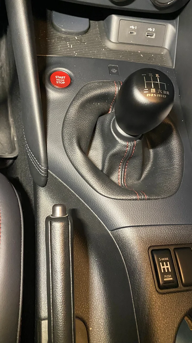

I replaced my shifter in my 27 Nismo with the same one that Mr. Mac used. I had to use tools to remove it. It's not damaged but it's not without marks either.
I love the new shifter. The dust debris you see by the phone charger is the glue they place at the factory...
Yeah, what's up with that glue they use? It's horrible, I haven't cleaned it off yet and I'm dreading it.
