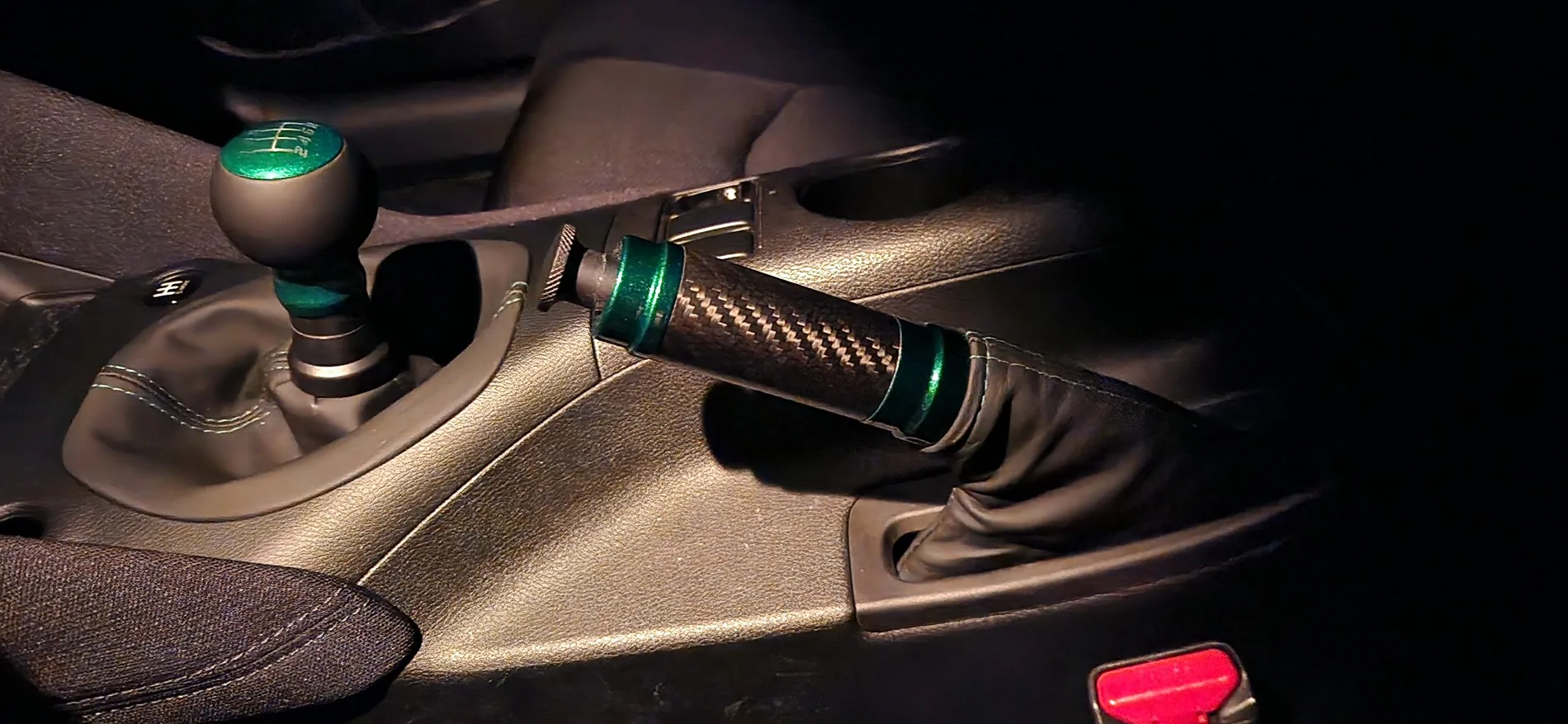

I was not fortunate enough to hand twist it off. It was bad, even with heat to try and give a little on the loctite.
The knob was not salvageable. At the same time, I replaced the shifter with a Torque Solutions from a Z34. It bolts in and shifting is smoother. Just know, rev hang is no joke with a short shifter. Pic of my setup.
Ebrake was done by Patrick @ customebrakes. Here's his instagram page. Message him and he will hook you up.
https://www.instagram.com/customebrakes?stkn=MXQycGVhNTMzamN0Mg==
