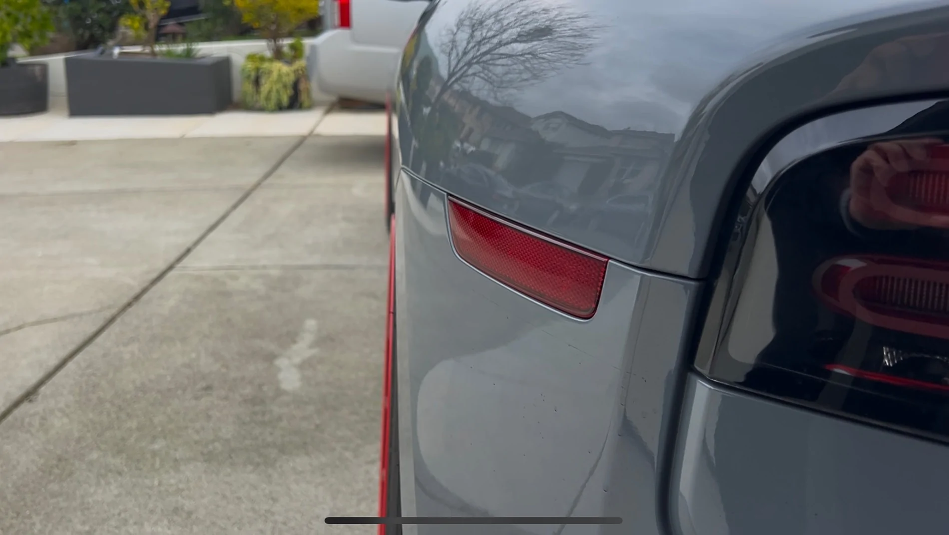

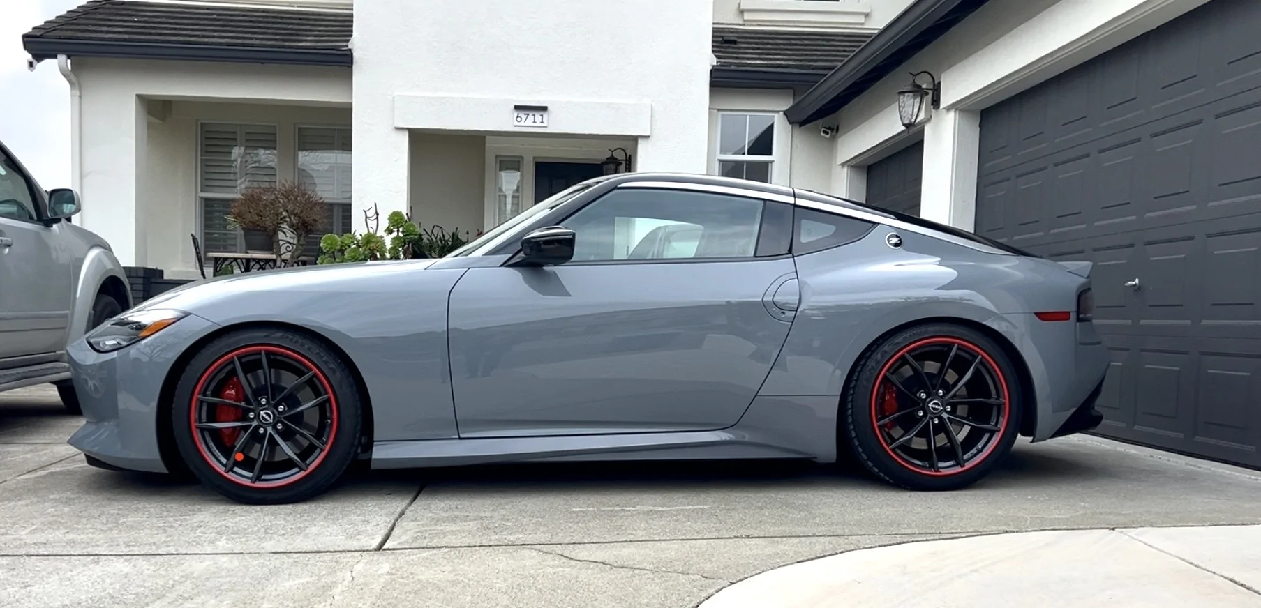

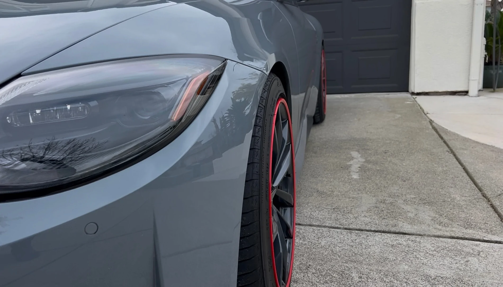

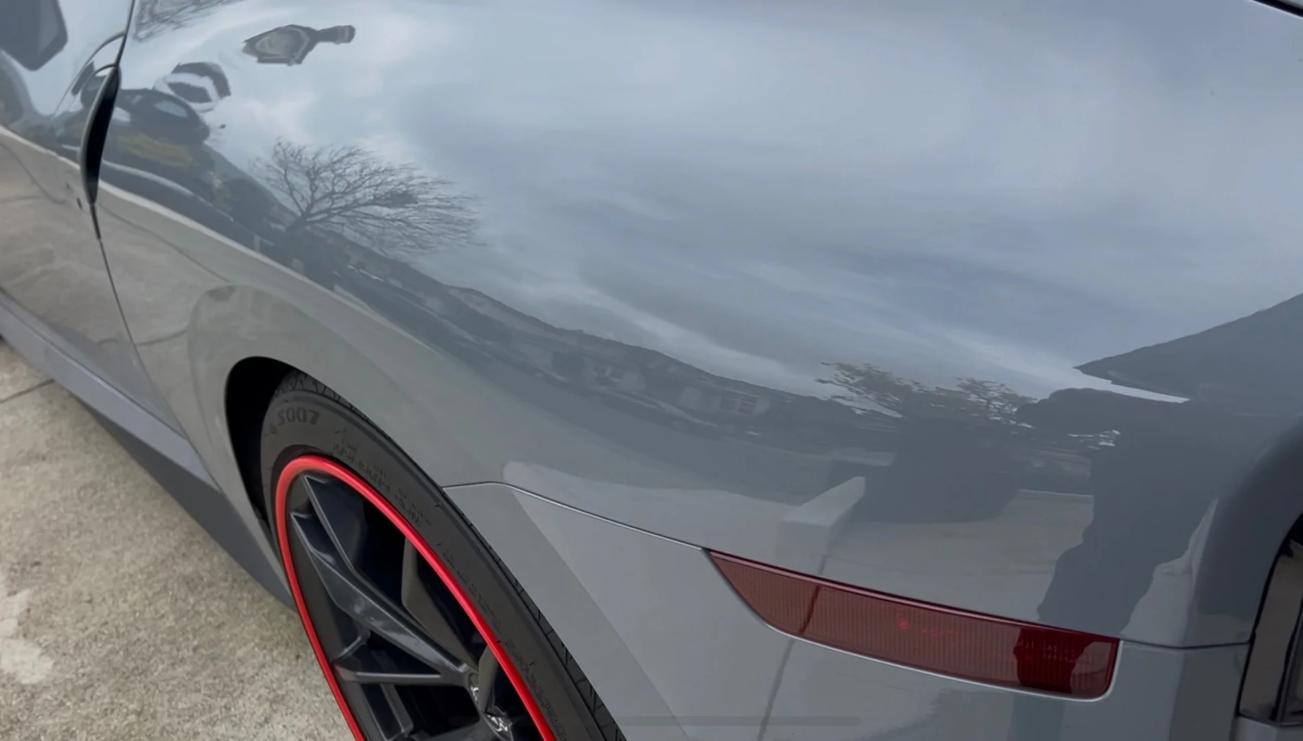

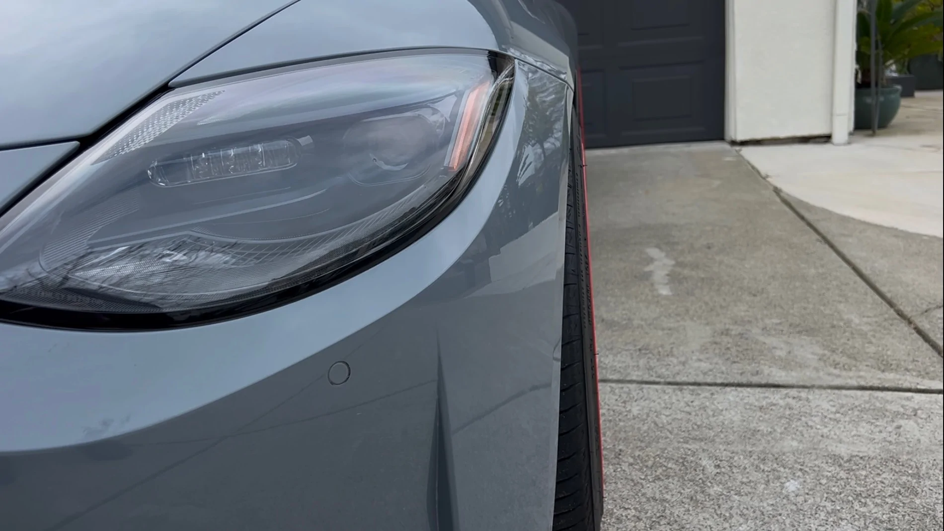

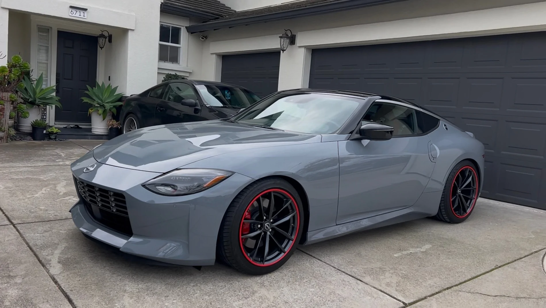

Haven’t experienced any rubbing (normal driving) yet on 25 mm all around. That being said, Haven’t driven over large pot holes are real aggressive cornering yet. And I have the lowered configuration with more neg camber.

Z1's stock height spacers are 20mm and it's literally perfect. IMO, the 25mm stick out slightly. I believe Z1's "lowered" spacer kit is 25mm.

I’m torn on this. The car needs to be lowered a bit, but looks so good at stock ride height and 20mm spacers. Can you go 20mm with a slight drop?

That’s correct. I got the lowered configuration and they are 25mm all around. Reason being is you getting more camber as you lower the car.

20mm would probably look better if only going a slight drop. I've got the Z1 lowered 25mm spacers with an inch of drop and they are almost too wide.
