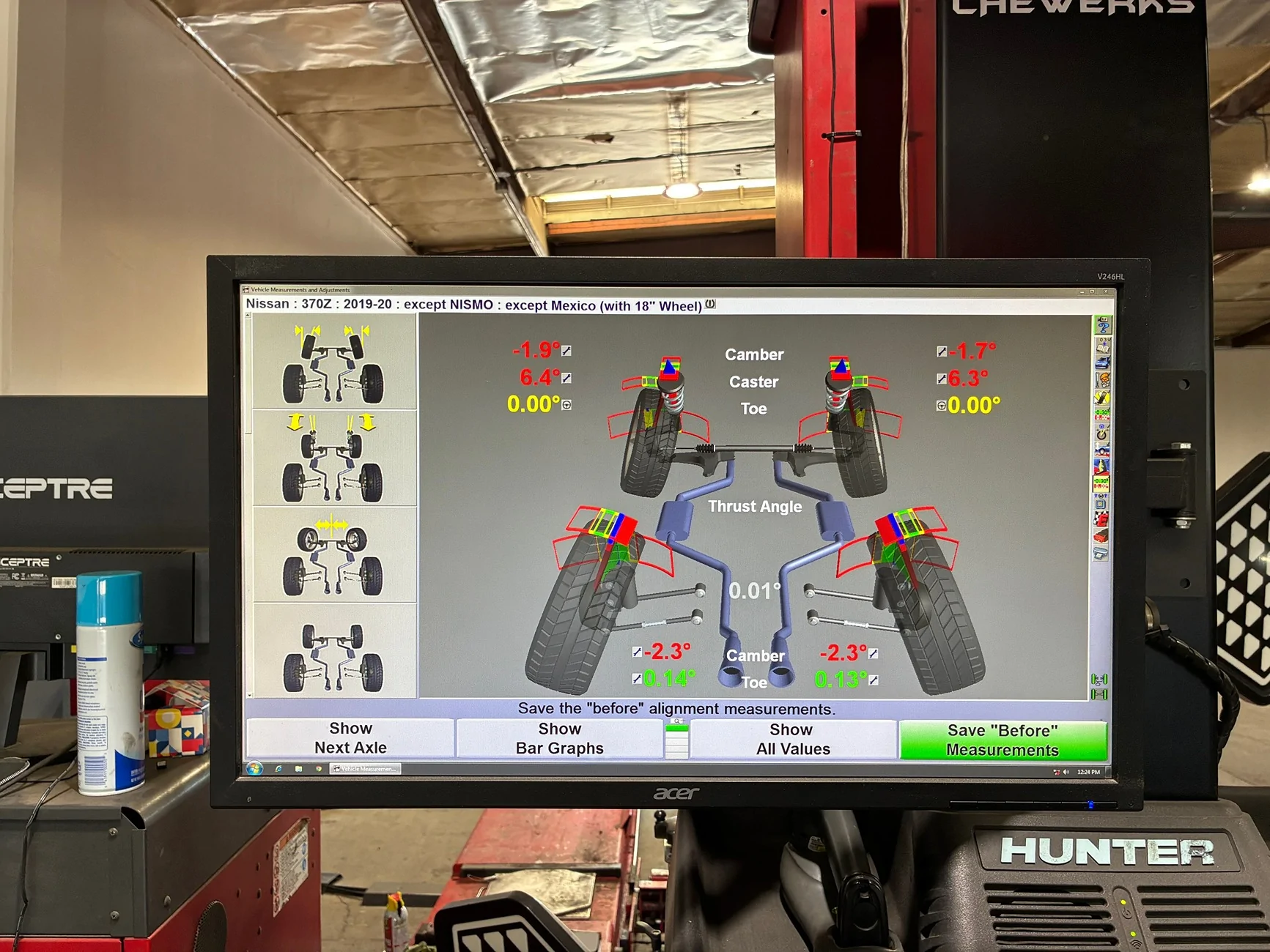

thanks for all the feedback. After the installation on my Z:
FRONT Drop of 25mm (1") and REAR drop 32mm (1.25")
Right now my specs are:
FRONT: Toe at 0; Camber -1.5 Right, -1.8 Left
REAR: Toe at 0.5degree; Camber -3 Right, -2.9 Left
What is the best way, without changing every part of the suspension, to keep the inner tread from wearing out? I dont mind if its off by a bit, just dont want to invest a ton of $ and time changing out all the parts.
Or do you think a good alignment will be OK?

I don’t think you understand why I recommended new parts:
there is no front camber adjustment from the factory
sorry
dont get mad at me, be mad at Nissan
rears have eccentric bolts with a range of…half a degree?
again, blame Nissan
if you wanna be low, you need arms

OK, here is what could be done, a very reputable local alignment shop's laser alignment. I'm on just Swift Spec-R springs, stock arms, shocks, etc. for now, about 1.1" to 1.2" drop per the spring specs. The recommended rear camber was reduced slightly on negative, toe was still w/in range, no problems with the stock eccentrics. Per their experience this will balance out the handling.
