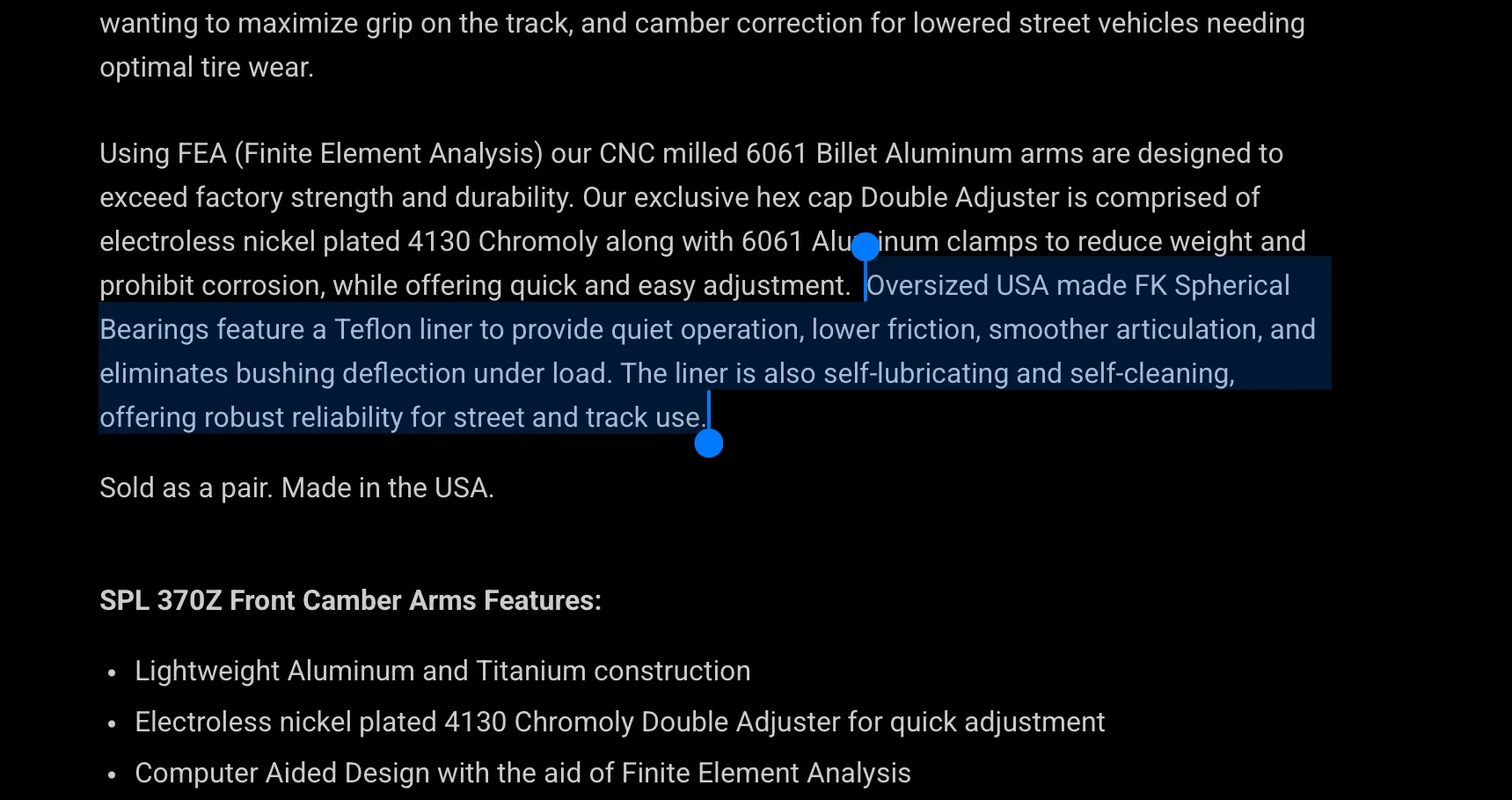

Unless you are particularly sensitive to nvh/firmness i dont think you’lll be bothered by it. Ive run them on every car ive ever had: s14, is300, z34. Never had an issues on the street
You already have a sports car with a sports car ride, the way I’d describe the change to spherical is “connectedness”. By their nature factory bushings are meant to squish a bit (of course there are levels depending on the rubber used)
Your coilover springs rates and damping, plus tire sizes have far greater effect than spherical joints on streetability. Properly selected dampers should absorb bumps so there is no jarring up/down movements. Running lower profile 20 inch tires will be worse than 18s in the same overall diameter.
dont take my word for it, this is from SPLparts website:

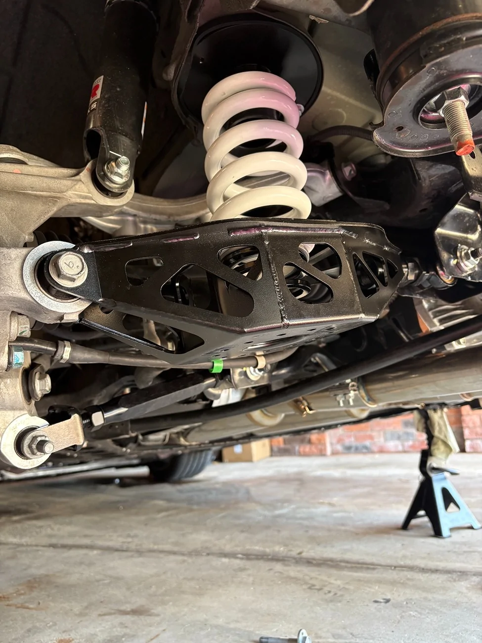

I ended up going with some parts from a local aussie brand gktech - camber arms, adjustable toe spring buckets, and two eccentric delete kits.
The toe buckets aren't as sexy (or expensive) as the nismo or SPL ones, but they play nice with the HKS springs while also allowing me to run any 2.5" ID spring down the track. Now I just need to take it back to the alignment shop.
