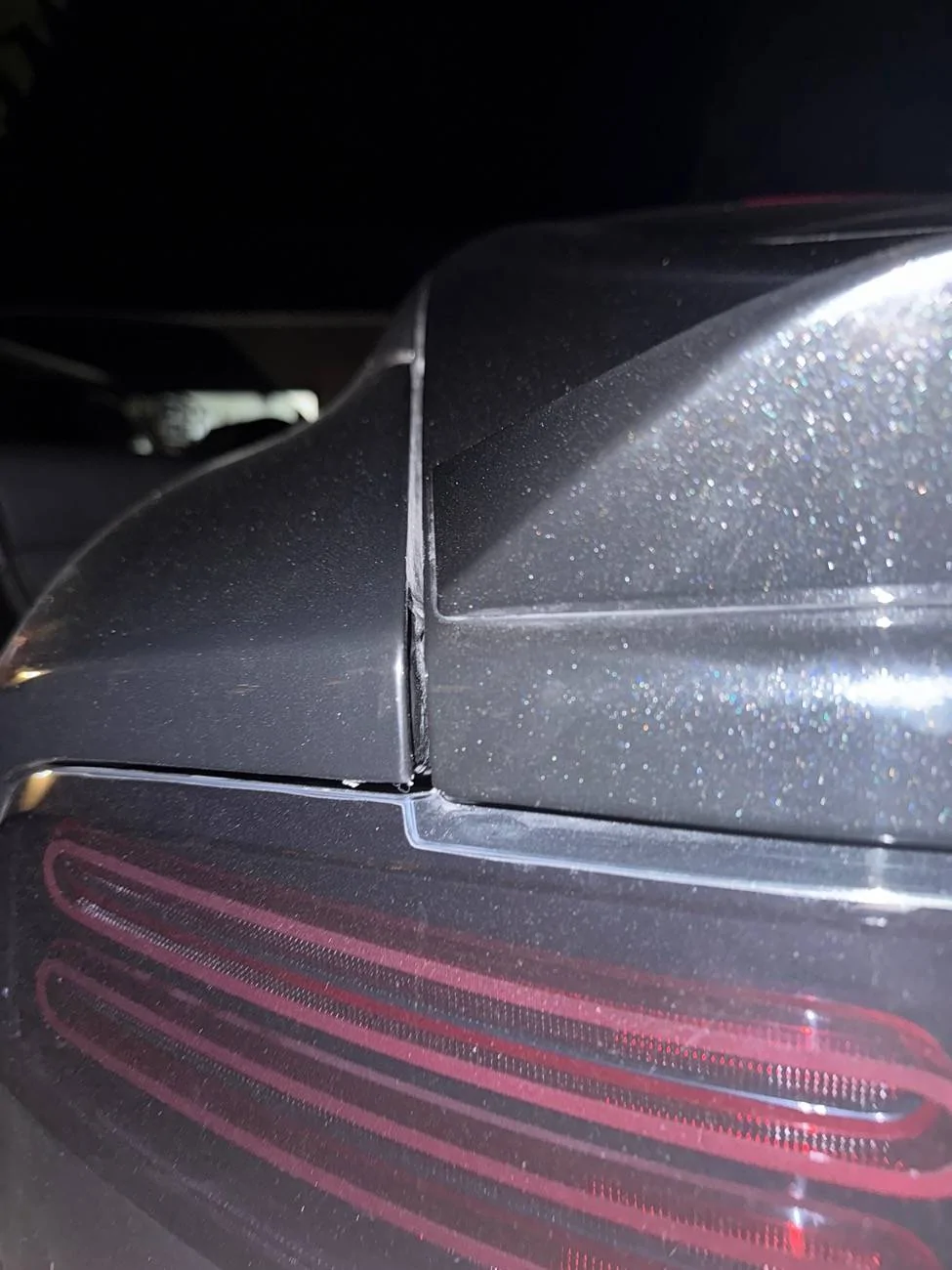

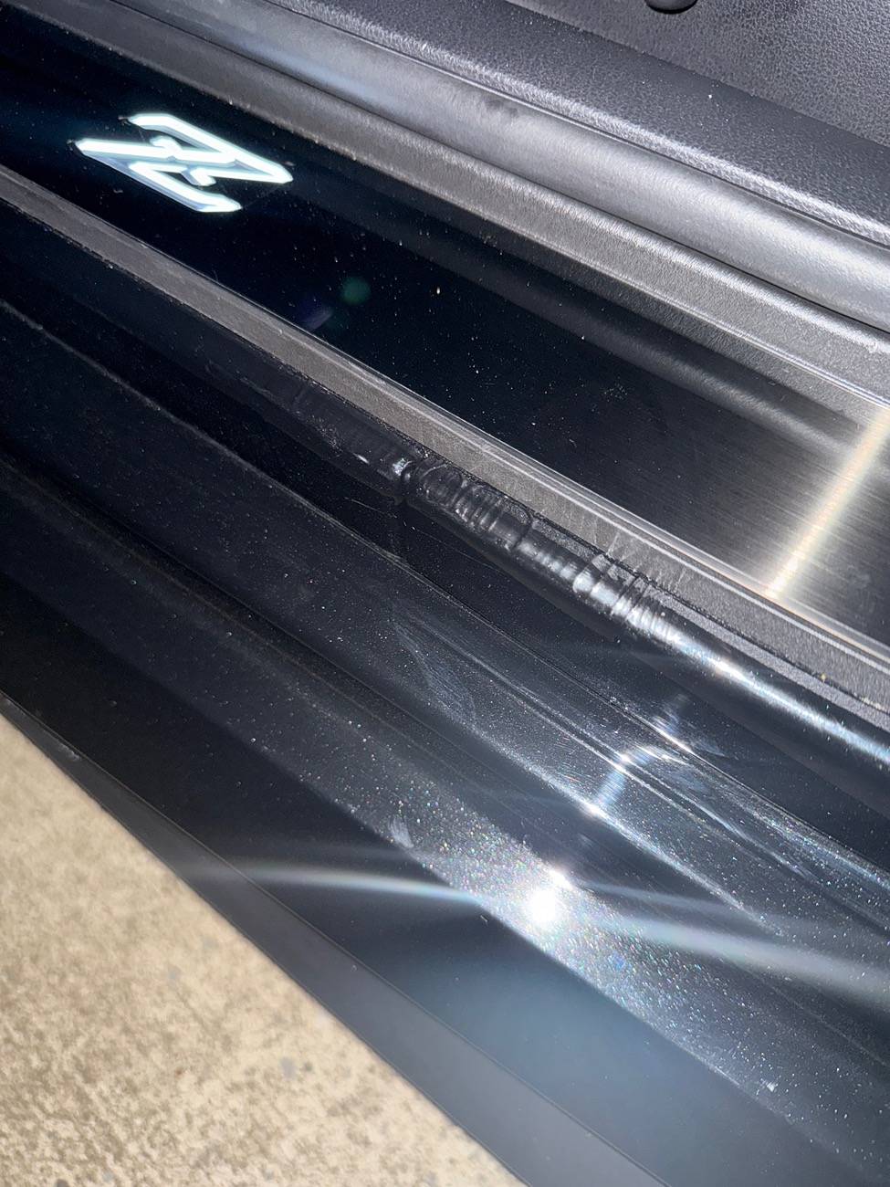

UPDATE: I finally received my car back on April 24th. First thing I noticed was that the steering is pulling to the left and the left front is clicking in relation to speed. I am thinking it is the wheel bearing. Could anyone give me any tips? I legitimately can not take it back to the dealership. My car already smells like pungent body odor of the service technician who worked on my car for 16 weeks.. I will attach pictures of the repair. This is minus the car (possibly) having a bad wheel bearing that I will have to replace because they somehow did not recognize it.. check out this work coming out of Victory Nissan of Nashville. Also, they blocked me from reviewing after I left a negative review on all forms. Google and Facebook. I think that yelp does not let them do this so my review actually went through with the most recent update.. I have a backup google account that I used to post the most recent update, but it won’t show up if I use my main account.. check out this work. I’m at a loss for words for what I even do at this point.
I can’t speak for the mechanical issues in any detail,, given the info I have. I can say a wheel bearing replacement is straight-forward. It does make me worry about other hidden suspension damage, though. Especially as it is pulling Left.
I’ve studied ACRT (Auto Collision Repair Tech) and this is a total “hack job”. Seam sealer is being used to (maybe) hide a poor repair. Take it to your insurance adjuster and ask for a report saying the mechanic suspension work & the “body panel fit & finish” on the repair is sub-par & is completely unacceptable (to them/you) !
Then - File a “customer complaint” against the Dealership that passed this work with the Nissan Regional Manager for your area. Offer to Provide them with the report above, from your insurance repair expert. If this goes nowhere, ask to be sent to another Nissan Dearlership’s Service Dept to inspect the Repair, and report back to him if they would find it acceptable. Raise holy hell with the Regional Manager to get this addressed. As you are aware- this is unacceptable.
I’m Sorry you will have to go through all this, but imho Nissan (should/will) make it right.
I appreciate all the advice and replies! Unfortunately, my only options were places like caliber collision (who I’ve had issues with in the past before they were rebranded from Price’s) where the exact same thing that happened at this dealership occurred there too. or dealership for body work repairs. I wish there were more independent shops, but in the Nashville area I was having trouble finding a good reputable one.
I actually had a case open with the regional manager from about March 20th on the repair, and it just recently got closed. I ended up replacing the wheel bearing myself and taking it to Firestone for the alignment. I was eventually reimbursed by the regional manager for the wheel bearing and the alignment. Which was very nice of her, and it helped ease my nerves regarding this whole thing.
Everything is great with it now except for the inner seam is still rippled like that as well as the seams along the trunk being slightly off. the body shop who did the work is trying to get me to come back so they can fix it, but it will need a respray and “an adjustment in the hatch latch” I don’t want to leave my car with them for another week.
