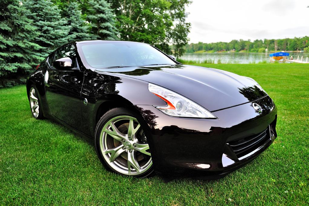

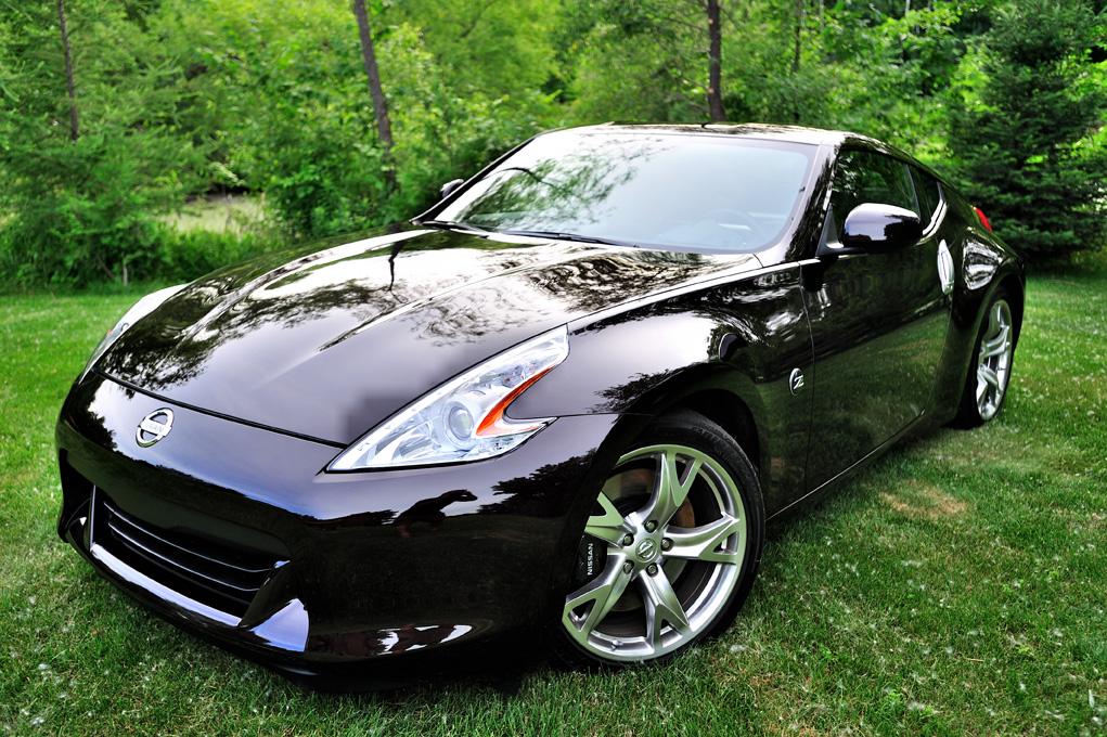

Me exactly, but mostly Adams. In fact...back in the day, my Black Cherry 2011 370Z was the car on the webpage header at the Adams home page for a few months. I'm a Junkman adherent.
I have a Flex polisher but almost entirely rely on the good ol' Porter Cable for a small car like the Z. For day-to-day washing, I do hit the local convenience store touchless car wash (confess that I've gotten lazy) but never anything with brushes. On any given nice Saturday however it's the good old two bucket wash for me with the foam cannon, pressure washer,clay bar, real carnauba, and the two-motor Master Blaster.

Good looking Z
Do you use a Flex Orbital or Rotary. What sizes do you have for a small car? Im looking to start this new hobby

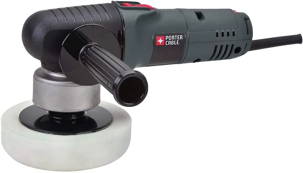

I have a Flex Orbital, but it's aggressive enough that it will burn the paint if you're not careful. I almost entirely use the good ol' 6 inch Porter Cable 7424 on a small car like the Z. Almost impossible to damage the paint.

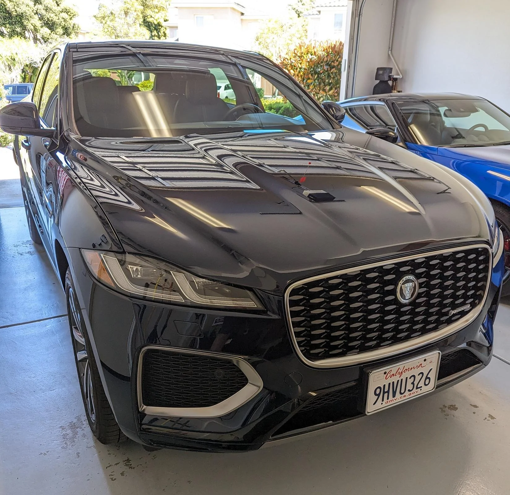

I had my car paint corrected and ceramic coated at https://cedetail.com/. They did a great job, and I'd highly recommend them if you live here in San Diego.
I'm following the recommendation of the detailer for washing. I hand wash in my garage with
This wash https://www.amazon.com/Optimum-NR2010Q-Rinse-Wash-Shine/dp/B00DB3OEOQ/
This sponge https://www.amazon.com/dp/B078DPCYFV?ref_=cm_sw_r_apin_dp_Y0EGFHJE3PX07TGFDBMD
5 or 6 of these towels (per wash): https://www.amazon.com/dp/B07Q6PLX4V?ref_=cm_sw_r_apin_dp_NJGKXKKQN7AVKSE9BGCK
I follow the instructions on the bottle to wash and dry a section at a time. I keep the sections pretty small (half the hood, half the hatch, a door, etc.) so that the wash doesn't dry before using the towel. The key, I think, is changing towels often. Yesterday I washed both cars using 8 towels.
I use the same thing to wash the wheels and tires. The tires get clean, but not glossy.
For the windows, I follow this procedure:
When I'm all done, I mop up the few drops and drips that make it to the garage floor.
My wife's Jag gets the same treatment.
I must say that there's a bit of danger using this method. I'm somewhat addicted to how clean the car is after a wash, and now I'm washing her about once a week. After a week, the layer of dust starts to get on my nerves, and I need to wash her again. Beware.

I use Adams polishing pads...same pads for both Flex and Porter Cable...6 in diameter velcro backing. There's been a substantial evolution in pads over the last 12 years. I don't know if the technology is better or if they keep changing so people will buy the new ones. I seriously doubt that any one particular quality brand pad is better than another, and 6 inch velcro pads from all the detailing companies are common. I haven't bothered to buy very many new pads. I wash the pads in the washing machine, which works fine, but I do it while my wife is out and don't mention it. Still using some pads from years ago. For smaller areas or focused deep scratches, I use similar pads 4 inches in a cordless drill, but only rarely have I seen the need for that. I haven't polished my 2024 Performance Z yet so don't know the various nooks and crannies.
There are a lot of random orbital polishers out there now and I confess that I've been looking hard at the 18volt Milwaukee even though there are lighter and sleeker new polishers out there. I haven't pulled the trigger because, really, that Porter Cable is really good utterly reliable, and completely safe for the paint. I do have the Flex Orbital polisher. Its advantage is that it's really fast, but a moment's inattention will burn the paint. Not worth it to me and I've relegated that Flex polisher to sanding wood. It excels at that.
