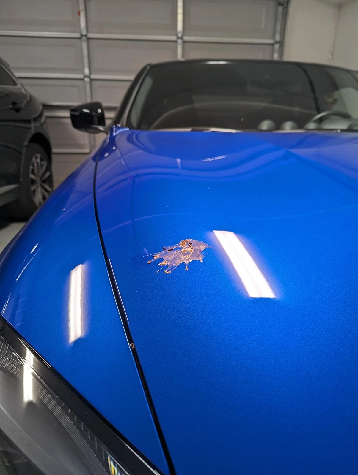

Looks like you got caught in a bombing run. LOL I take water and a soft cloth with a little car wash liquid and gently rub it off. Use a lot of water. I do the same thing two or three times and then just take clear water and wash off any soap or other residue drying with a microfiber or other type soft towel. No need to wash the entire car unless you just want to.

ihe insects have been brutal this year. what are you guys using to get the bug guts off?
My cars have clear bra on the forward edges...I spray with bug spray, then foam soap, let it sit, then use a pressure washer., followed by Rejex to minimize subsequent adherence. If they're really bad, I scrub down the clear bra with some Plexus or similar plastic cleaner. IMHO, the Rejex is the main key. I like Rejex because it seems to last longer than waxes. There are probably other polymer sealants that would work just as well.
Bug splatters are a major nuisance on an airplane. On mine I use Mother's Foaming bug wash, let it sit a minute or two, then wipe off with a wet cloth, followed by wiping down the leading edges, forward cowl, and propeller with Rejex to minimize subsequent bug guts adherence. No pressure washers on airplanes.
Like most automotive chemicals, brand choice is driven almost entirely by marketing, not merit. IMHO, there is no magic bug removing chemical that's better than another. If there was, that's what everyone would use and there wouldn't be a thousand such chemicals on the shelves at any given auto store. I've found the keys to be:
  • don't let the dead bugs sit...they will etch the clear coat
  • protection is key
    • clear bra
    • Rejex or some similar polymer sealant
CarPro bugout, spray area, let dwell a little, microfiber agitation if needed, rinse off.
Typically doing this as part of a prewash before a foam canon and one bucket method.

I hand wash my Z and use only Adam’s products - Adam’s Mega Foam car wash applied with an Adam’s Foam Cannon for the body and wheels, a simple garden hose rinse, and then an Adam’s Air Cannon Jr. for drying with warm, clean air and their microfiber drying towels where needed. I hand apply and polish/shine the entire car with Adam’s Ceramic w/Graphene coating once a year, and honestly, with the ceramic I could just rinse and dry it with little to no Mega Foam and it looks brand new every time. Highly recommend all of Adam’s products - I was new to them last year when I got my Z, but could not be happier with the quality and performance of all their stuff!
how often are you doing this?
Rarely.
I typically do a foam canon / one bucket wash every 2-3 weeks depending on drive time
After a drive, I do impromptu spot treatment depending on the area, with just diluted CarPro ECHO. This can be used for bugs as well
If it is a bad spot with bugs, I use bugout with a MF and spot spray with water and wipe it down with ECHO
Every 2 months I do a more thorough de contamination with iron x / tar before a full wash
Having these various schedules keeps the car quite clean, like a short / medium / long term detailing schedule.
