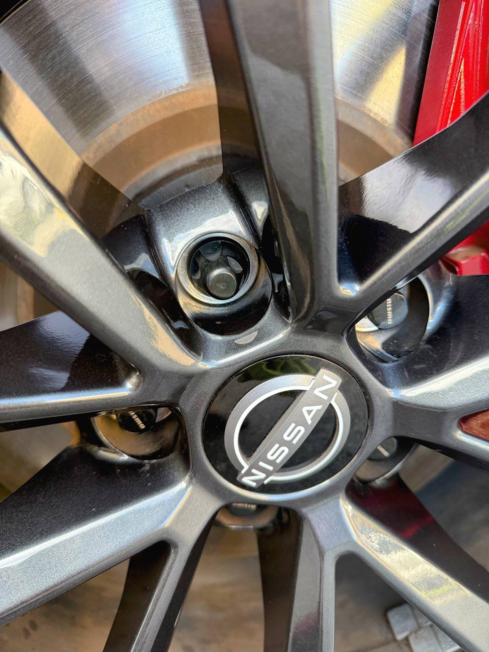

the OEM wheel locks are trash. I paid $175 for these which is almost impossible to remove them

Not sure if those NISMO lug nuts are mag/shank. And I say that only because I have not found NISMO lug nuts that are mag/shank.
If the info in this thread is correct (other than almost everything I said) then those may not be the right lug nuts for those wheels. Did some digging last night and the interwebs is all over the place with this, but the lug nuts on my Z are clearly mag/shank, and I didn't see anyone/anything say that conical seat lug nuts were OK to use in any application designed for mag/shank style.

I just got in a set of the Nissan wheel locks and they worked fine on my 2024 Performance. I was able to get a new set on eBay for a little under $60. Surprised the Z didn’t come with them stock.
FYI, they are tapered and identical to the stock nuts minus the key print on the outside. They do NOT look like the nuts in that parts listing.

Nope. The Nissan ones I bought look just like the originals on the car which is to say they have a washer built in and a conical body to mate perfectly with the wheel. The only difference being the machining to mate with the removal tool. Mine were not a part identified for the Z but for a Pathfinder which coincidentally uses the same nuts as the Z.

I think manufacturers like mag shank style because their wheels are specifically made for the vehicle/hubs, which center the wheel. Aftermarket is pretty much all conical, I assume to keep them from having to machine individual wheels for different hub diameters. I’ve always used hub centric rings with aftermarket wheels. Not sure if that’s mandatory, or suggested, or what.
