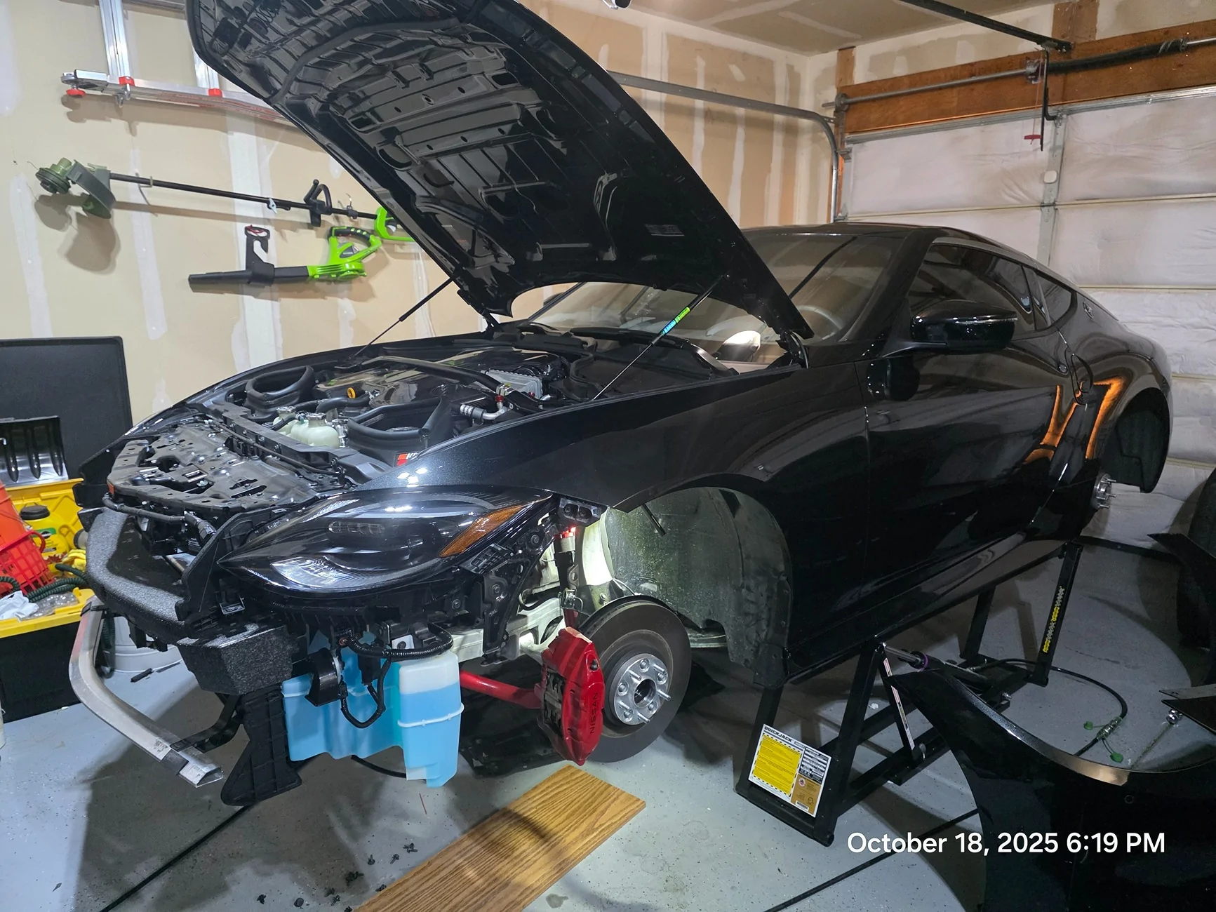

Installed B6A resonated lower downpipes and Z1 performance heat exchanger. Waiting on my level 2 map update from Z1.
How was the heat exchanger install? It's obviously very involved, but was it pretty straight forward, or did you run into things that were a complete pain?

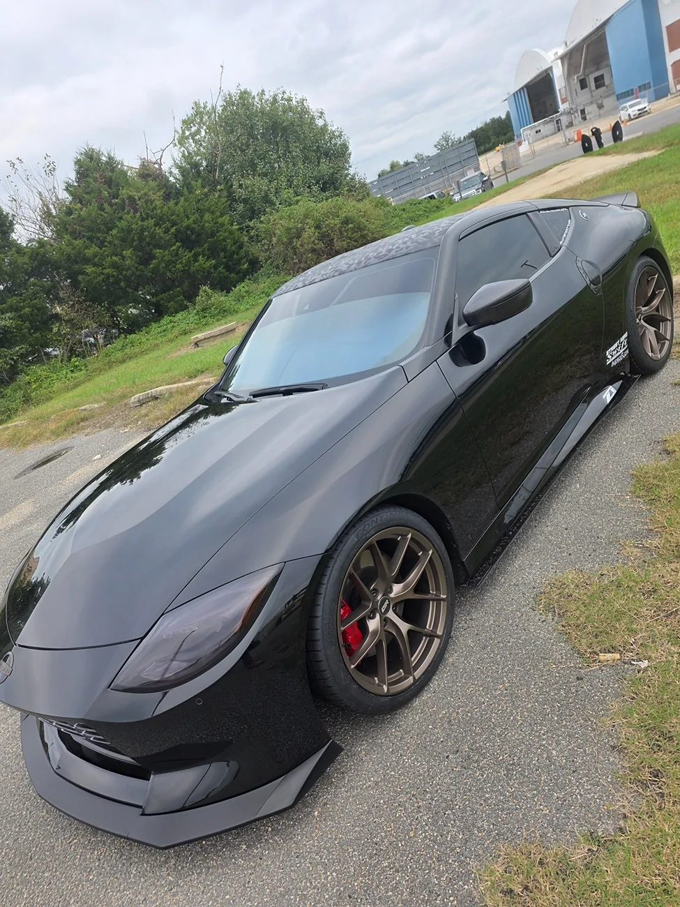

Man ok fam where do I begin. Since the last time I posted i have added a few things. OK first is the aero flow dynamics front lip. Second I added the street aero side skirts. And last a set of ESR wheels wrapped in Continental DWS 06+. 265/35 front and 285/35 rear. Really love how the Z is coming together.
Looks great! What offsets did you go with on the wheels?
Its intimidating but easy, just take your time. No real pain points with the install itself. The biggest thing that helped me was purchasing a vacuum coolant refill kit. It makes bleeding the system foolproof and saves a ton of hassle with potential air pockets in the system.
I went with +22 both front and rear. I wish I had done a different offset for the rear. I am gonna throw a 5mm spacer on and see if that brings it out. The front is perfect tho.
Thanks! I’m considering the Nismo LM-RS1s and trying to figure out offset. Thinking of going with 19x9.5+22 up front and 19x10.5+22 in the rear, but considering +12 in the rear. Gonna run 285s in the rear.
Dunno if this helps or not but I've been looking at the same wheels in the last few days and saw these 2 threads, so maybe the pics will help since one guy is running +12 and the other +22
