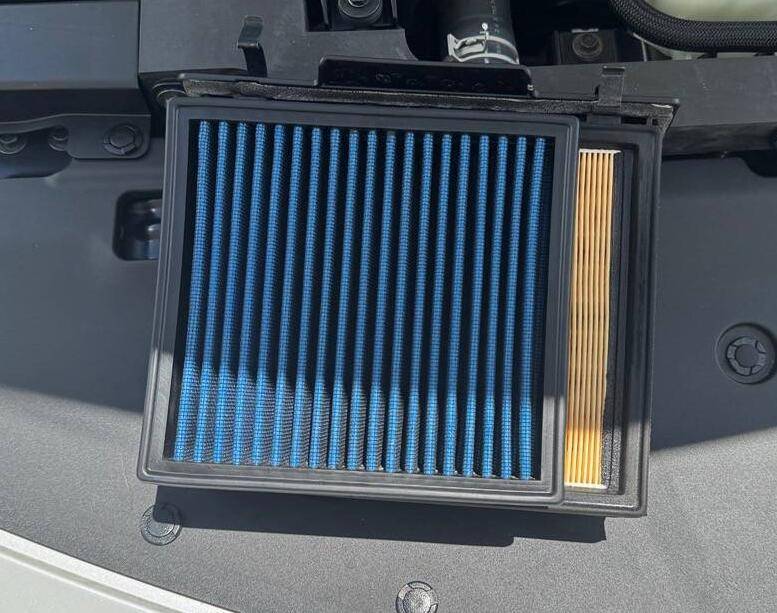

So my Z1 filters came today and I was disappointed to learn that the Nismo Z doesn’t have the same size filter as the other VR30’s. It’s a bit wider. I didn’t want to do any of the intakes because all I’ve read is stressful stories of the install.
