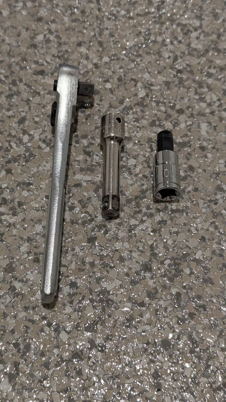

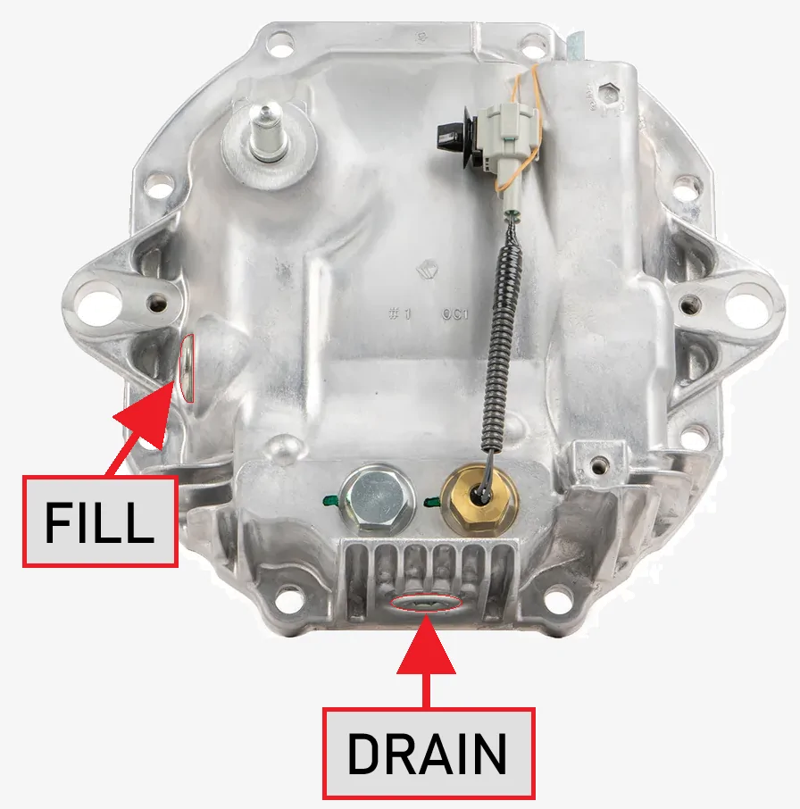

Having trouble getting the fill plug off. Do you have a limited slip? How'd you fit a wrench around the fill port
I have a Performance w/LSD. If you're trying to use a wrench, you're on the wrong bolt. It's a 10mm hex on the driver's side. You'll need a 3/8" ratchet, extension, and 10mm hex bit (same as the drain).
Oh, drivers side. I thought it was on the rear. There are no diff fluid change videos for the RZ34 on YT, and the 370z diff was different enough to throw me off.
