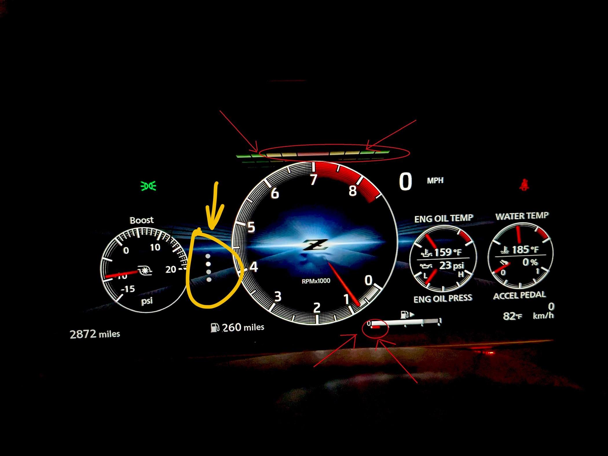

I RTFM, but it focuses on the "standard" dash layout.
Can anyone tell me what these are? (SEE MS PAINT with little circles and arrows.)
- The long stripe at the top.
- The tiny red line UNDER the fuel level.

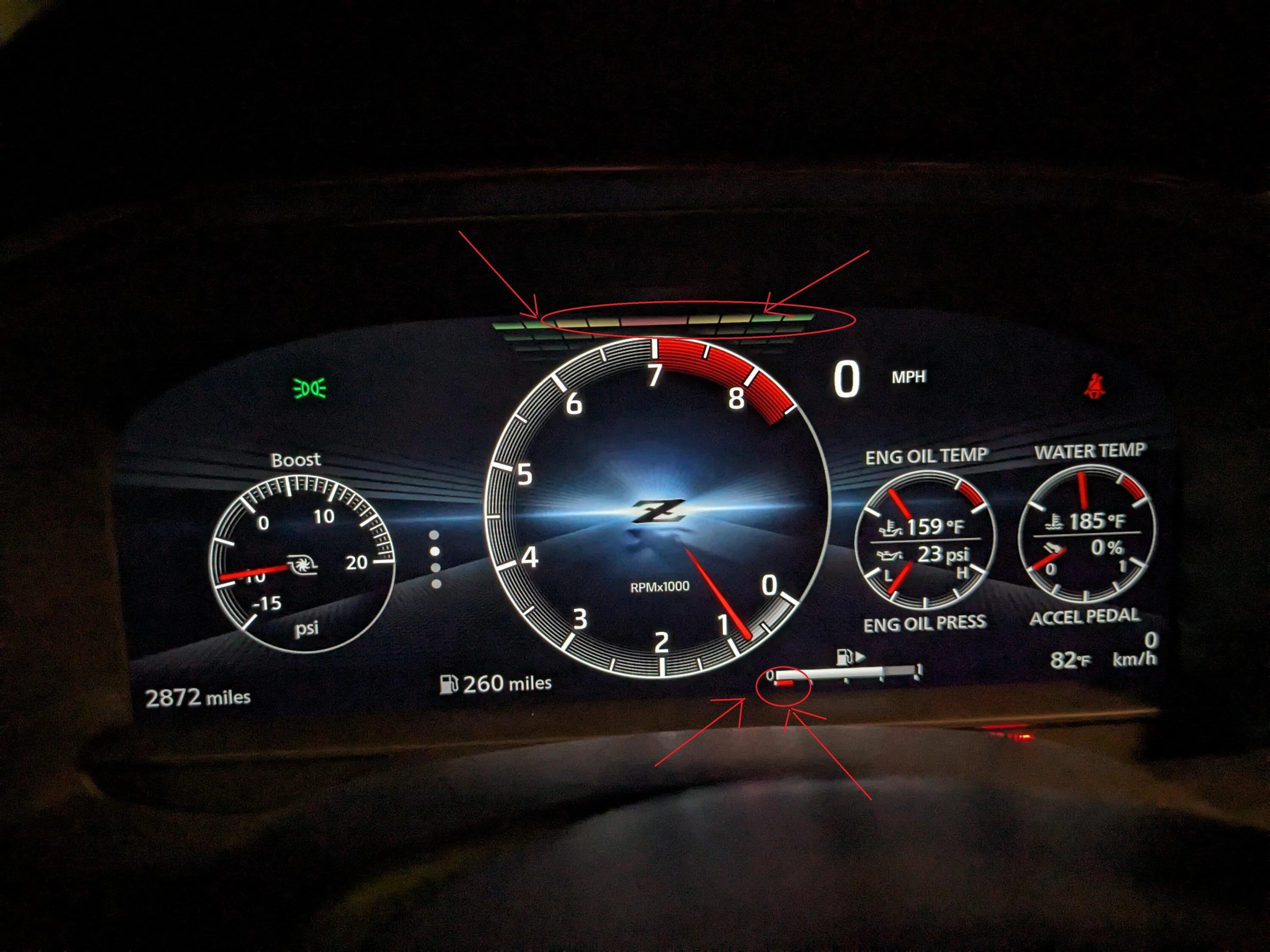

The long stripe is like an F1 style meter for when you use manual mode like a rev meter. Not sure about the red line under the fuel level.

shift light at the top. you can configure it by changing your boost gauge on the left in this pic to upshift indicator.
red line below fuel gauge tells you when the warning light will be coming on.

How about the 4 vertical dots between the boost gauge and the tach display?
148
2,808
4,854
those are the tire pressure G force and settings that you scroll up and down with the wheel on the left side of your steering wheel

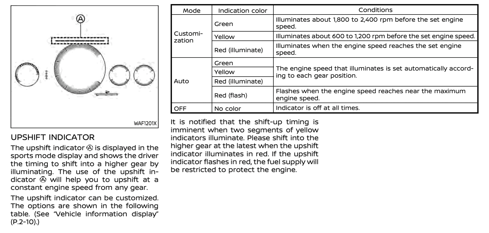

I went back to re-read the (2023) manual on this. It's really quite obscure. With such a functional dash, one might think Nissan would devote more space to explaining it. In an entirely different section of the manual than the section that talks about the dash, there's a pretty good description of the upshift indicator. Not sure if you saw that.
