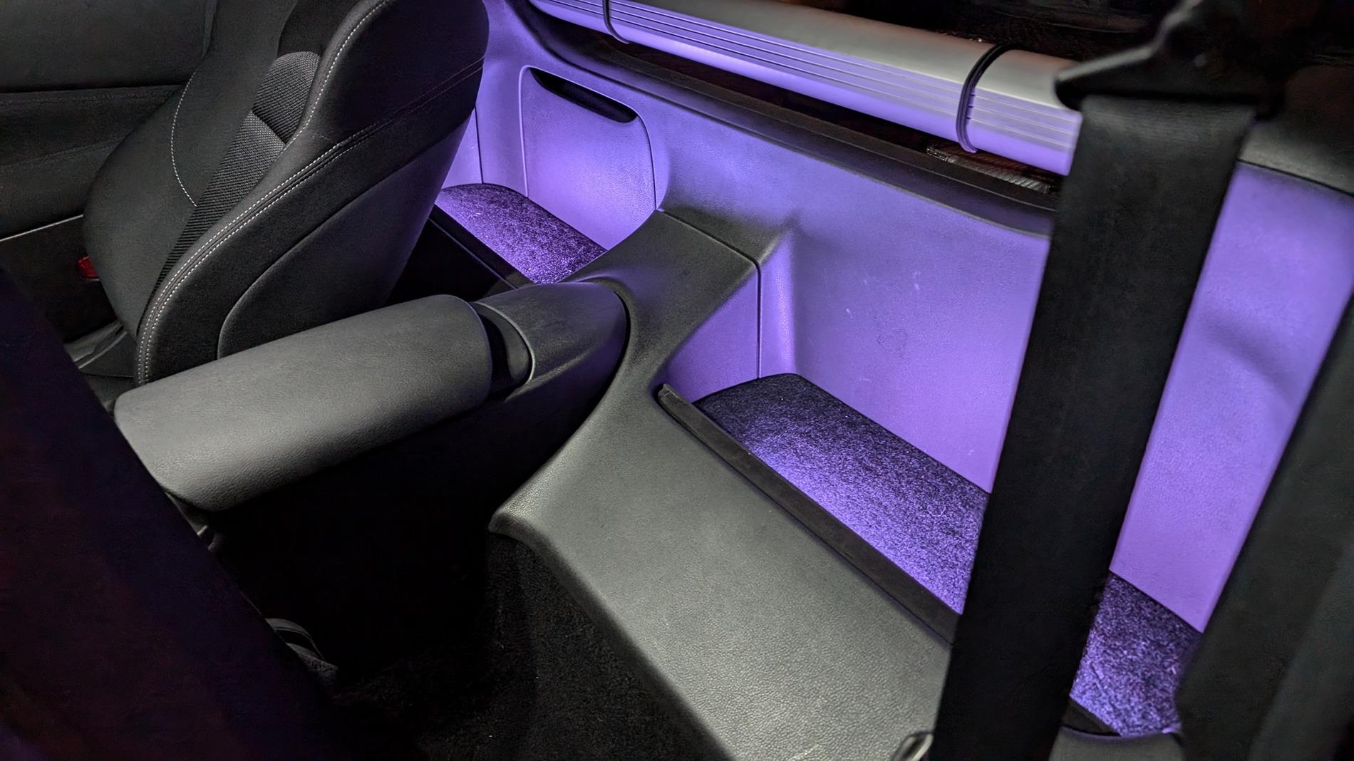

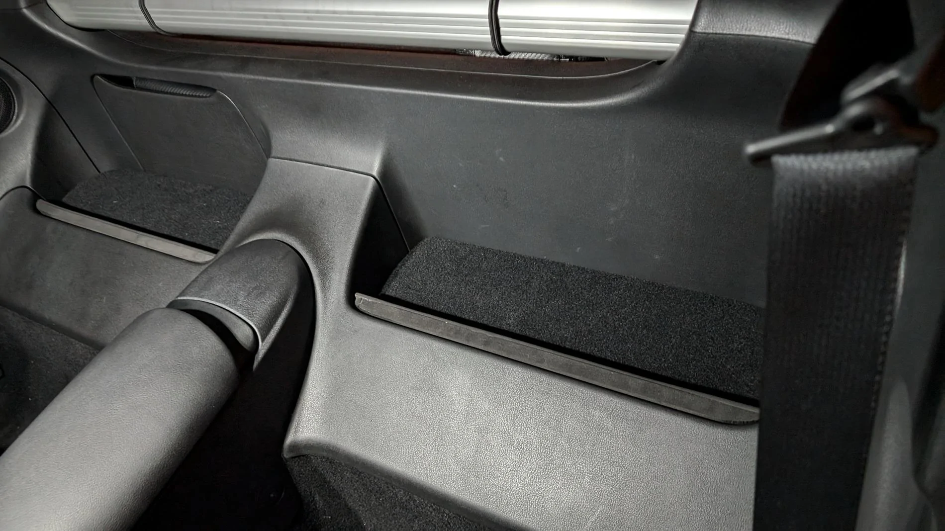

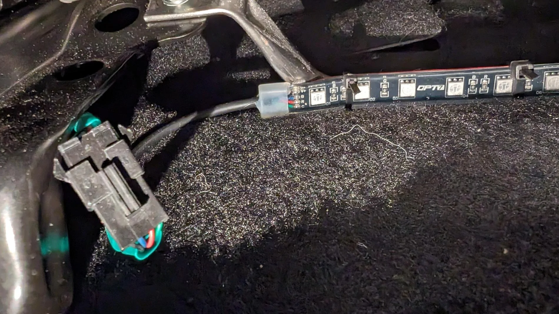

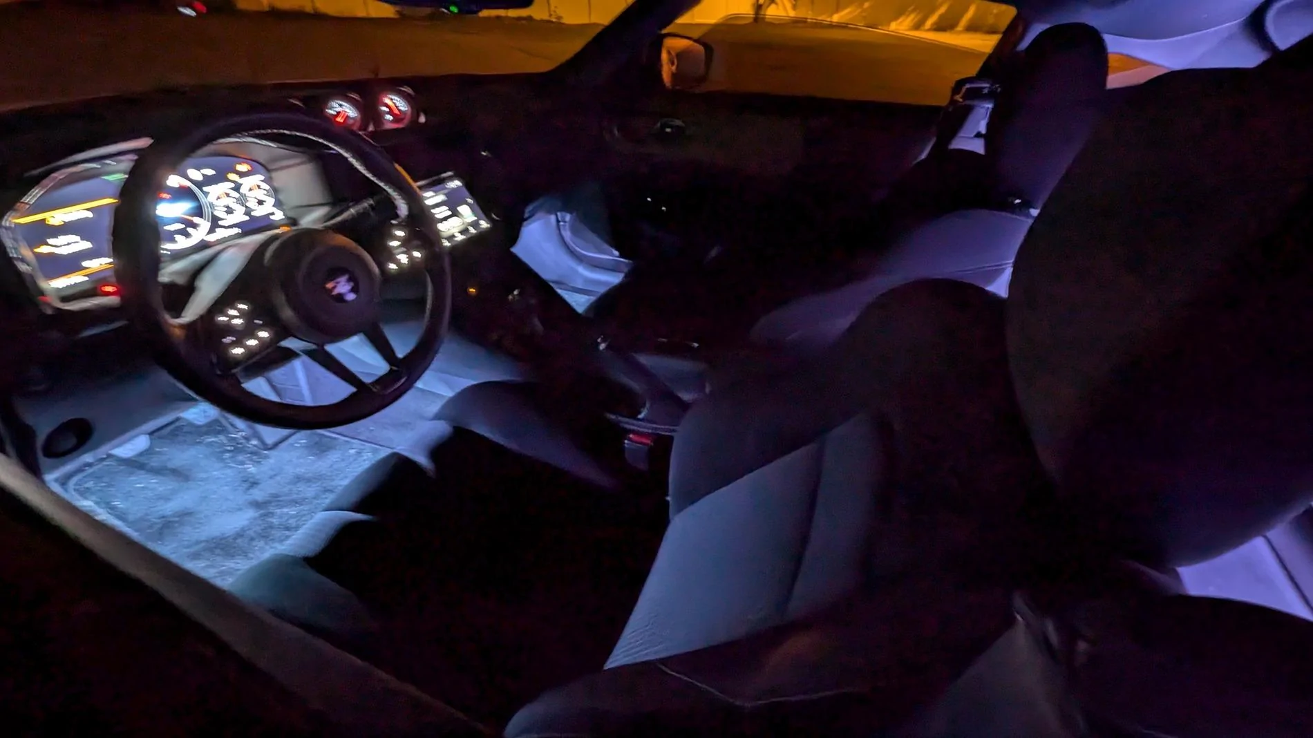

A while back I installed these interior lights from opt7. It is a very simple modification that can be plugged into the cigarette adapter or fuse box.
Ckynus
Ckynus
Jul 5, 2022
137
226
New Jersey
2023 Z
Film

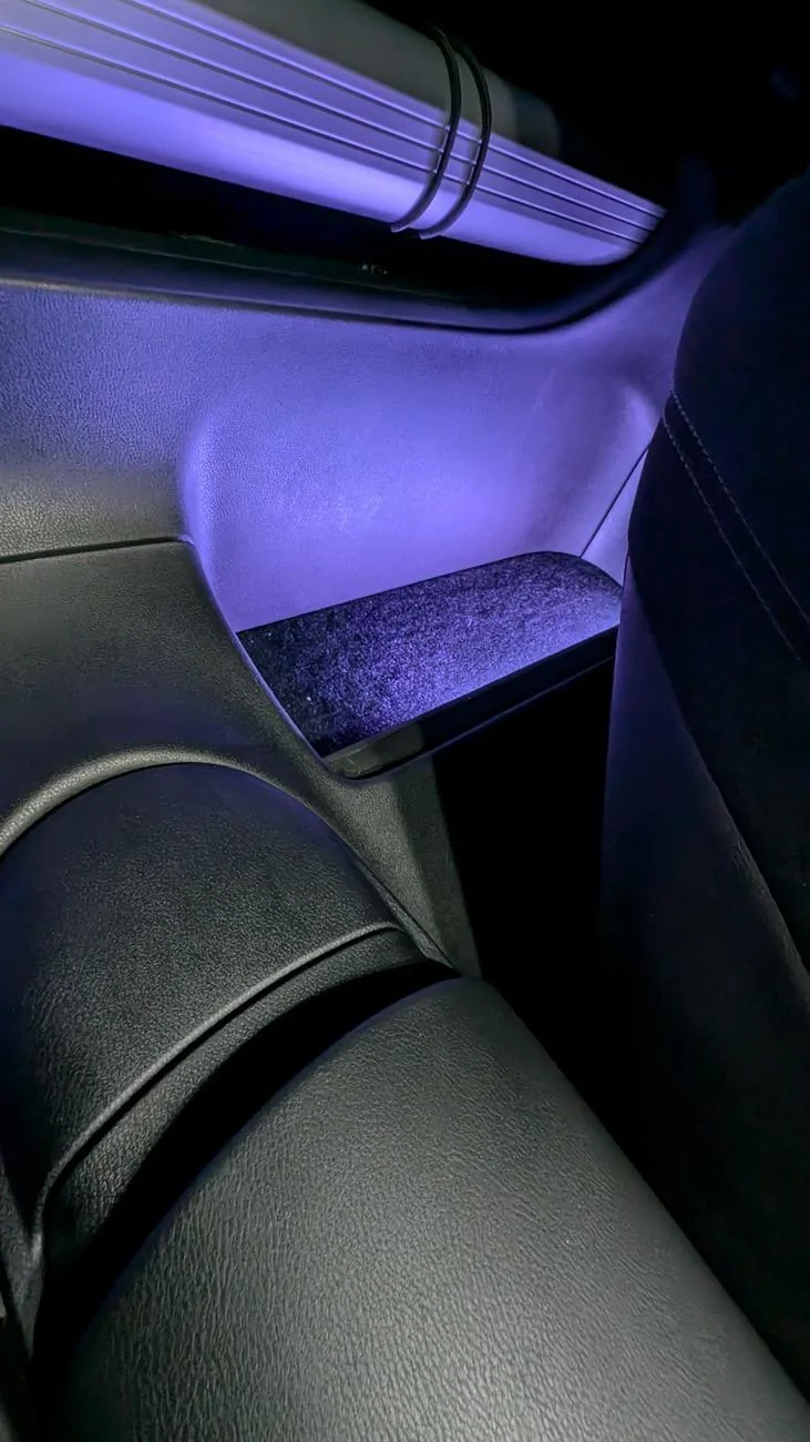

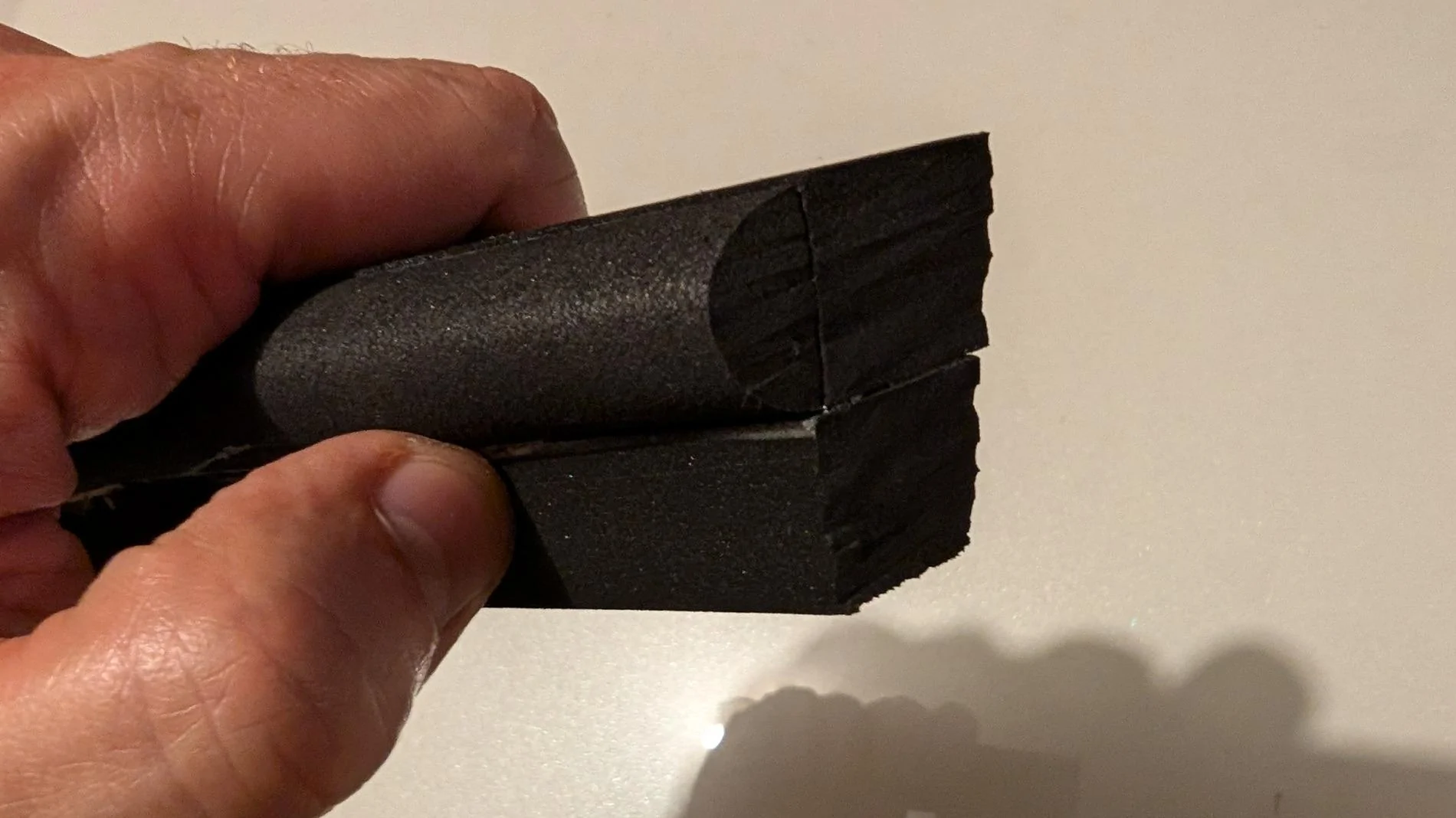

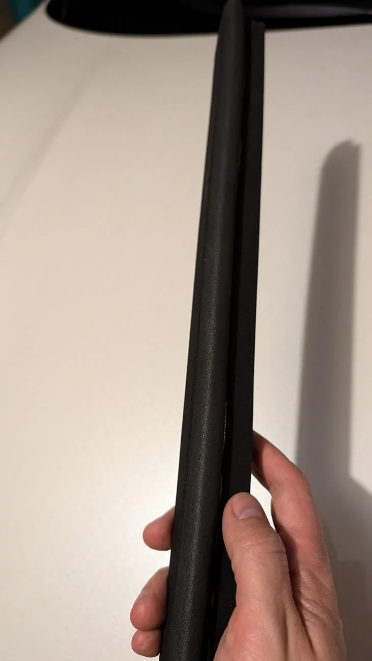

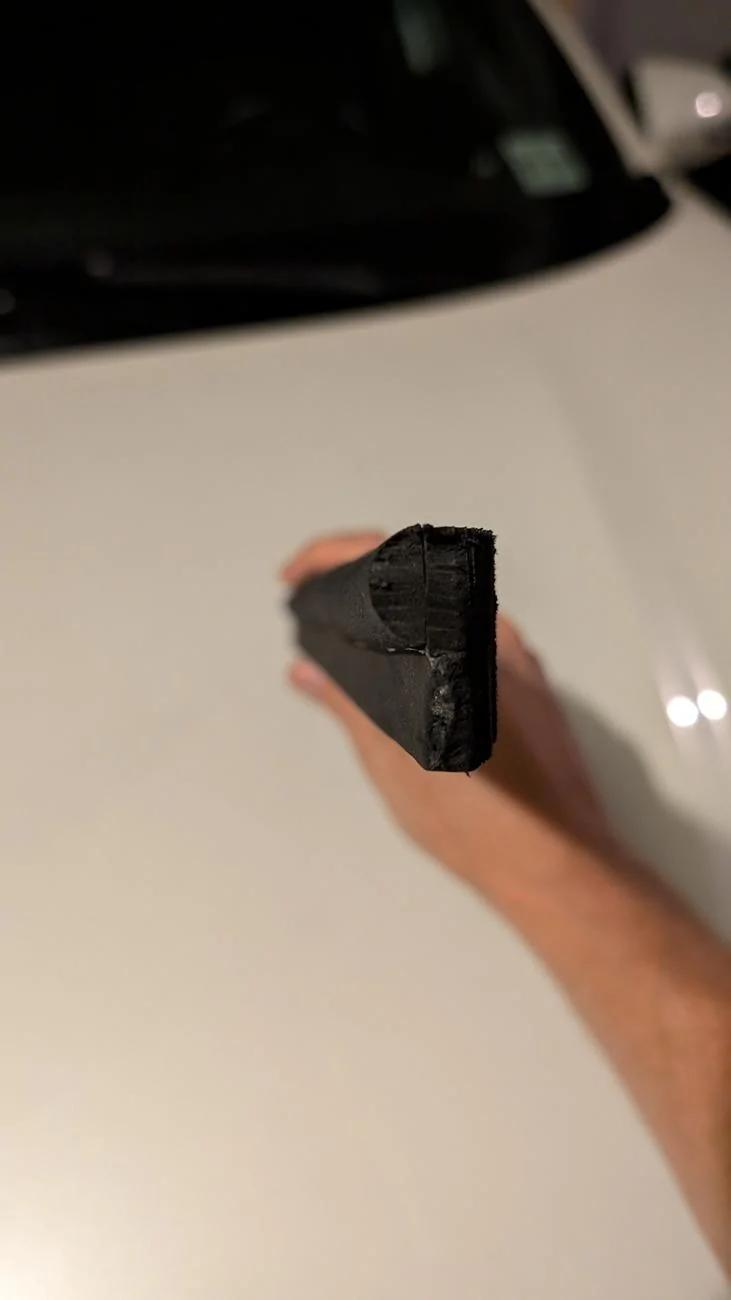

I am very much into cleanliness and cable management. So I did not like the idea of exposed lights. The one different thing I wanted to share was that I fabricated a little lip to hide the LED strips. This small insert is attached by velcro to the shelf behind the seats and covers the light fixture. It allows the light to bounce and illuminate the back of the car but hides the light source from view.

I’m not a fan of working into my fuse box, but I also don’t want wires exposed can it be hard wired to the wires behind the power outlet?
Also, did you just make the cover out of foam? Where did you get it?

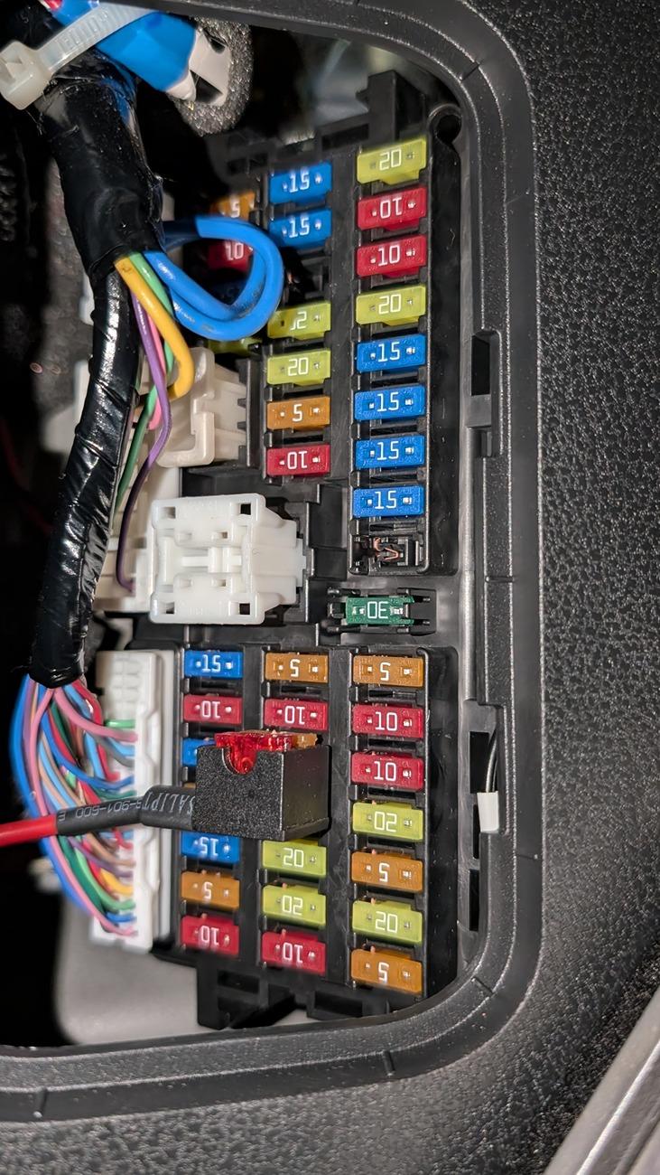

In addition to being out of sight the other benefit of piggybacking off a fuse gives me the on/off behavior of the fuse. So if you were to hard wire it behind an outlet I think it would be always getting power and you would need a switch to turn it off.
And yes I made them out of EVA foam. It is really easy to work with and inexpensive. I originally planned to then wrap the piece in a polyester felt and match the carpeting but I liked the look of the foam.

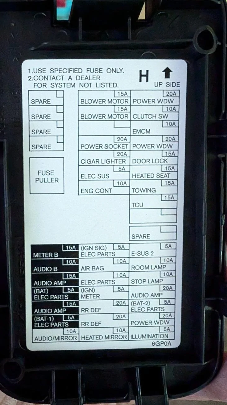

The power outlets run only when the car is on. At least the one in the console does. Have it wired to my wireless charging pad. What fuse do you have it wired to? Wonder if I could wire it so they only turn on when the headlights are on?
Ckynus
Ckynus
Jul 5, 2022
137
226
New Jersey
2023 Z
Film
Finding the fuse that worked for me was a little trial and error. I ended up using "(ign) meter." It's on when the engine is running or the car is in aux mode, but it's off otherwise.
Very nice work very clean
