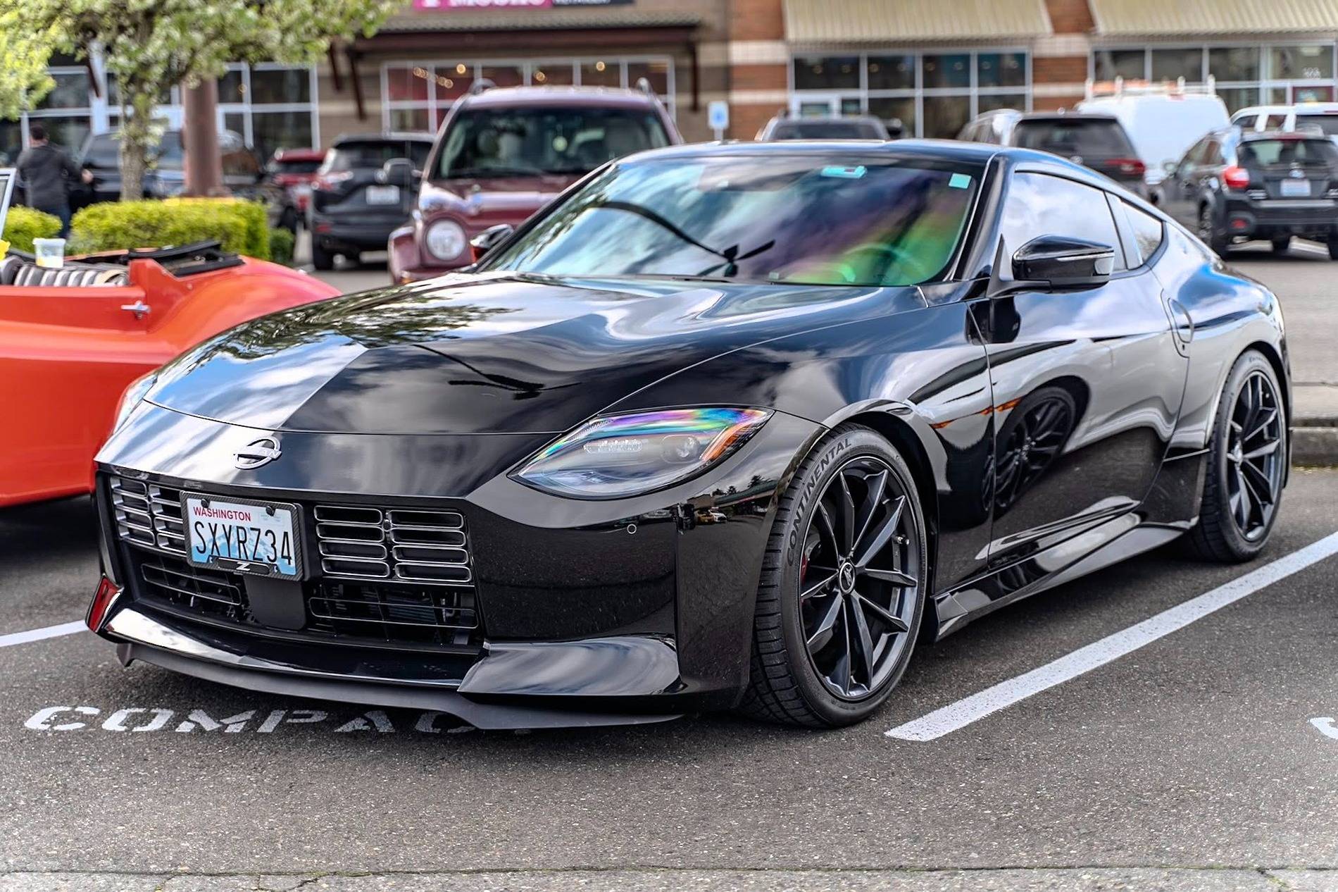

Welcome! Your list looks good. If you're going for an OEM+ look, I would suggest adding lowering springs, wheel spacers, and front splash guards as well.

those front splash guards add a nice touch! what springs are you running on your car? the stance looks perfect. any scraping?

Thanks! I'm running Swift springs with 20mm spacers all around. I opted for wider tires (265 mm front, 285 mm rear). Otherwise, I would have used 25mm spacers with the OE tires. There are these plastic air diverters (I think that's what Nissan calls them) under the bumper in front of the tires. They protrude ~2" from the bottom of the car. These items started to scrape over speed bumps and driveways after lowering the car. I think most folks remove them (3 bolts). I just used a reciprocating saw and trimmed an inch off.
