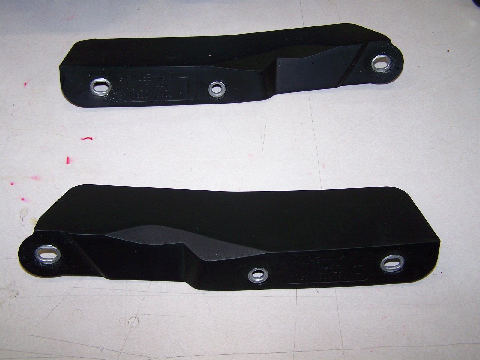

Hi all, had my 2024 Performance M/T delivered today, found the lip spoiler and these two mystery parts in the trunk. Anyone know what they are?

extra aero /deflectors they go behind the chin spoiler on each side in front of each wheel you see and L and R on them

Chin spoiler and aero deflectors not installed? Seems like your dealer is slacking.

Not going to lie, i didnt know what these were either lol. I also got a set with my Z.

It's funny how many dealers seem to fail at installing these.
Even mine only did once I asked them if it had been done and they found them in the trunk.
Is there some kinda memo they just aren't reading?

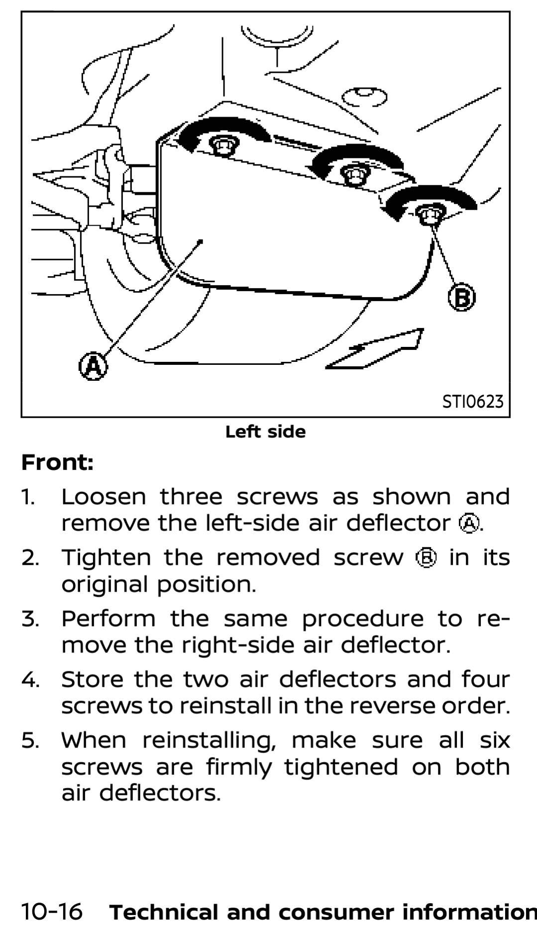

Thanks for the response guys, Anyone have a parts diagram that shows where these go?

Well done! Thank you Sir.

Installed the aero deflectors yesterday, 10 min job with 10mm socket, also installed the chin spoiler, just need a hand rivet gun, also easy, don't even have to raise the car.
