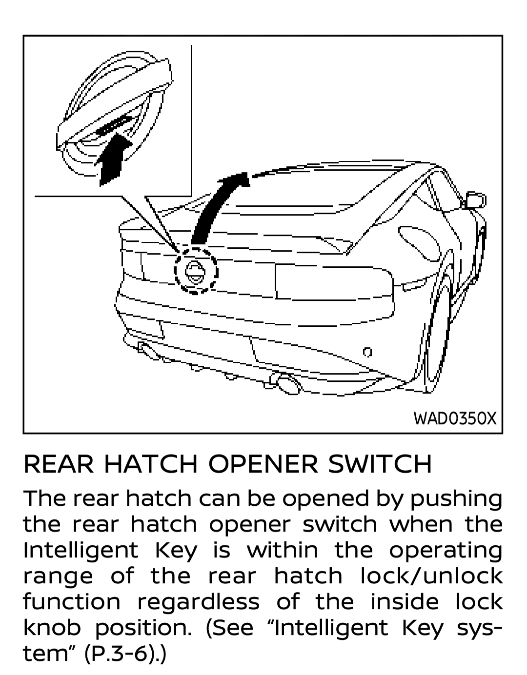

In the 370z there was a smaller button on the trunk that locked the car. It looks like that's been removed on the new Z, so now you need to lock the car with your key after you close the trunk. Am I missing something?

I don't think you're missing anything. Only one button.

A few things I noticed about the Z that I find strange (or at least different than my G37):
  • Unlocking the hatch also unlocks the doors. The G37 didn't do this, and it took some getting used to. On the G37, while the car was locked, you could open the trunk, grab something, close the trunk, and the car was just as secure as before. With the Z, if you do that, you have to lock the car again.
  • There's no hatch release on the key fob. The G37 had an open trunk button on the fob, and I used it all the time, more often than the exterior trunk release switch. I miss it.
  • The Z's interior hatch release doesn't work if the car is locked. I don't recall how the G37 worked. I think the interior trunk release on the G37 always worked. At one point, I think I had disabled unlock-on-ignition-off, the Z's switch wasn't working, and I thought it was broken.

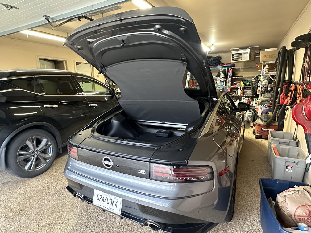

I've had a 350Z, two 370Z's and now a Z. In my experience, the rear hatch has always operated such that you push the rear release and the hatch would pop open to clear the second (safety) latch just enough to grab under the hatch and lift it up where the gas struts would take it the rest of the way. That's how those vehicles have always worked IME. With my original 2011 370Z, I bought a retractible rear hatch cover....a great convenience... but the added down force of the retract mechanism on that hatch cover prevented the release from clearing the second latch so that it did take two hand to open..one hand to push the release button and the second hand to lift the hatch. I had to put a couple of little silicone spacers on it. Online forums suggested super-gluing a nickel to the car when each spring hit the body. That wasn't a problem when I moved that hatch cover to the next 370Z...a 2014..hatch cleared just fine with one push of the button. When I got the 2024 Z, I kept that original hatch cover and it slipped into the new Z perfectly. It did add some down force to the hatch, but not enough to prevent the hatch from clearing the 2nd catch point. It certainly doesn't need extra springs, nor stiffer struts as Nissan suggests. That hatch cover is something like $500+, so I'm glad it fits.
