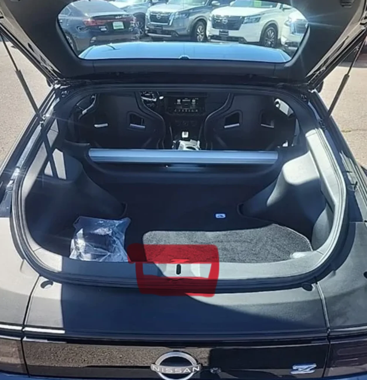

I think I've seen a discussion about this somewhere in this forum. But I want to make it official because I think that many; if not most, Z owners will face this issue.
My 24 Nismo tailgate rattles a little bit when driving over rough pavement. I took it to the dealer and they made a little adjustment. It worked but just a little bit.
The service guy acknowledged that Nissan is aware of this and is working on an "aftermarket solution". They did adjust the latch... but it doesn't fix the problem.
Two questions for those who may know the answer:
1) Do you know what that adjustment actually is and can we do it ourselves?
2) Does anyone know about this aftermarket item?
Thanks.

Yes, mine does same thing. I tried to adjust the latch down to tighten it up, but there was no room to move it. I ended up placing a couple of rubber grommets (about 1/16" thick) I had laying around in the two little "pockets" just above the taillights. This is where the rubber bumpers on the hatch hit. These should have been adjustable. That effectively put more tension on the hatch when it is closed. It did make a difference, as the rattle is less frequent. Mostly on very rough roads or bumps. Since this is an electric release, I am not sure if the extra force on it will wear it out faster.

I don’t have this issue, but curious if anyone that has done work in their trunk, removed the latch cover and may have a pic(s)?
If the mechanism is bolted in and/or somehow adjustable, maybe a pic could help.
The latch in his area:
