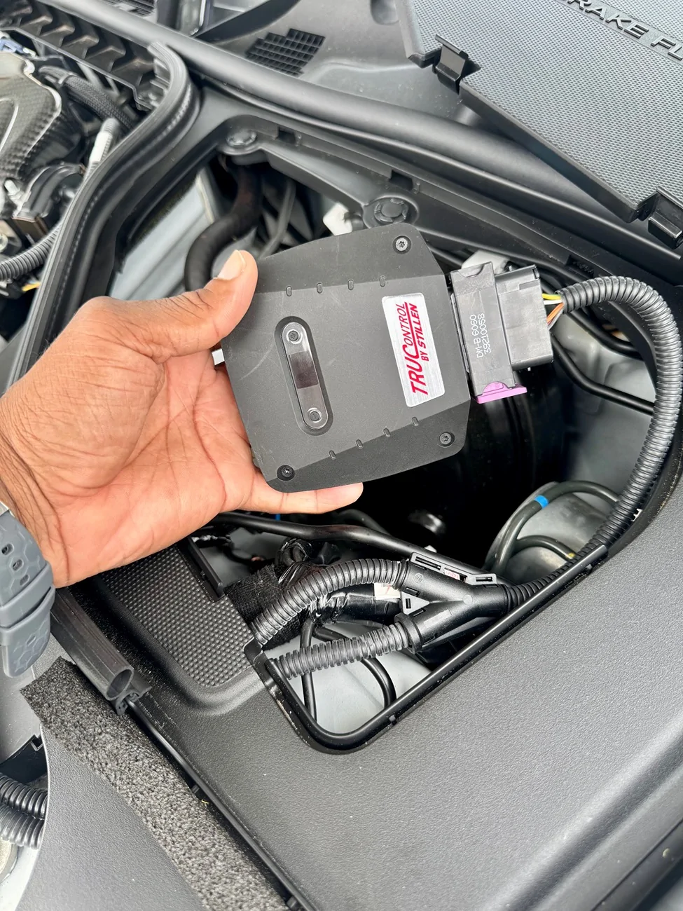

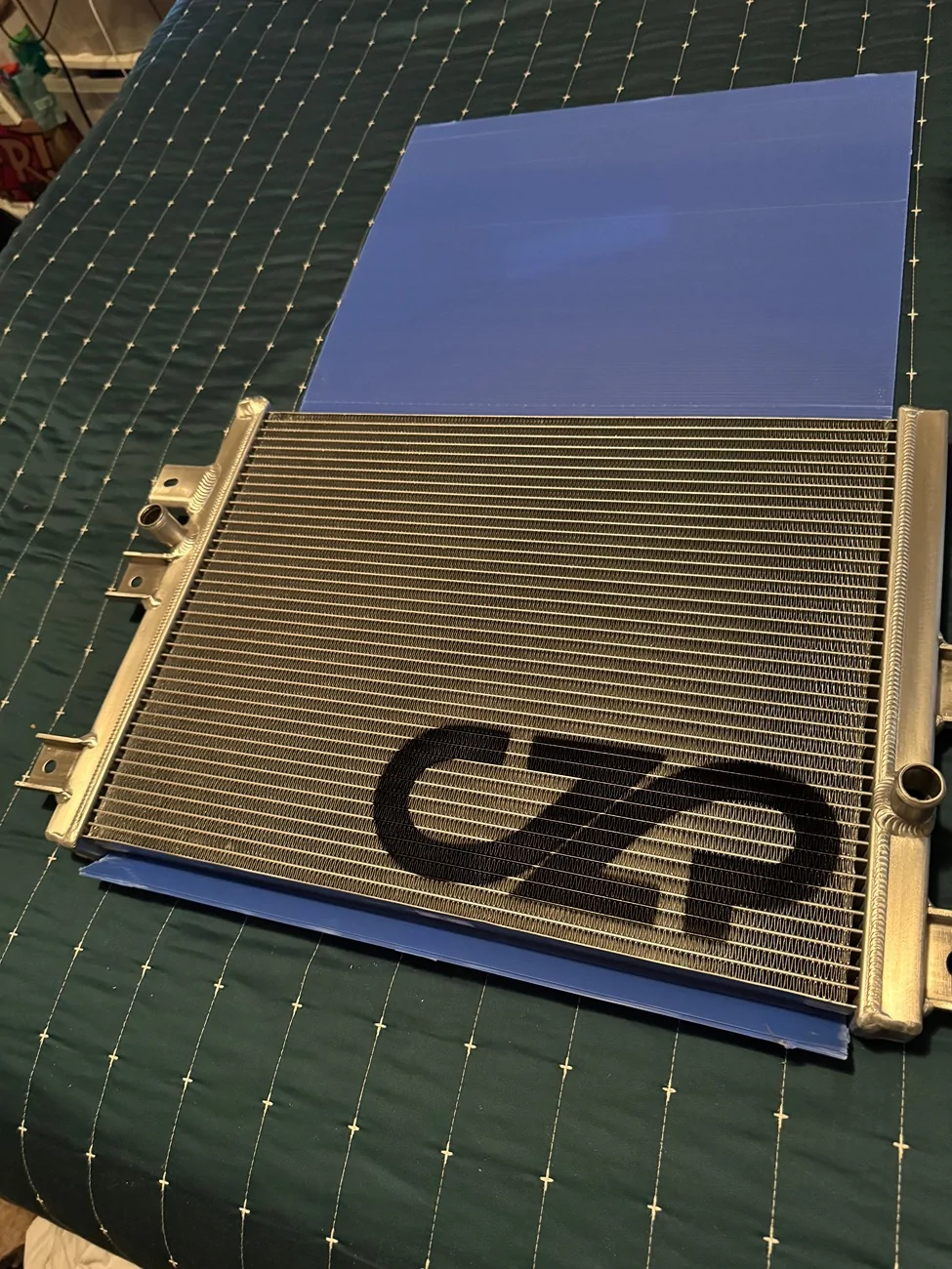

I've been noticing a lot of TruControl and Hotbox owners who complain about issues with the engine performance and health on the FB forums. I think I know why this is happening.
Z1 and Stillen should've explained that in order to get great CONSISTENT performance from these units you NEED to have an upgraded Heat Exchanger!!
There's a reason I don't run Map7 on my car but now that I have the CZP Heat Exchanger I will give it a try. It works amazing with the mid maps(4/5) with the upgraded h/x in very humid 90+ degree F temps in Georgia.
And most of the people complaining of issues are those with the stock h/x during summer time horrific temperatures.
So to those that don't have issues what Map are you using? Do you have a upgraded h/x?

Like I said you've never experienced the issues or maybe you have but it's not a problem for you. It's not turbo lag. The big problem is the heat exchanger on the VR30 is massively underwhelming from the factory, especially in Spring/Summer. Basically what I'm saying is people who are tuned without the h/x upgrade will initially feel that extra power but after that soak sets in from a few pulls they'll be making less power than stock and it has nothing to do with Stillen/Z1 or ecu tuning.
I tried Map 7 before the h/x upgrade I did and initially I felt a difference but after a few pulls my Nismo felt like it lost a sizable amount of horsepower. Now when the temps were cooler(Fall) there was no issues with the Map 7 power outside of the lack of grip thanks to cold tires.

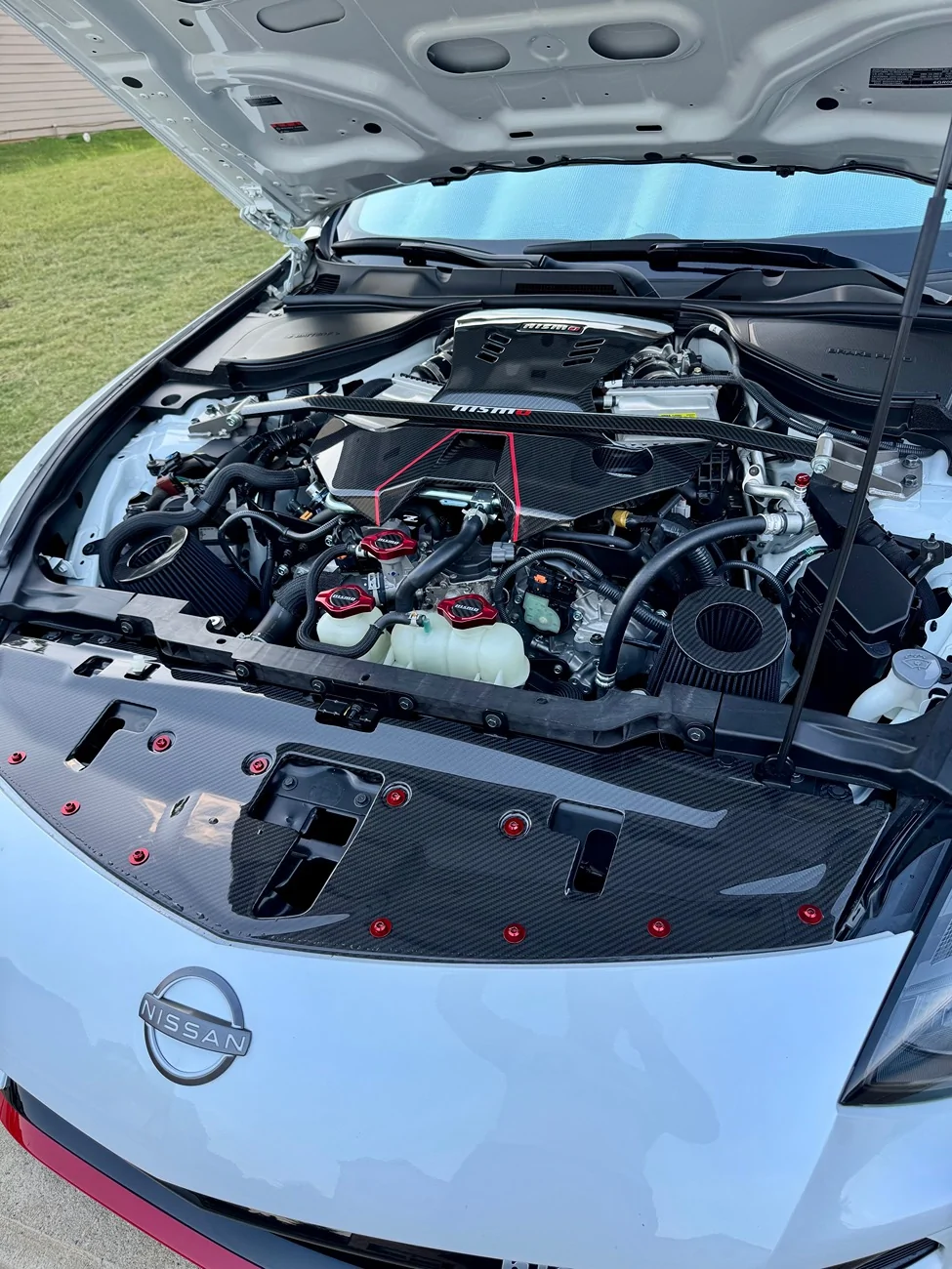

So fellas I decided to do some in depth analysis on the Stillen TruControl unit. I called Jon, the tuner at Z1 and explained to him I that I want my Nismo dynoed with the B6A intake, Stillen Exhaust and CZP heat exchanger for stock-ish dyno purposes, then use the Stillen TruControl on Map 4,5,6,7 to see the gains and how each affects the timing, A/F ratio, Boost level, and everything associated with telling me which map is the most problematic to my engine. So this will be beneficial to the guys who have the exact mods I have. The CZP h/x plus the Nismo extra h/x can easily handle 5 runs on a dyno to show gradual progress.
