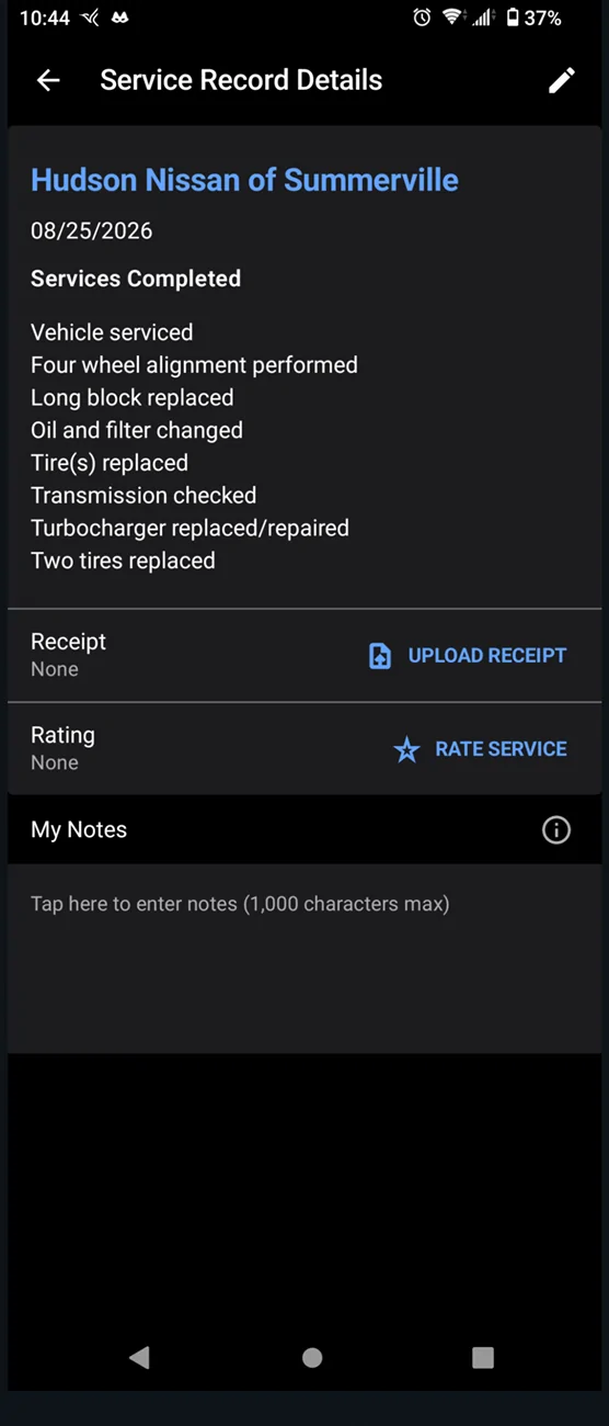

I wouldn't make this up, coming from a older Nissan Z and knowing what detonation sounds like running the tru control is not safe.Maybe for a pull or few but i am telling you from experience running this device on a nismo is not safe,
This is a perfect example. The stock system is at the limit. Place close attention to the boost levels run. which lines up with the trucontrol.
They were running wot boost dyno runs on a controlled enviroment.
I paid for the Trucontrol and it absolutely does add power but it doesnt mean it safe.Rememeber it only taps into your boost controllers on the ecu it has no way of knowing your IAT's or MAP sensors, its just a boost solenoid cheat device. Your not going to realize the damage until it shows up. These engines already have problems with the thin head castings and having premature failures. The longer you run these motors with knock and detonation on over boosted scenarios then you'll end up replacing the long block in a short time. Run a real tune on your motor like ECUtek its not worth the headache.
