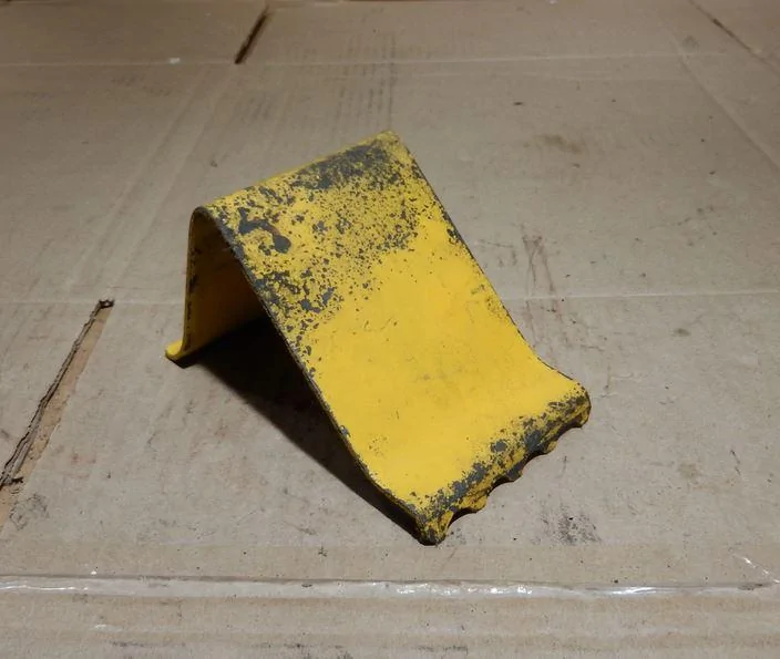

One last point on this topic, the manual states that in changing a tire (by jacking up the car) you need to put wheel chocks on the diagonal wheel of the one you are changing (i.e. if the rear right is to be changed the front left must be chocked). I was just at Harbor Freight and they had heavy duty rubber chocks on sale for $4.99 apiece for club members (list $7.99.) so I picked up a pair. A word to the wise.
I actually had to use the 370Z spare that I added to my new 2023 Z. I just used the chocks from my 240Z... :D
Lots of old Z stuff remains useful!

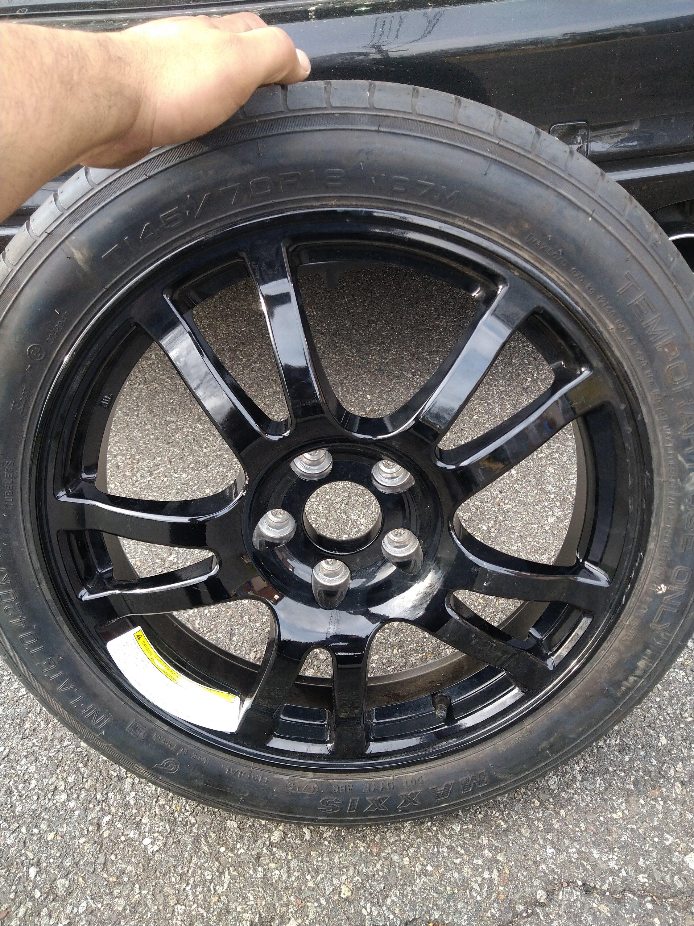

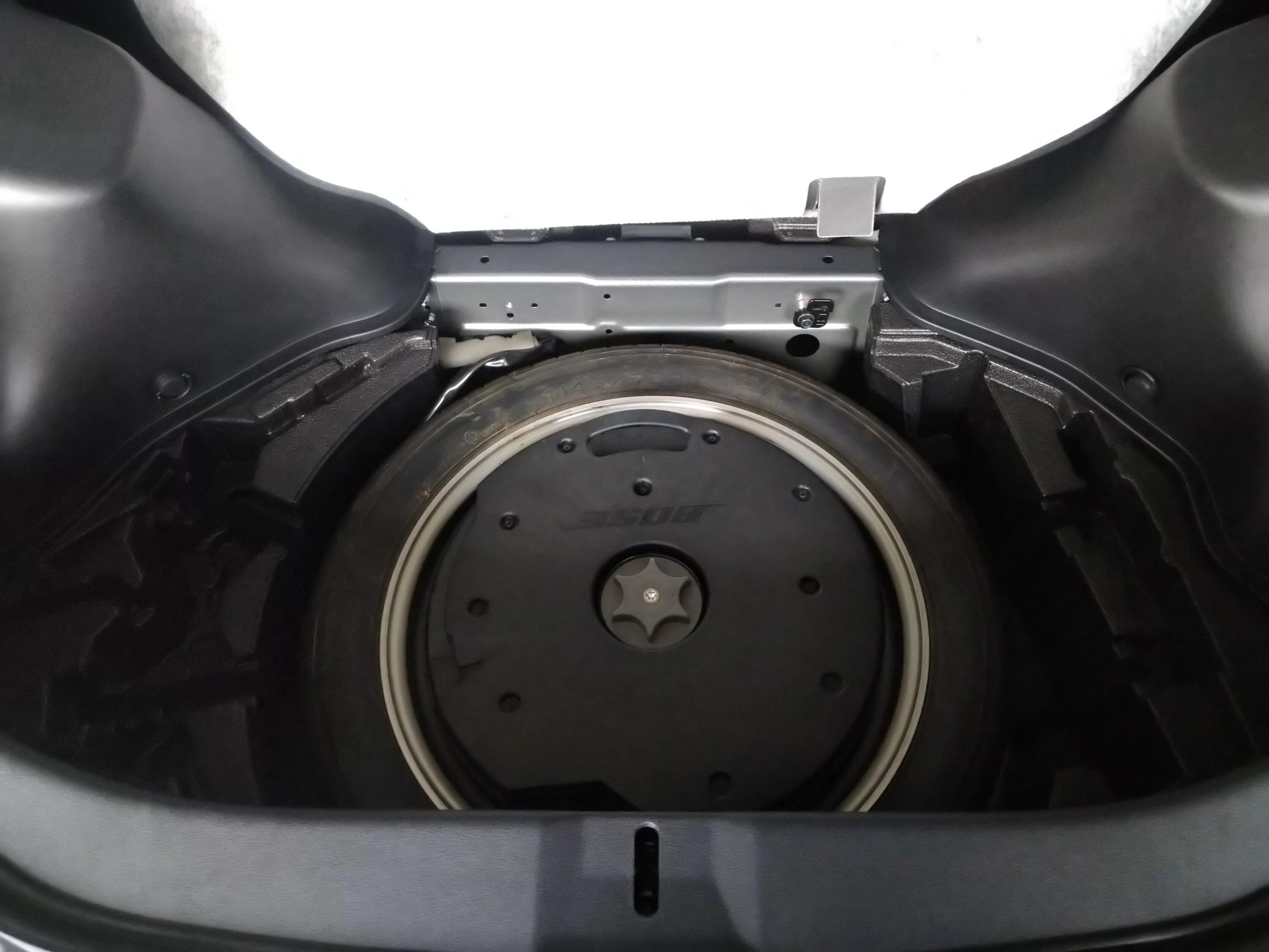

I just did this on a 2023 Performance.
Get yourself a spare wheel from a 2015-2018 Q50 or 370Z Nismo. Make sure it's the 18x4 size. NOT THE 17".
Clears the Akebono's on the Performance.
You'll retain the bose system inside the spare and all your covers and foam will fit just as OE. Pick up a Jack kit from a 370Z or Q also.
Still don't understand why it wasn't there from the factory. Wieght savings or cost cutting?
Where did you find a black one. The dealer found a white one for me I believe from a 370z new. Is the black off an Infiniti. The wheel itself looks the same.

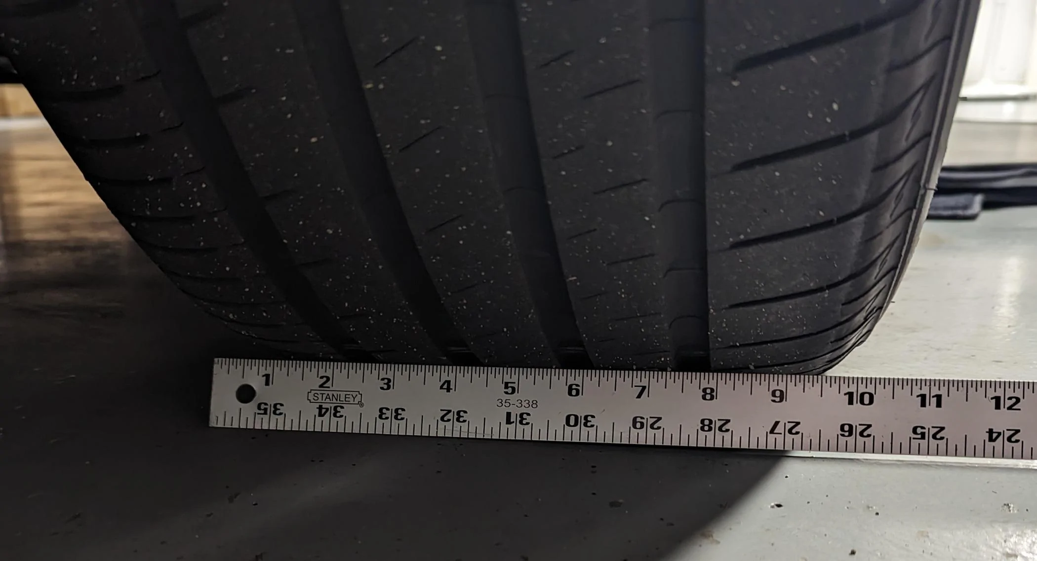

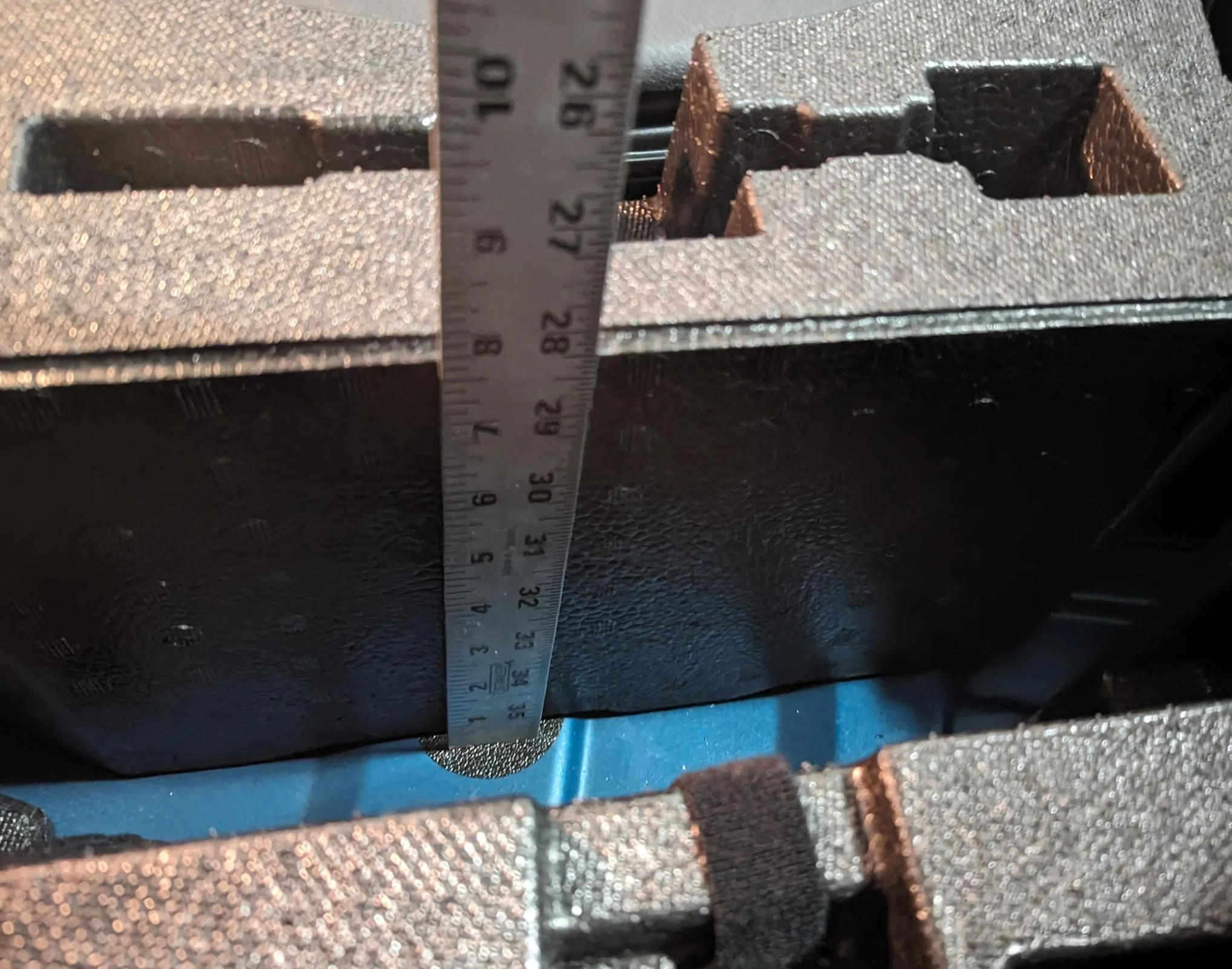

While I was at the dealer getting my bumper recall fixed, I almost pulled the trigger on ordering a spare and a jack. I just couldn't convince myself.
I keep thinking the place where I'd want a spare the most is in a road trip where you're miles from help. But if I'm on a road trip, the hatch is probably full of luggage.
If you put your spare on and then try to put the full-size tire in the well, it's just not going to work. The well is maybe 7.5 inches deep.
And the full-size rear tires is maybe 11 inches wide. It's just not going in there without stealing 4 inches of hatch depth. It might fit, but your luggage won't.
18x4 for the performance? The Z performance has 19 inch wheels. Would that work?

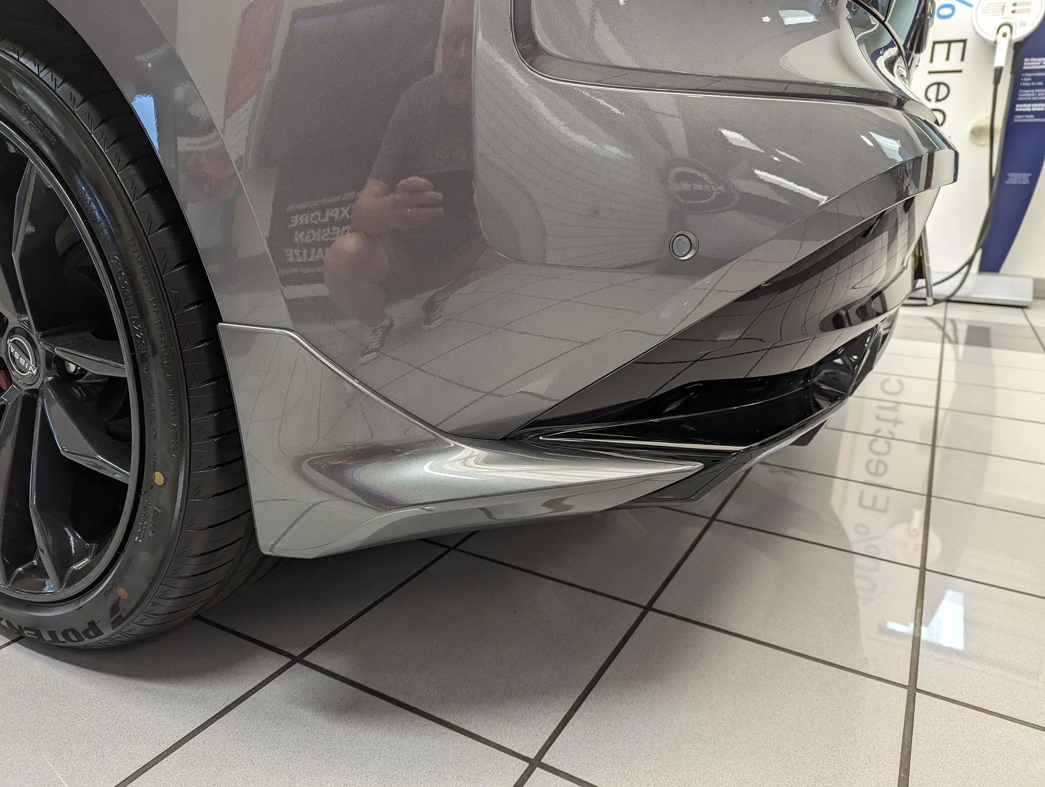

I don't hate the splash guards and I thought about getting some. But for the money I will probably pass.

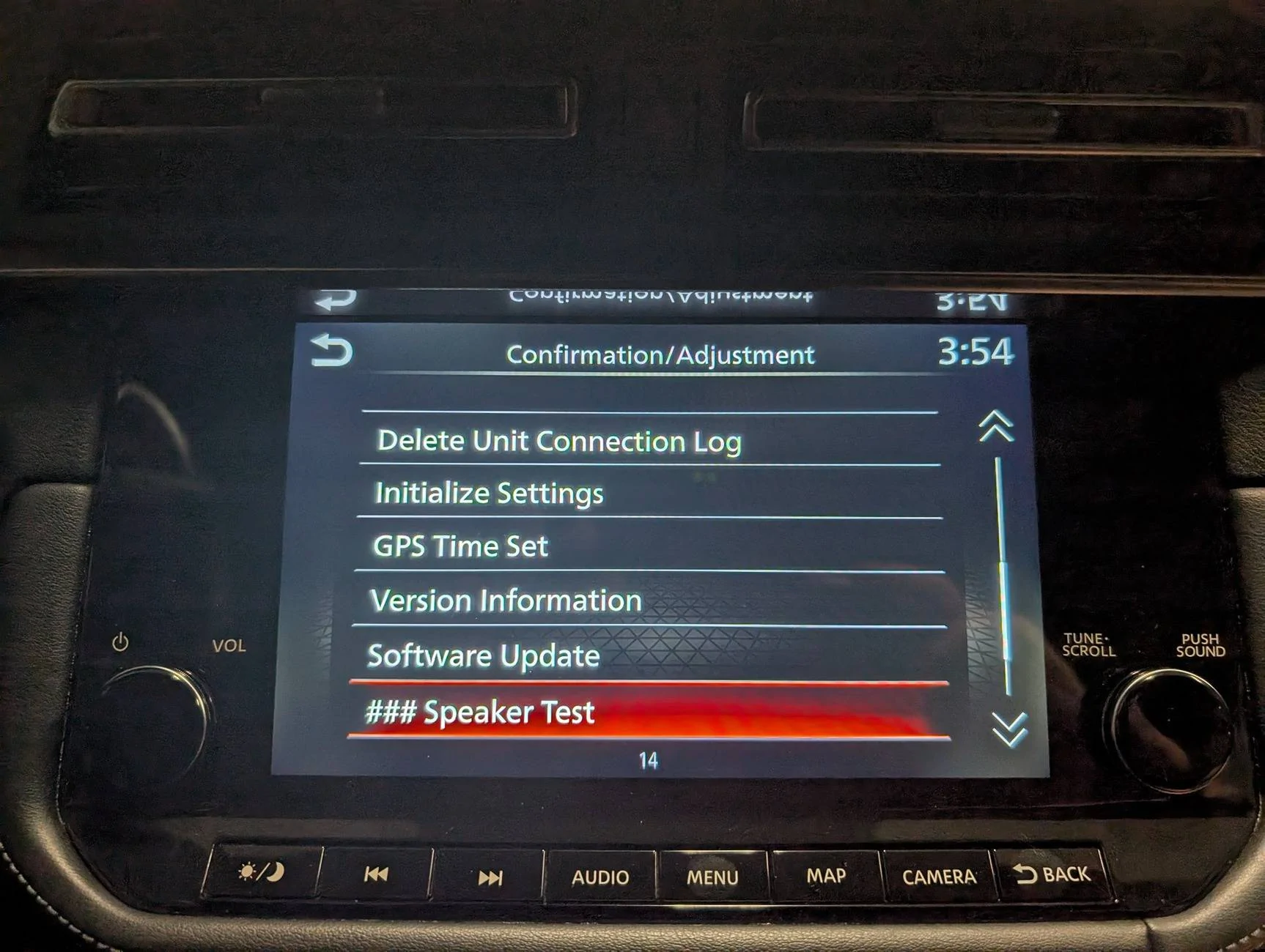

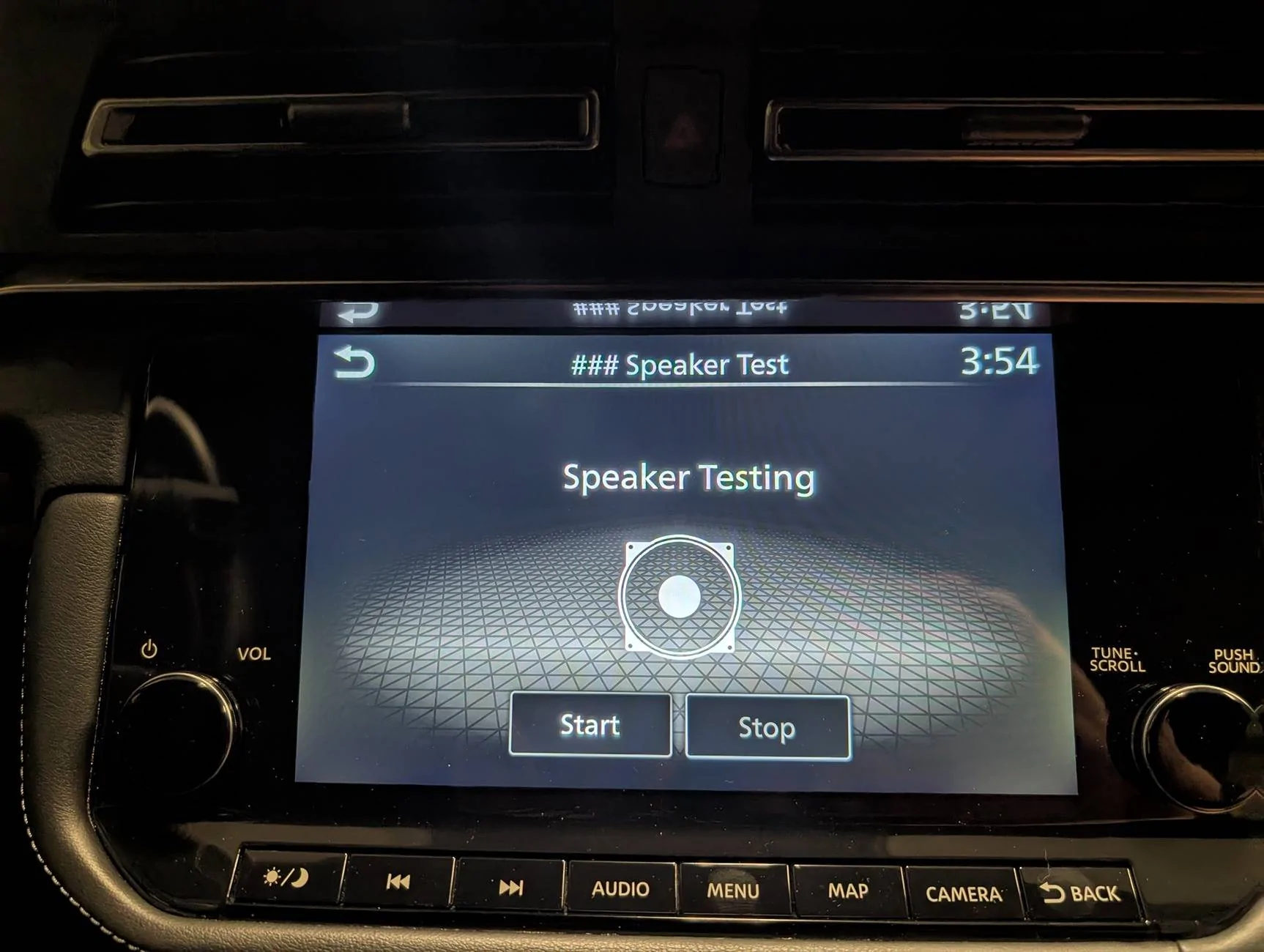

II have the 2023 performance Z and have done all the above. My question is the base speaker now sitting in the tire does not seem to be functional. Is there a way I can test it? My previous Z was the 300zx and the Bose speakers were really good. So far I'm not impressed with the one in the car/tire.
Interesting question.
This thread has a video that shows how to enter the secret menu on our Zs.
Poking around in there, I found a speaker test menu item.
However, there does not seem to be a way to test the sub. ?
