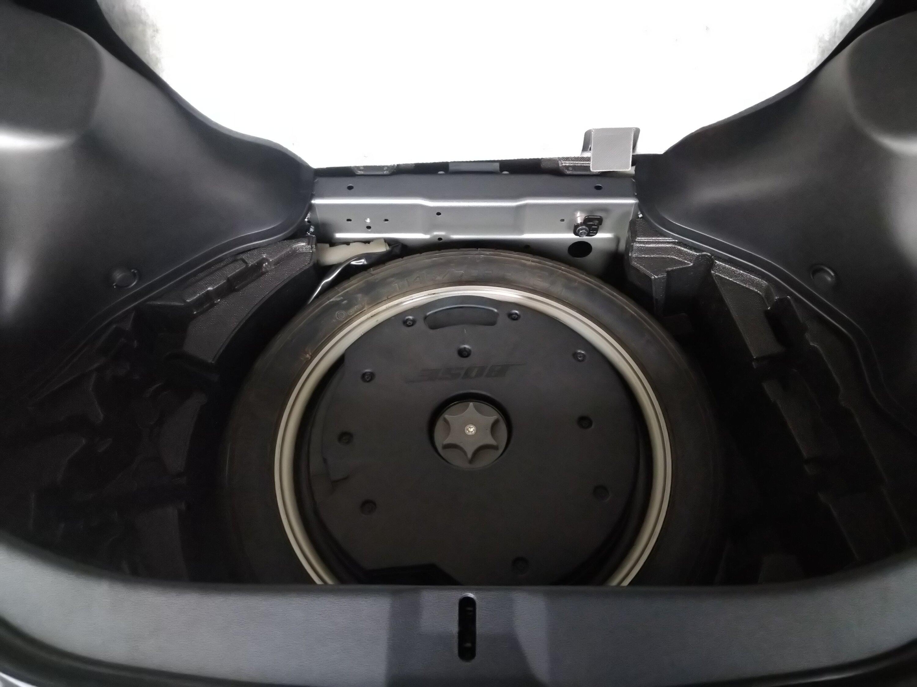

I just did this on a 2023 Performance.
Get yourself a spare wheel from a 2015-2018 Q50 or 370Z Nismo. Make sure it's the 18x4 size. NOT THE 17".
Clears the Akebono's on the Performance.
You'll retain the bose system inside the spare and all your covers and foam will fit just as OE. Pick up a Jack kit from a 370Z or Q also.
Still don't understand why it wasn't there from the factory. Wieght savings or cost cutting?
Thanks very much! Just got my wheel/tire and jack on eBay. Should be here by the weekend or early next week. I'm sure Nissan will tell us it is for weight savings, but I know darn well that it is becasue it's saving them a few bucks on every car sold.
