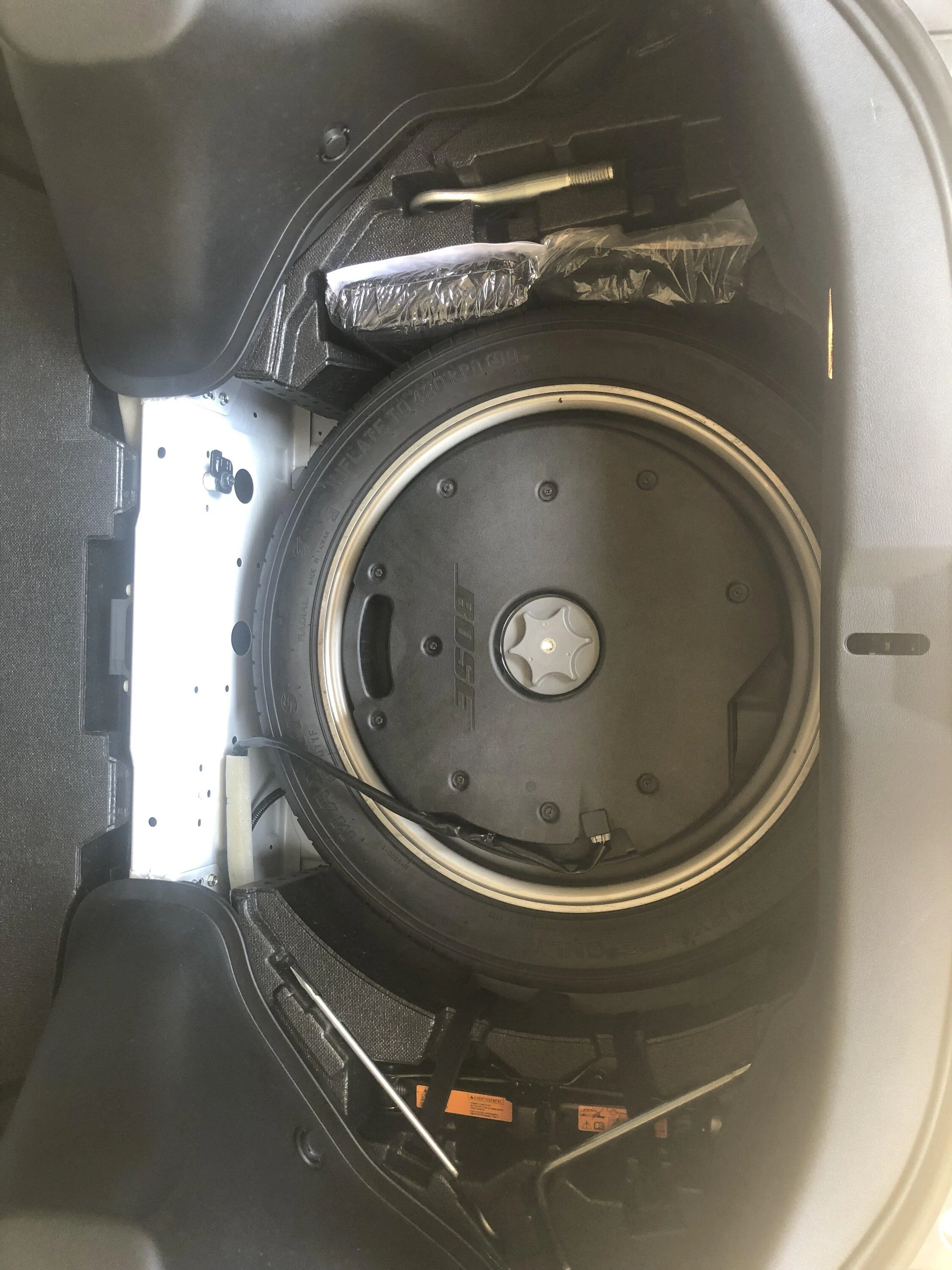

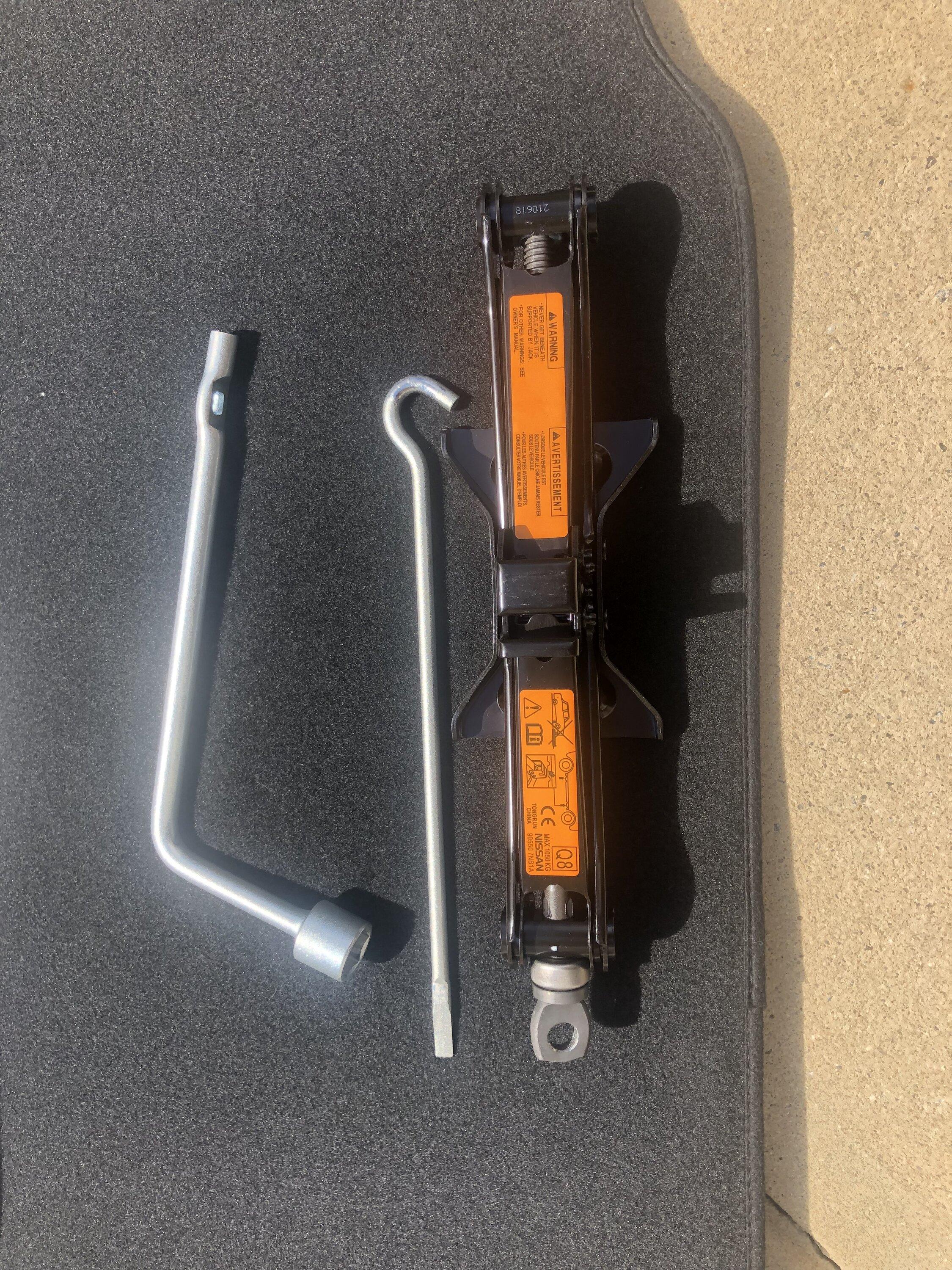

With information from Bucko and others, I put a spare in my Performance a couple of days ago. Got the spare on eBay but couldn't find the jack online. I called my Nissan dealer to see if there is a jack for the 2023 Z. There is so I bought it through them. It came without a lug wrench so I had to order it separately. Jack was $250, rod to turn jack $35 and lug wrench $99. I know this price was way high but I got what I wanted. The spare fit perfectly on the car and in the hatch. The tools and jack have slots in the foam for them. One other bonus is that the bass from the stereo sounds noticeably better. Maybe the tire and wheel resonate better than the foam insert. I'm no longer bummed about poor sound. Thanks to Bucko and others for the information.

I was told to be sure to get the 18” wheel. My spare tire is: T145/70R18 107M. I’m no car mechanic but it was even easy for me. Printed the jacking instructions from the 370Z manual. Said to set the jack between two notches in the frame. Same notches is the new Z.

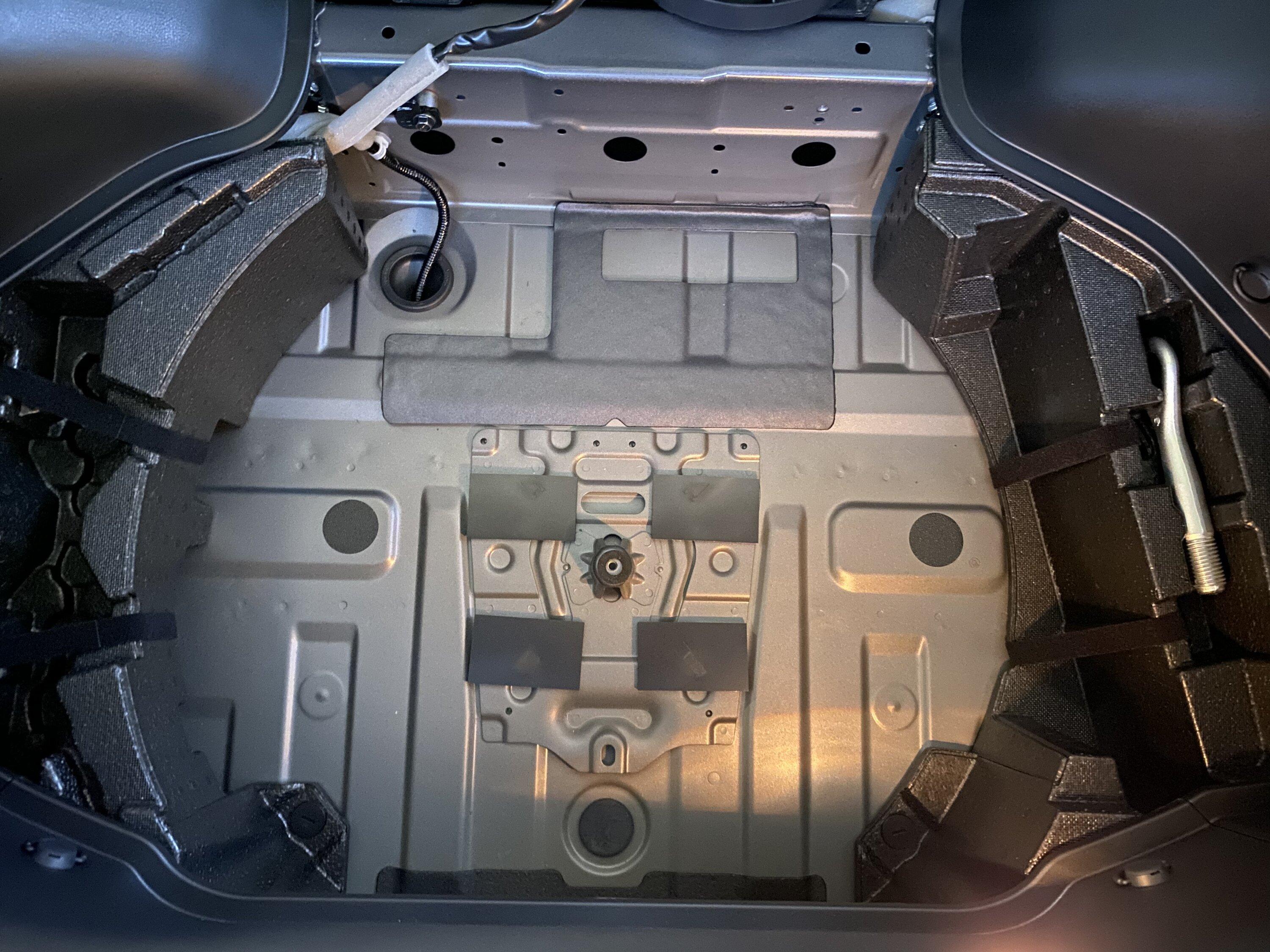

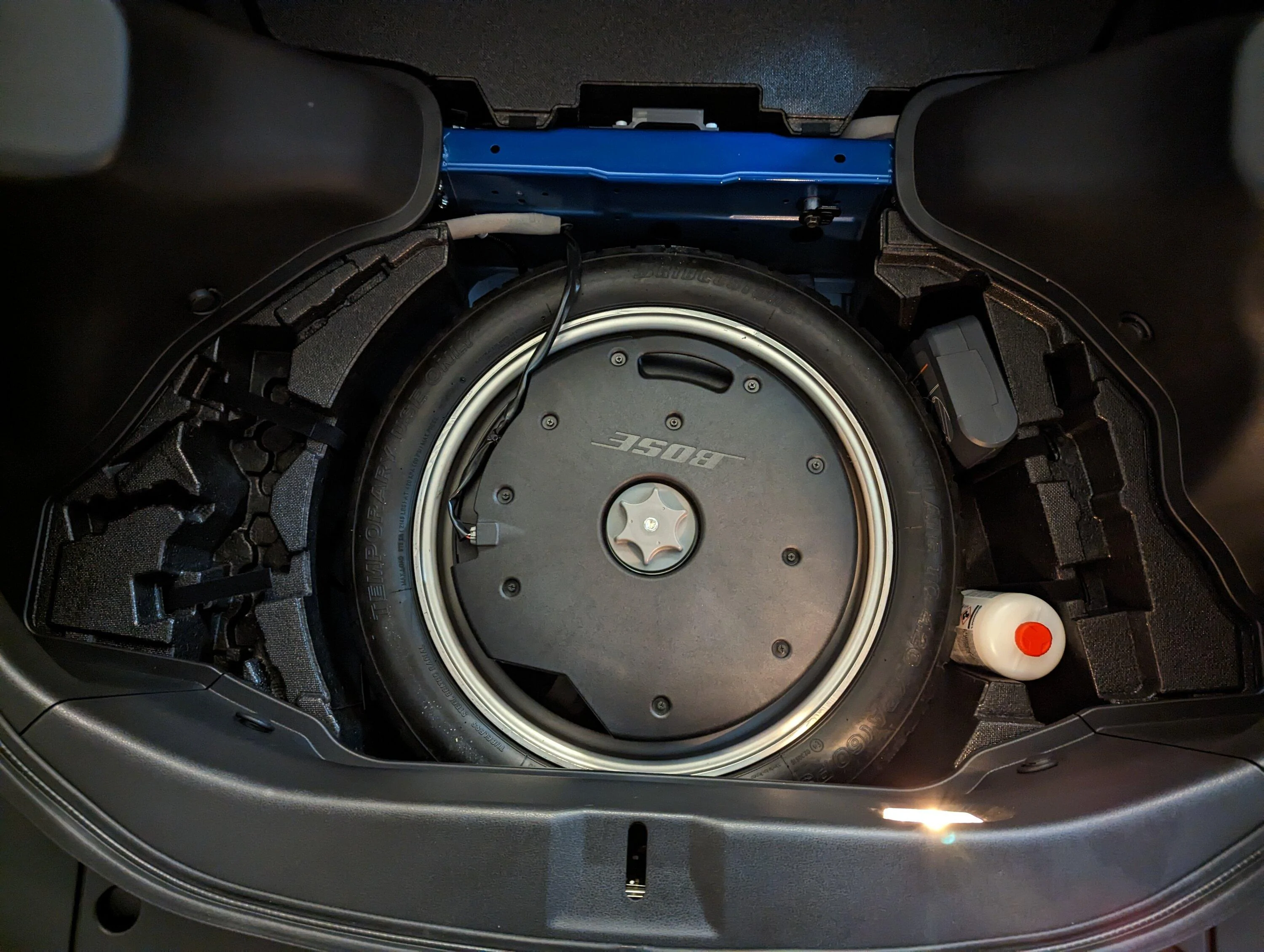

I did this also for our cross country trip in the new Z. (Kansas City to California on US Highway 50). Bought the 370Z spare on ebay and a generic Nissan jack and tool set from Amazon (about $50). I had to remove a little foam to fit the generic jack, but everything fit.
(I'm thinking of moving the air pump and sealant bottle to our 240Z - because the 240Z spare is 50+ years old!...?)
the 370 Spare in our 2023 Z.

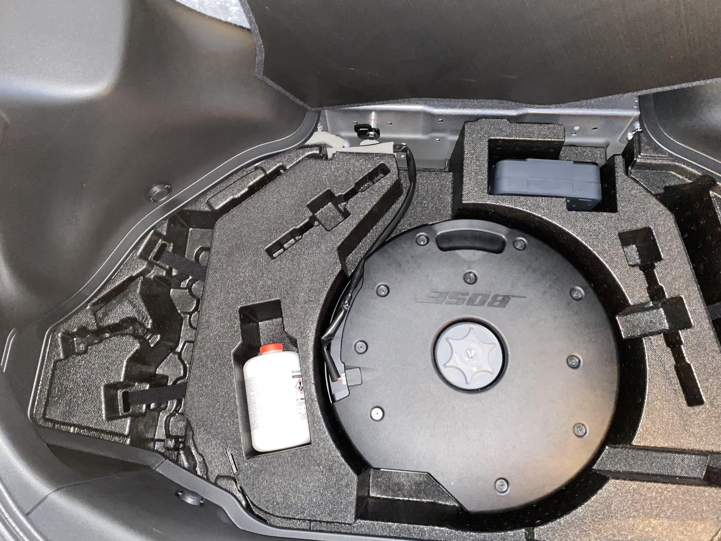

Because that sub was designed for the 370Z and it's spare back in '09

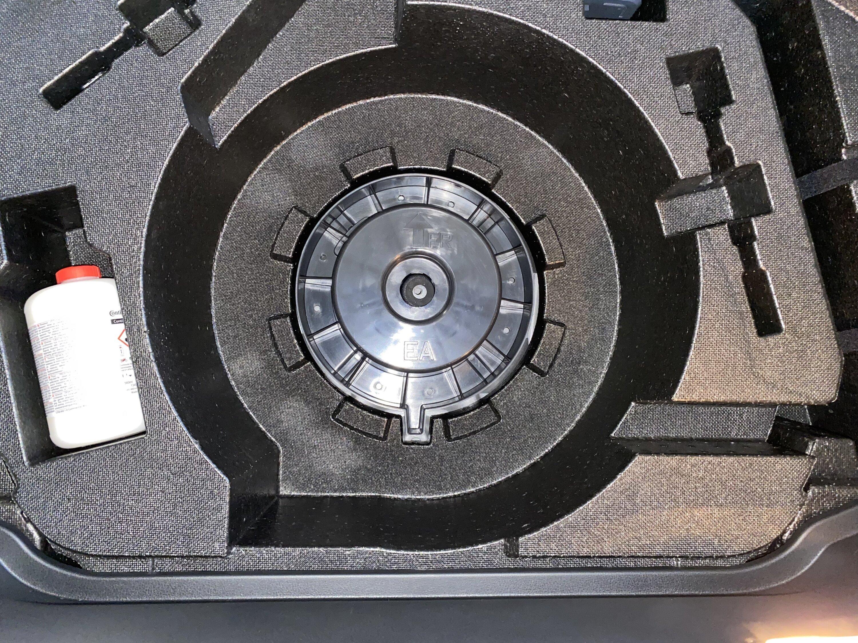

I just received both the 370Z 18" spare and the jack which I then loaded into the rear "spare hole" of the 2023Z. My question is when the Bose speaker was first removed there was a round cylindrical plastic piece about 10" in diameter by about 3" high with the printing FR, EA, and an arrow on one of it's surfaces. .Was that for the speaker's mounting, which the spare tire's hub now replaces"?
Bucko
Bucko
Jim
Feb 27, 2023
58
Nashville
2023 Z Permformance Black Diamond Pearl (Graphite)
Yes, remove the round plastic piece. The spare wheel takes its place.
