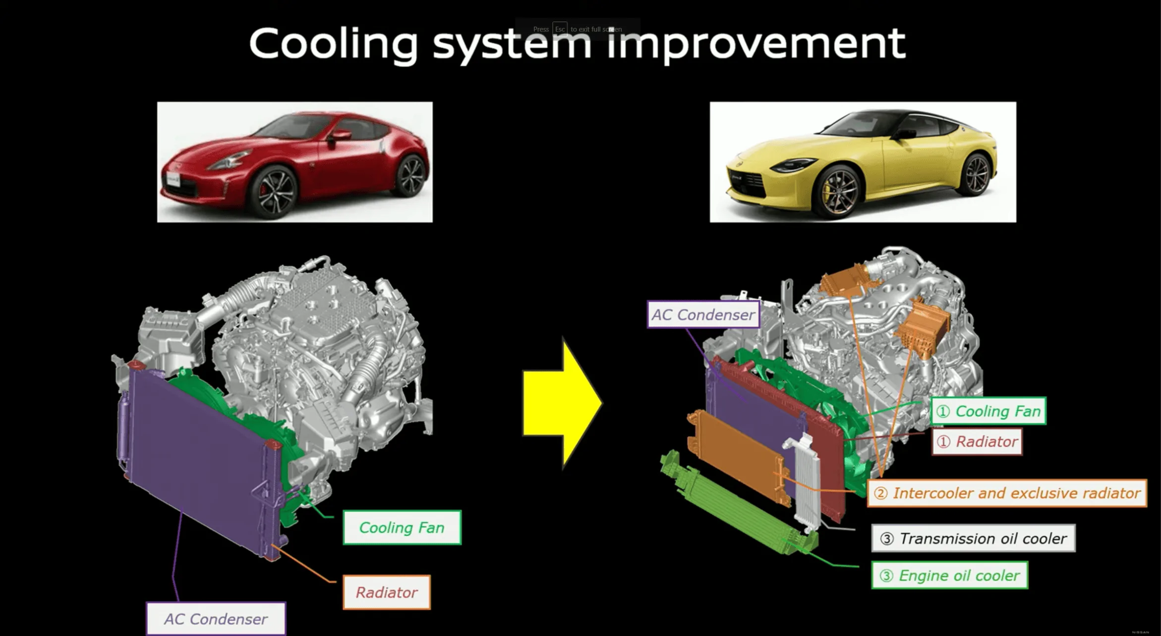

Oil temp seems a tad high. Dude must've just got done tracking it - I hope lol. Then again they are in the LV desert.

370z would get to 230F oil temp in daily driving in summer within shifting around 3-5k. Also due to the tighter engine bay, let's hope the temp on the video was reached after beating on the car.
I think Nismo is aware of the temps, hence the hood vents on their test car. Let's see how it does in Fuji.

Also, the stock heat extractor is pretty small from the diagrams we've seen, and I don't recall seeing a dedicated oil cooler. All items I'd definitely upgrade if tracking a turbo car.

man i hope these temps are from hard running in vegas heat, we had a Z06 that was tracked and would over heat go into limp mode after a few passes we sent it back to chevy a few times to change parts, finally the 4 time in the dealer they gave us the money back
I swear there was conversation on here awhile back about this very topic, and that one of the first thing many of those with VR30DDTT-equipped cars swapped out was the HE. Wouldn't surprise me if this remained the case for the Z.
that plus im sure people might go for aftermarket hoods for sure with vents over the HE
