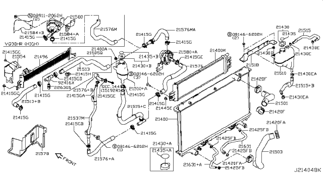

I havent seen anything in the differential but I did find a diagram of the cooling system on the Q60 red sport and it seems the new Z is very beefed up in comparison. (Sorry if it's bad quality but it's all I've found so far)

One of the first mods should absolutely be the heat exchanger (orange highlighted in the front). Easy 50+whp just by changing that alone and tuning. AMS probably has the best heat exchanger for the Q50/60 platform. Of course installing intakes with this would be great too.
Although one thing I do notice is that it looks like the stock heat exchanger they have for the new Z is already bigger than the stock one in the Q50/60s. However, I'm sure aftermarket will still give great gains.

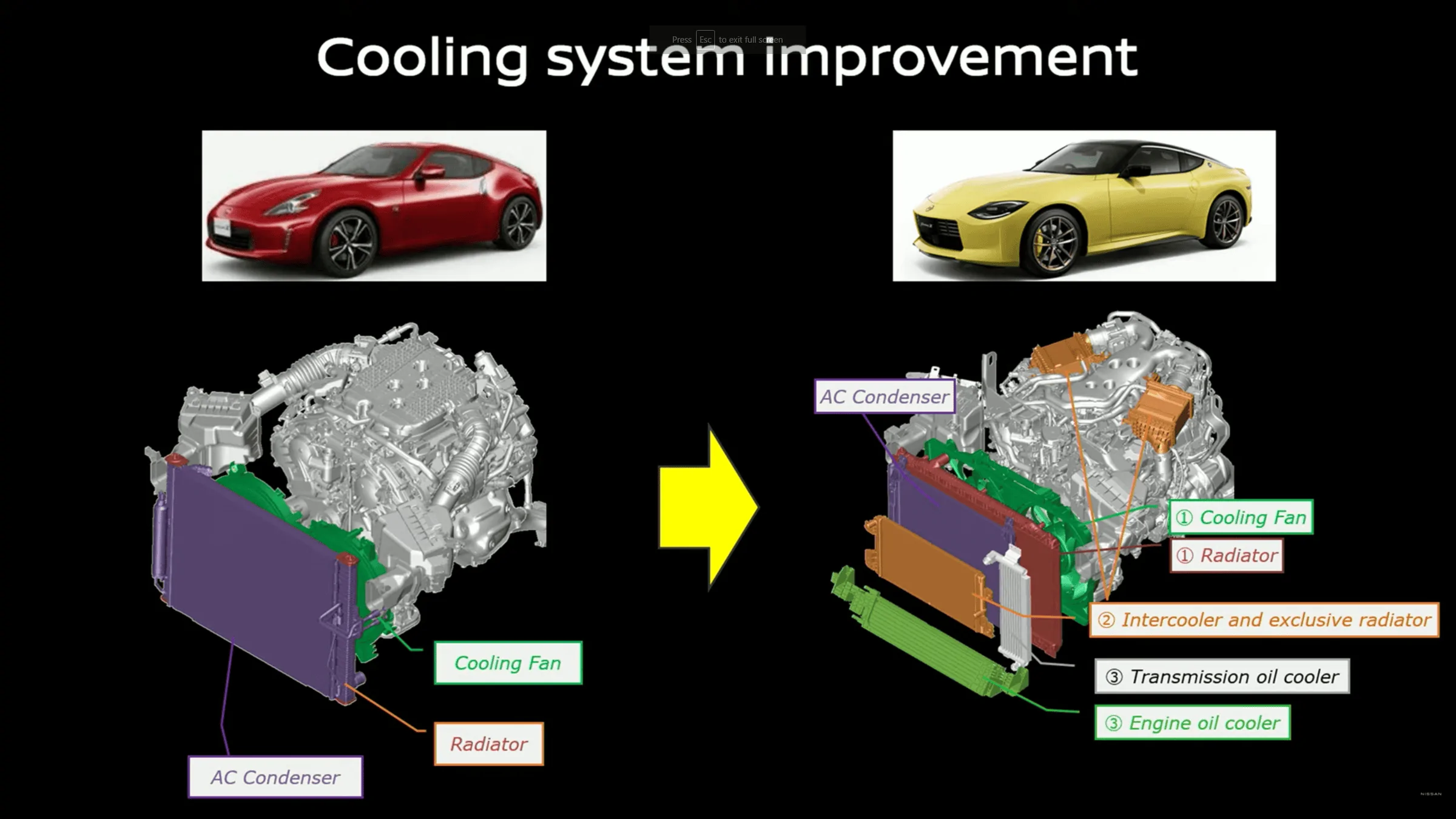

After watching that, it seems they've opted to double the amount of coolers and increase the size of those currently available
Yes and it's great because it means they've listened to feedback from both the 370Z and Q50/60 platforms. Cooling was an issue for both. I think they nipped that in the bud with the new Z. Also, better cooling and air flow likely means that the new Z could very well have higher WHP from factory than the Q Red Sports.

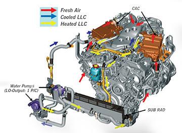

Curious if Nissan also upsized the reservoir tanks for the W2A intercooling.
Bigger aftermarket reservoir on the Infiniti was a huge improvement itself.
