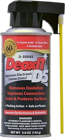

I'm not near my Z at the moment so I can't take a look at the knob control but I had an erratic control issue with the volume knob of a Toyota Avalon. What had apparently occurred was just enough of a very small amount of corrosion had happened, thanks to the typical high humidity in my area. I was able to spray some DeoxIT in back of the knob and that fixed it, never to reoccur. I love that stuff and it's worked for me for a number of electrical issues over the years.
I don't know if the knob on the Z can easily be removed or if there's enough room in back of the knob to spray some contact cleaner but you might take a look. The DeoxIT won't damage anything, such as the surrounding plastic. It's not the cheapest stuff, but a can lasts forever and I always have some on hand.

They use some type of electronics cleaner spray back in QA/testing. I'll see what that is.

Depending on the construction of the head unit, spraying contact cleaner or DeOxit behind the knob may not help. The design of the hardware may be resistant to liquid intrusion.
