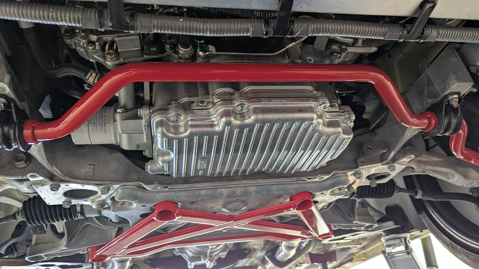

Is that the Dorman aluminum "OE Fix" pan? Or is that one of the ones from CZP or similar?
Dorman - nothing but good things to say about it, and at an attractive price point. Magnetic drain plug, increased capacity, complete drain, new gasket, etc.

Dorman - nothing but good things to say about it. Same benefits as the Z1 & CZP, but at a much more attractive price point. Magnetic drain plug, more capacity, complete drain, new gasket, etc.
And my neighborhood auto parts store stocks it. Thanks for conforming what I suspected - best price and option really...
Last I checked, RockAuto has the best price, but Walmart & Amazon also carry it. Some of the auto part chains mark it up rather heavily.
